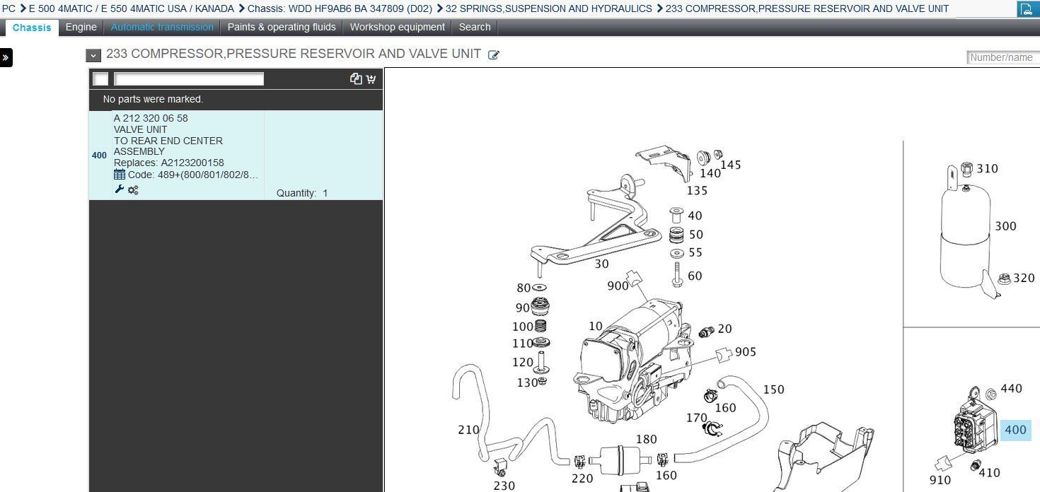

Thanks Konigstiger - this was greats information - I pulled the main pump line - and put foam to it...it leaked if one would call it leaking - I would say it took about 5-7 seconds for a TINY 1/2 bubble to form So im just assuming after 10 hours of that would cause it to drop?
Still leaving me with 2 questions...
First again - if both the rears are dropping and I think the fronts too MAYBE VERY slightly - still leads me to think its the Valve body? because I am assuming the valve body will hold pressure between each of the 4 corner right?
Second - If and when i go to replace the valve body and release all the air - from each corner - I was thinking i could have each corner jacked up during the process and then gently lower the car once all back together which would then also trigger the car to actuate the pump and refill - does that sound right...I read somewhere it said do not while car is on the ground - it will blowup the airbags? Not sure how or why that would be true?
Which leads me to my last question - I see these valve bodies going for a cheap as in $65 to an OEM Merc for about $350ish or more...Anyone use the cheap part - Im mixed - More tempted for the genuine...

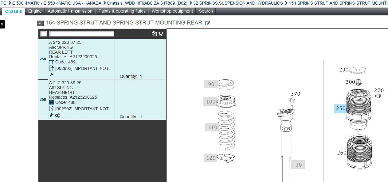

i just replaced both of my springs last week. for me it was the right spring leaking as in once in a while i'd come to the car and right rear corner would be on the floor. if you have both sagging equally most likely its not the springs but a line or valve block.

I have a new Valve Block coming - I just need a couple of extra jacks to raise the car up off all 4 corners...

I found a hair line crack in the top of the airbag so I replaced it with a Arnott air bags - I just ended up doing both sides - I think they were like 100 bucks each so it was a no brainer and not that hard to do both.
