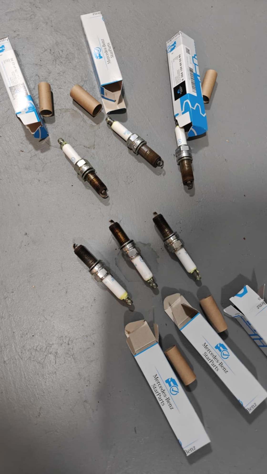

Hi guys,
I'm chasing down an idle vibration which is quite weird. So far I've replaced spark plugs as they were overdue and the engine/trans mount - I got 96 000 miles off them so that's all good, no complaints here.
The idle vibration is almost gone in cold weather - up to 75F or 24C ambient temperature there's little to none vibration. The higher the ambient temperature goes the more the vibration is pronounced. Turning the AC on, definitely elevates the vibration and turning it off almost removes it complete (or removes it completely). I've scanned the car and have no issues, - A/C pressure is ~ 14.5-14.9. I'll be changing the belt, pulleys and tensioner, soon enough as that's due and I need to tackle the dredded M272 oil leaks upfront. The car is a 2011 E350 RWD M272. I have no other stored codes. Any ideas are welcomed.

One of your cylinders is not contributing evenly.
Can you show us the sparkplugs so we can guess which CylNo is using the most oil?
From there youll be swapping coils around.

55 000 miles on the spark plugs. No oil in the spark plug holes or in the coil boots.
I'm a bit confused, wouldn't a misfire be registered as a fault + CEL? I have no other issues other than the slight vibration.
If I drive around with no AC, the I feel nothing.
If the ambient temperature is lower or around 75F I don't feel the vibrations.. how would that be connected to a misfire?
If the car is so sensitive during idle, wouldn't it matter during acceleration, etc?

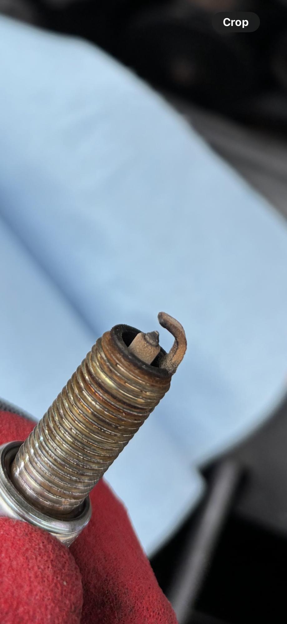

Good article going over the system in ‘m272/m273 engine https://www.fcpeuro.com/blog/inspect...-pcv-breathers
I haven’t actually done anything with the pcv system in a while as I’ll replace the whole system when I replace the intake manifold ( the common lever arm broken on swirl flap actuator).
last sprigs changed the spark plugs and they all had some deposits after a 100 miles, not sure if that is abnormal for that many miles or if that would be from lean conditions caused by faulty pvc, but I’m guessing it would be

Originally Posted by SAVZ
Thinking same for me, I replaced the tray a couple times, but never the inner pan.
Are these Platinum plugs and not Iridium, right?
The color is perfectly great between dark and clear.
The gap is huge, regardless the igition coils were powering sparks properly.
What about the same picture for all other cylinders with numbers ??
> PCV fails in more than one way:
the diaphragm membrane gets torn up so it no longer seal
the outlet tube gets plug up solid with vaprized oil oil carbon.

2010 GLK350 4matic
yes, platinum, NGK PLKR7A specifically, all 6 plugs look almost similar.
