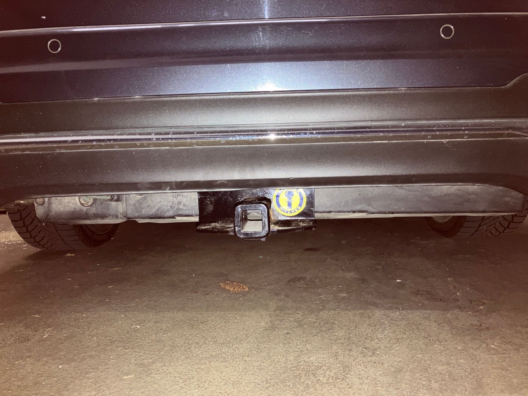

I was on the fence about getting a hitch for the car. Really not a fan of the diaper looking generic U-haul hitches, or just the look of a hitch in general when it’s not in use.
Enter the Stealth Hitch via Stealth Hitch Website. Wasn’t planning on posting about it, so unfortunately don’t have any photos of how it came in the box. As soon as I opened it I was really impressed by the quality and simplicity of the design.
It replaces the rear bumper behind the bumper cover using the existing factory mounting points. If you don’t have the kick wand option for the trunk then there’s no trimming required, in my case there was but it’s fairly straightforward because the instructions are really well documented. You essentially get photos of each step which eliminates the need to decode verbal instructions. A hard copy came in the box, with PDF’s available online. One lesson I learned the hard way was to make sure I had all of the necessary tools PRIOR to beginning taking the car apart( a 10mm hollow shafted nut driver and working torque wrench really slowed me down) but all of the tools required are depicted in the instructions.
I would say the most difficult part of the whole process is getting the courage to separate(pry) the bumper cover off and away from the body of the car. If you got anxiety reading that, bring it to a body shop. They will have all of the tools and hopefully not charge a small fortune for a job that(with trimming) shouldn’t take more than about 2.5 hours.
Before taking the plunge…
No additional “during” photos, but here are some after with it installed:
The hitch mounts into a heavy duty metal block, which has a lock and key, with a spring-tensioned lever that makes attachment super easy. And when it’s not in used there’s a rubber cover that keeps the elements out of the hollow attachment point. There’s also a cover for the lock to keep it from getting all gross from the road.
The receiver itself at first looked like something that belongs on an f-150, but once installed it mated with my Thule bike rack with ease. They have both 1.25” and 2” receivers available, I went with the latter:
Here are some photos with the rack installed. You can see in the first photo that the height or drop of the receiver is a rather precise fitment to the rear diffuser:
And finally just a few pictures of the car:
If you’re on the fence about getting one of these, don’t be. Worth triple their weight in steel. And entirely more affordable than getting into an Estate/SUV. And beats hearing your pano-roof creaking and popping from the stress of a roof rack.

Good job, it looks better than roof rails as well . Not to mention ,it's a cool name too

phew, it looks close to the ground... I'd probably be taking big divots out of my driveway every time I enter or leave my house.

I would reach out directly to Stealth Hitch customer service. I’ve found them to be very responsive. I don’t believe the Adblue tank will interfere with the installation unless the rear bumper mounting points are different, which I highly doubt. I do have the AMG styling package, and the car is lowered on KW coilovers - I have no clearance issues. I don’t have the tow package installed(trailer light wiring) but I don’t see the wiring kit being significantly different to others on the market which would prevent it from being compatible/recognized by MB software. I’m certain they will be able to confirm any outstanding questions that you might have.
