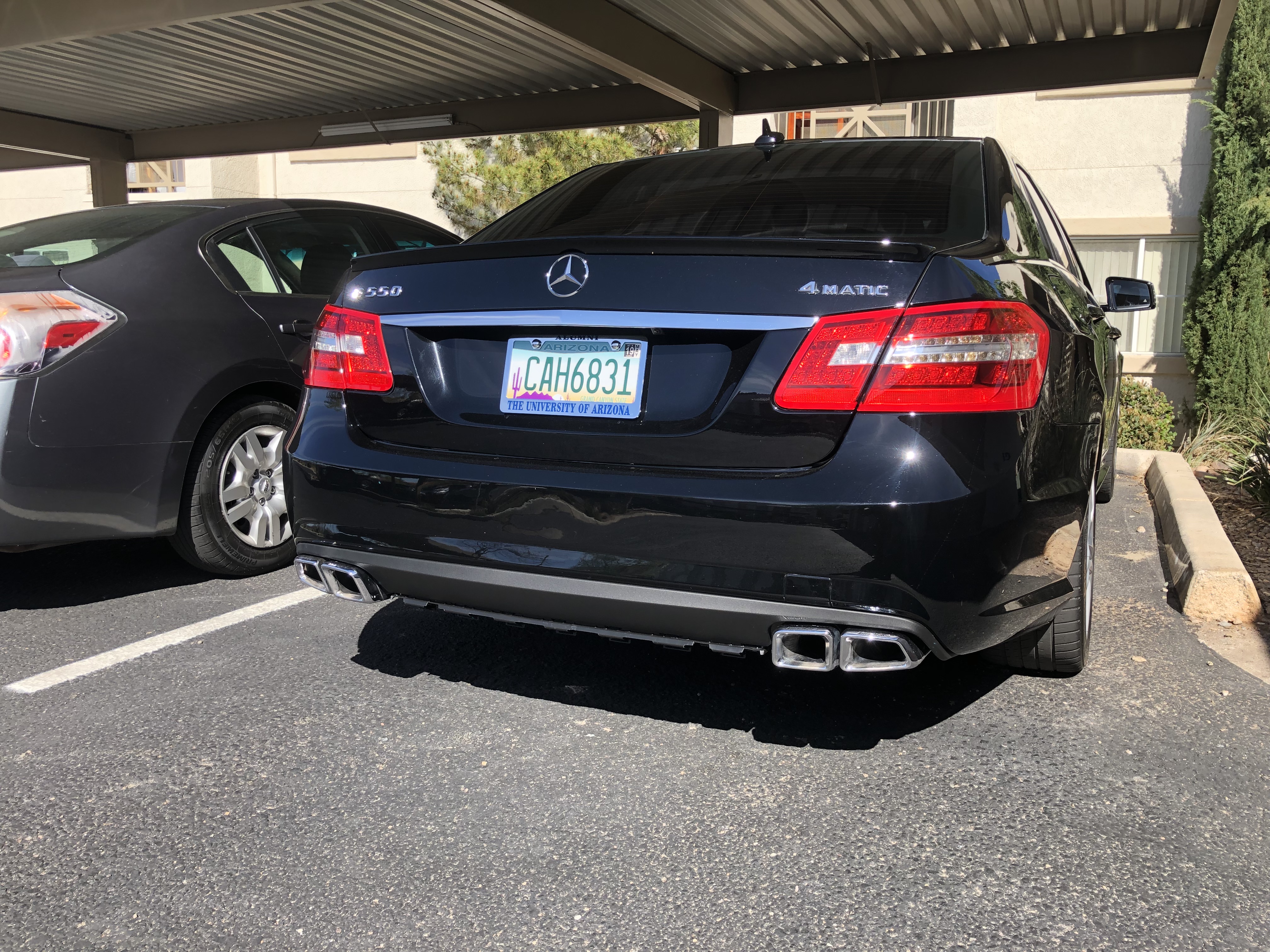

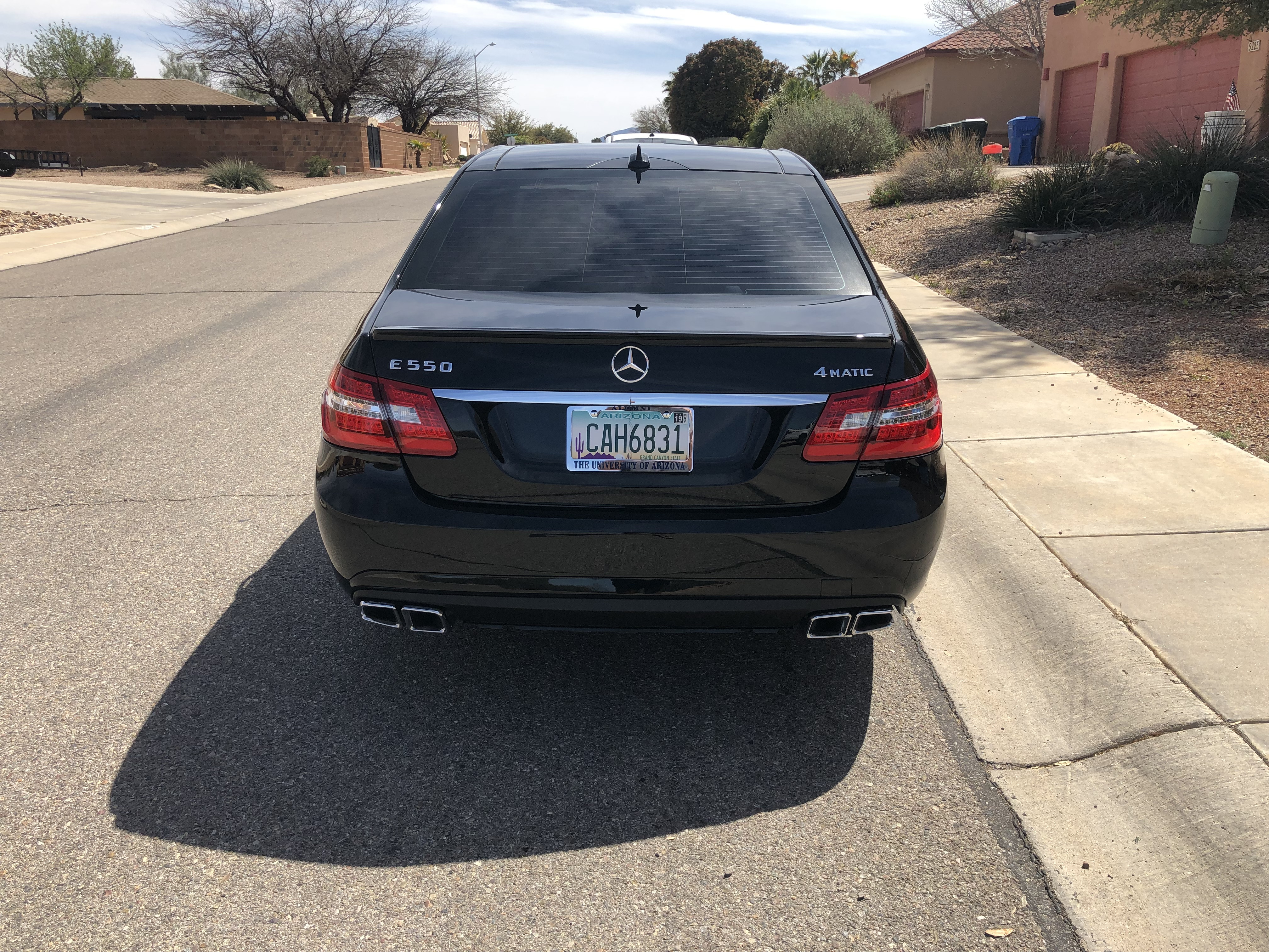

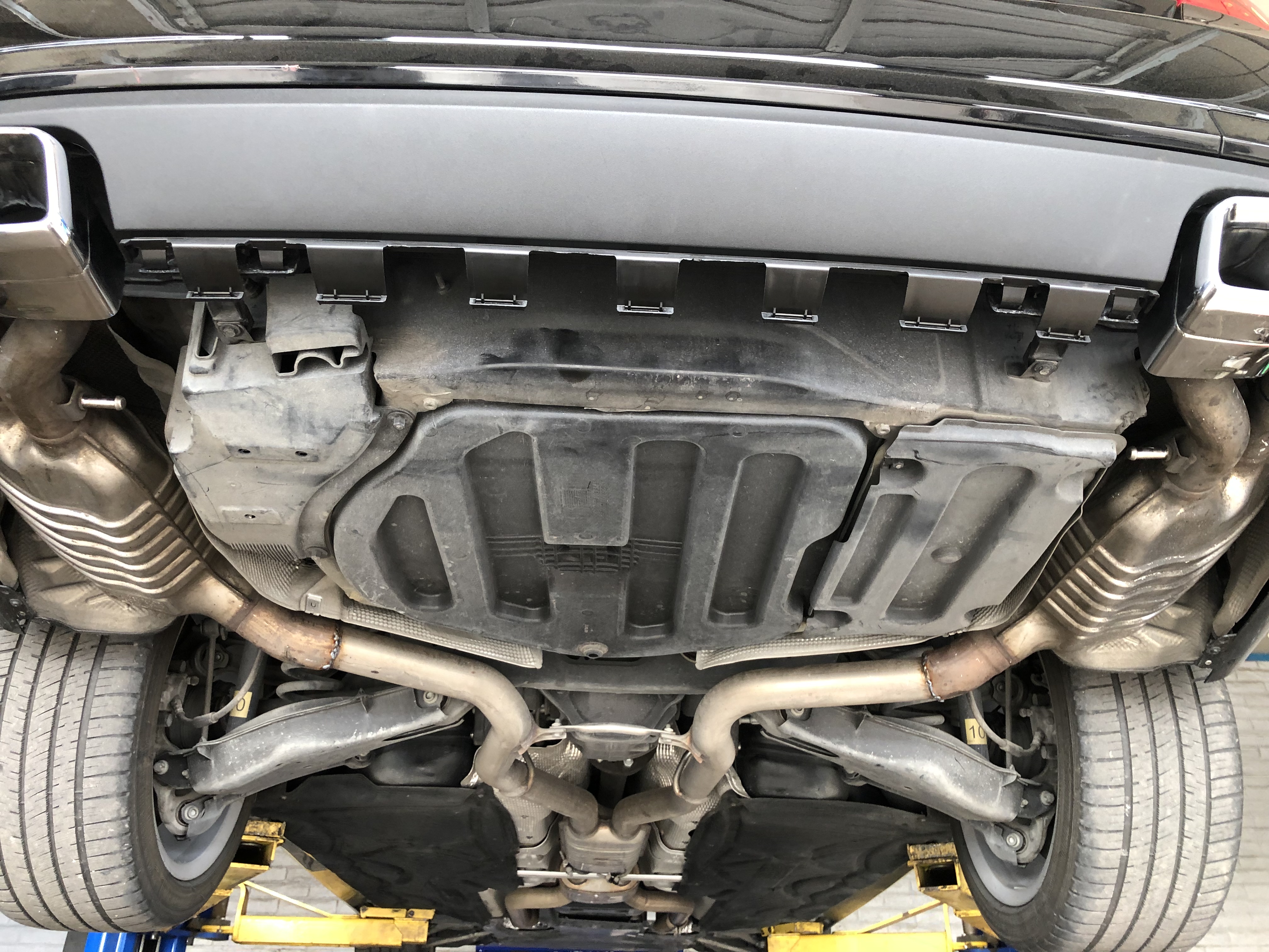

W218 CLS 63 AMG mufflers fit on preface-lift W212 sedans!
Admittedly, the welds could be better, but I love the look. Totally worth it. All that’s left is the lower trim piece.

Looking great, I'm assuming also sounding great?
Thanks! It definitely livens up the sound. The car is still quiet, but when you get on the gas it has a nice deep growl. At some point I may remove the resonator for more sound. For now I am content.
I wouldn't mind more growl at WOT, but I do like it quiet for cruising. So, is there any drone when you're cruising on the highway?

Originally Posted by ghlkal
Nice job.
Thanks!
No drone at all, city or highway. It sounds perfectly quiet. There is a little more turbo noise at WOT and the car is just more audible/throaty at WOT. It’s a very subtle mod honestly in the way of sound. I’m told it’s quite a bit louder from outside the vehicle, but from inside you can barely notice. Mercedes vehicles must have some next level insulation. I thought it was going to be louder.
I am trying to keep the car classy and not sounding like it’s broken. I’m still on the fence about a resonator delete. When I did a muffler delete on my e46, the drone was unbearable. We’ll see.

Used the stock hangers on the mufflers? Or welded new hangers?

Originally Posted by jonUF02
Let's get an audio clip please! I would love a little more sound (outside) too. Most I have seen go for the complete E63 exhaust, which is a little bit much for me, and expensive. Did you buy the complete exhaust, or just the chopped mufflers? Curious if the rest of the pipes and hangers line up from the CLS.
I got to figure out how to do that. I’ve never uploaded a video to YouTube before.
The person I bought my mufflers from said that they came off of an E63. The part number shows that they are for a CLS. My assumption now is that the turboed E63 and CLS possibly share the same mufflers. I cannot confirm this though.
All I swapped over to my car was the AMG mufflers. The rest of the pipes before the mufflers are OEM E550. The outer muffler mounts match 100% they are in the same location. The E550 does not have the center muffler mounts. In pictures 1-3 you can see what I am talking about.
Also the mufflers physically mount up, but the pipe has to be adapted to fit. The AMGs stock pipes a larger than the non-AMG cars.
I used the stock hangers on the ouside of the mufflers. The inner hanger on the muffler is not used. My muffler shop said the single mount could support it just fine.
