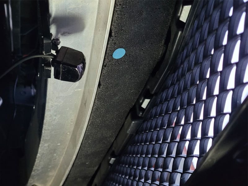

As discussed earlier in this thread, I have ruled out installing the camera as part of the car's standard wiring systems (such as headlights, horn, etc).
I have an aftermarket (non OEM) Illuminated Star. It does not interface with the car's electrical system until the positive lead is installed in a fuse tap at fuse #9. It is lighted all the time, but visible only when dark.
The camera has been added to this same fuse tap. So it will have power anytime the car is on. But I think the camera will only be "on" when I start the app on my smart phone.
The car is on jack stands, the gravel shield removed (and emptied of gravel), and I am checking camera view and possible mounting locations.

So, I was able to park the car deep enough in the garage to avoid most of the rain. I hiked up the front and placed the suspension on jack stands, left and right. This allowed me to remove the TWELVE 8mm bolts holding the splash shield in place. And voila, the area is visible underneath.
After considerable fiddling, I constructed a flat bracket of 1/4" black lexan, and attached the camera to it. The attachment point became the rear vertical surface of the aluminum metal bumper. There's no real room to get a drill in there horizontally, and I couldn't see what I was doing if I did. Soooo, the bracket is held in place with sturdy Gorilla Tape. The pliable plastic in the thick tape should afford some vibration damping, too.
Getting a bracket close enough for the camera to peer through a single facet in the grille isn't possible, because the gray strip you see (with the blue dot) is porous, expanded foam not rigidly held in place (it just flops around), so no chance for accurate camera aiming. So I went with the attachment further back instead. I remind myself that the purpose of this camera is to show the approaching concrete wheel stop as I approach it, so I decided that peering through the larger face of the grill will give a workable view. The camera face is about 4" behind the grillwork, so I should be able to reach through the grates with a VCR cleaning sponge when the camera gets dirty.
The car is still on jack stands until tomorrow (had to quit at dusk), so I don't have any views to show until the car is on level ground.

This camera works a peach for seeing concrete parking blocks and stopping in time. The motion, seen through the grille is more than sufficient to judge when to stop.
Some reviews of this product say that some have problems connecting the WIFI camera to the Smart Phone in a reasonable time. But I had no such issues once I'm on the street or in a parking lot where other WIFI signals aren't present. 5-10 seconds at most and your're viewing ahead.
Pay attention to the motion of the approaching parking stop, and the grates in the grille are not that noticeable.

All good points. But prior to installing the camera, I found myself head-in parking with 2-3 feet of space (sometimes up to 5 feet LOL) in front to avoid obstacles (bumper stops, curbs, sign poles, etc.) This leaves the rear of the car exposed to 25-foot long P/U trucks and SUVs whose drivers are too incompetent to park safely in adjoining parking spots...
Here in "Pick-up-Ville" Texas, cars are a vanishing species, and I have watched with hilarity many a tiny person struggling 5 minutes (or more) to wedge one of these beasts into a standard parking space. So, for me, it's best to pull as far as possible into designated spaces without running into/over obstacles in front. This is where the camera helps as an added self-defense benefit...
Dang. Yeah, I saw/read about this on corvetteforum.
Ouch
ah, that will buff out.
