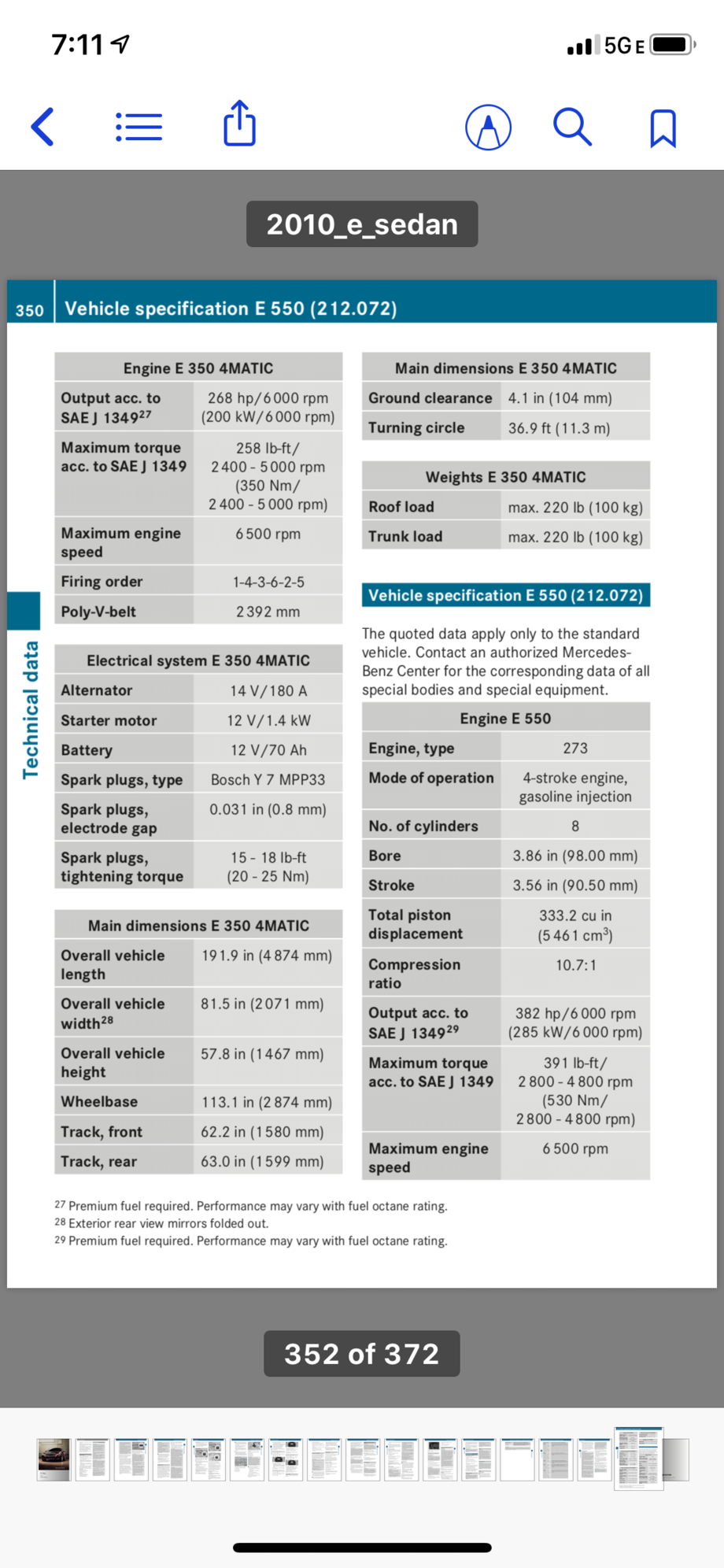

see below from owners manual (albeit it’s from 2010, not 2011, but same engine).

OEM part # 004159180326 (Bosch).
