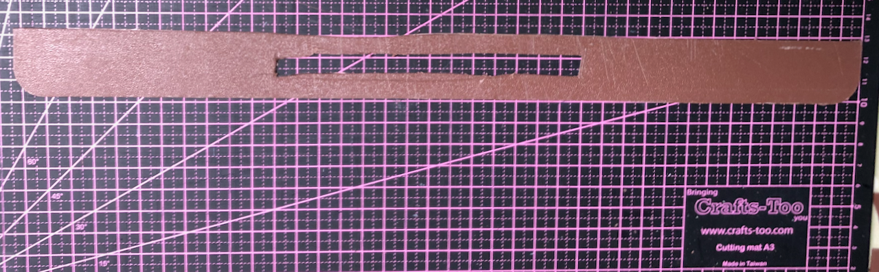

So I managed to get my door open, need to fix the outside handle next.
So like the op, rear left door outside handle not working and child lock on so couldn't open from inside.
I tried cable ties (found metal ones too) but too bendy width wise, and the welding core but couldn't get that through between the door and sill as too tight.
What eventually worked an old chopping mat that is ~ 2 mm thick, cut that ~ an inch wide and cut a rectangle hole in the middle ~14cm long and pass that through between the door and sill just under the lock which is just above the armrest from inside to the outside. Then Mrs & I pulled the improvised tool up towards the lock, you should be able to hear the child lock latch flick as the mat passes over, you can't pass the mat past the lock so the only way is down & that switch gets captured in that hole in the mat and will flick down.
Has taken me 2 days to get it open, I was about to resort to cutting the lock from outside if this last attempt had failed. I had been trying a different piece of mat shaped at 1 end to try and push the latch as it passed & also shaped with a 2cm hole & I could hear the switch as the mat passed but the force needed to move the switch was too much and I guess the mat was eventually just passing over the switch.
I hope this helps the next person.
in my case fixing the lock took less than 10 minutes.
I followed what was in this video
on the rear door you need a long T20 screwdriver to reach the screw where the handle is.
https://amzn.eu/d/0aGA0e3
it may take a little while of probing with screwdriver until you find it.
once unscrewed the lock shroud will become loose.
pulling the handle you will notice a hooked thing behind it, using a hooked tool pull that hook towards the handle and push the handle so its hook goes behind the other hook (you'll know what I mean).
now close the door and test the handle, it should work.
Job done, reassemble the handle shroud and done.
Merc wanted £110 just to diagnose the fault, then no doubt it would be a new actuator etc etc, I estimated they'd charge £800 all in including 2 workshop hours & VAT.
