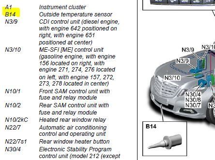

konigstiger's Avatar
Posts: 15,901
Likes: 4,630
From: North Scottsdale, AZ
'71 Pinto
Part # 0075421318 check lower center grille.
File Type: pdf

I took it to a trusted local shop and they scanned it (as expected) with a faulty ambient temperature sensor. They replaced the sensor (one hour labor and $70 for the OEM part, they wouldn't use the $20 aftermarket one). Immediately, the outside temperature began to show again and the CEL went off. But the a/c didn't work.
Knowing the computer may need a few cycles, I took the car home and drove it around. This morning, I drove it to an appointment and the a/c started working about halfway there. Knock on wood, it has been working consistently since.
Total cost around $250 (this is almost exactly half what the dealer would have charged). Could I have done it myself for cheaper? Sure. But, the time it would have taken me to try to fix it without a lift and in a neighborhood where the HOA doesn't allow working on cars in the driveway would have been more valuable than what I paid for diagnostics and labor, so I consider it a good deal.
Bottom line: Replaced ambient temperature and all the symptoms resolved, but the a/c needed about 15 hours to recognize the new sensor and start working again.
