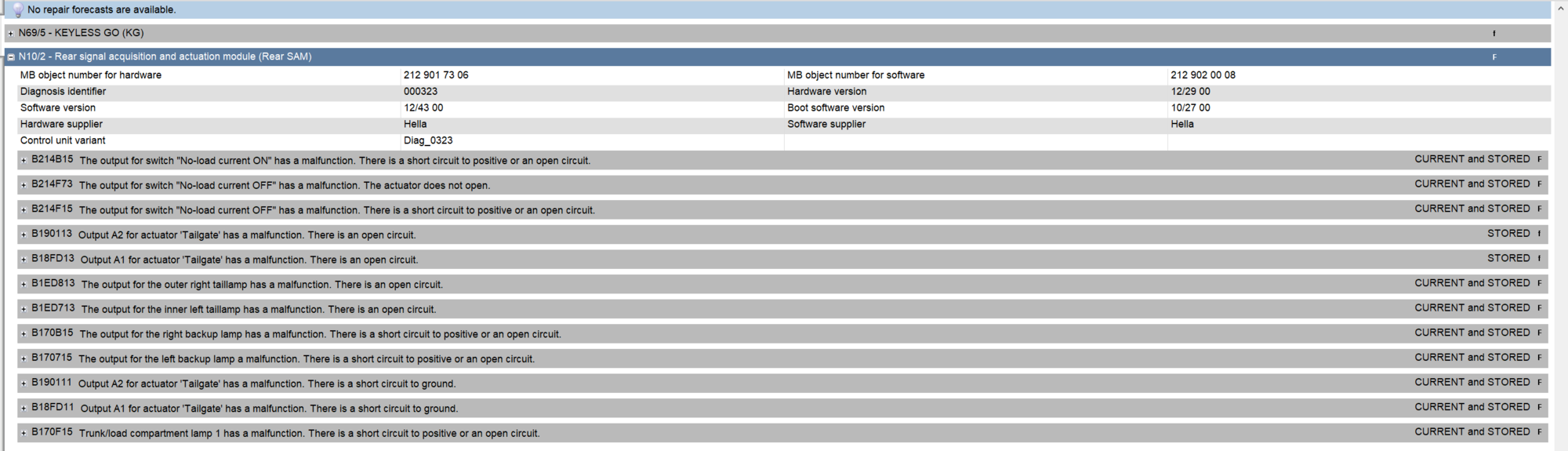

I have access to Xentry and pulled the codes. This is what was found:
The rear SAM controls many many things and it appear that it didn't fail wholesale, but just things relating to the liftgate. What do you all think?

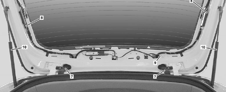

Assuming you checked rear SAM connections for obvious, have you considered checking harness (7 in illustration, access instructions in attachment) and tailgate wiring.

Thanks, konigstiger. I did a pretty elemental test by checking for continuity between the right backup lamp (which is in the inner tail lamp unit) and the rear SAM, to see if this is a wiring issue (pin 3 on the tail lamp connector and pin 4 on the SAM's 6HD connector)--there is continuity. So given that both tail lights stopped working at the same time and a host of other codes that trace back to the rear SAM, it looks like the I have a failed rear SAM unit. From eBay I've sourced another rear SAM that should get here in a week. So once that's installed and coded to the car, hopefully that will do it.

So for posterity, it was indeed the rear SAM (or rather the module that plugs into the back of the fuse holder). No indications of moisture in the compartment. Failure at 55k miles.
