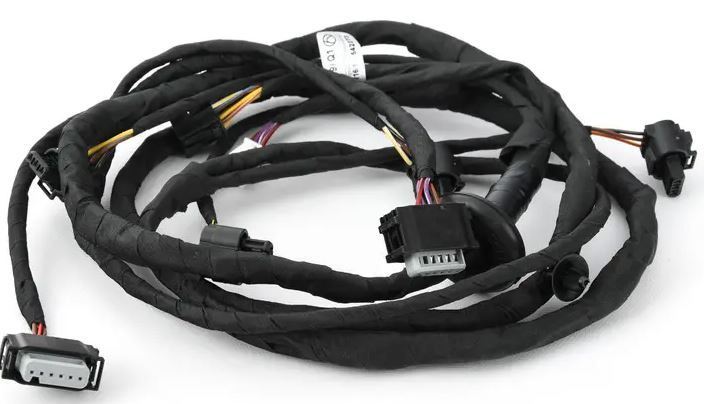

Similar issue, '11 E550 blind spot inop, the driver's side rear radar sensor totally corroded, swelled open and the harness pins corroded as well. @konigstiger I did some preliminary searching in WIS on the diagrams and EPC for PN of harness (212-540-59-10 blindspot + parking). I can't find the harness connectors (radar unit) separate, can you confirm?
Looking at the existing connecter, the wires entering are molded-in.... not your typical rear-entry with a silicon seal. That may be why is not available and if it was, it'd need to include a pigtail.
If just the connector could be replaced (radar sensor as well) that be good. Given the corrosion and age, there's risk disconnecting the other working sensors and causing more damage.
Correct, MB does not offer connector separately.
Thanks, and just to add for future reference how about the other connectors on the harness?

I should say MB does not identify connectors in EPC. 10 character part # may be stamped on connector, find cost effective sacrifical harness, Google “Mercedes connector” that may produce matching image or replace harness and environmentally protect the connectors/sensors. I.e: not cost effective but they're available https://connectorexperts.com/i-25537...nsor-rear.html

I received a new harness and used radar sensor off eBay. The used radar sensor, for the most part, had all the same part numbers and HW/SW versions (date codes). The difference was the "Q" version, DC (I think manufacture date code) and S/N.
I won't have a chance to drive the car for a while, as its currently apart. However running tests in Xentry, the system appears to be functioning without any special procedures. The left sensor is the used one, and I happened to catch a screenshot with a fault on the right side. The car is inside my garage and the readings are very sensitive to walking around the car and any metallic objects.
These blind spot sensors reside under N62/1 Radar Sensors Control Unit (SGR), which for my E550 w/ distronic includes the front 3 radar sensors. There are Xentry procedures to perform: initial startup of control unit, updating control unit software and coding, and "teach-in" processes. I'm not sure, if any of them are "required" for these blind spot radar sensors, new or used.
The initial startup of control unit and control unit update, I suspect would certainly apply to the module/s (e.g. N62/1 SGR). The "teach-in processes" are only applicable the front radar sensors and appear to require a "initial startup" which I can only assume includes some form of calibration/testing as offset values are recorded for each sensor.

Originally Posted by aliislam580
Hey! my w212 has a smiliar issue, everything is corroded to the core.
Since the wiring harness ive searched for as well includes parking sensors (which I do not have), what should I do with the parking sensors if I buy the harness?
Am I able to cut them off and tape em up?
Thanks in advance
Yes! I think you go the idea... don't let any water in near electronics.
Perhaps you can just get the matching BSpot connector or pig-tails without harness, then splice that in the car.
At any rate everyone with these units should weatherize the connectors before it's too late.
