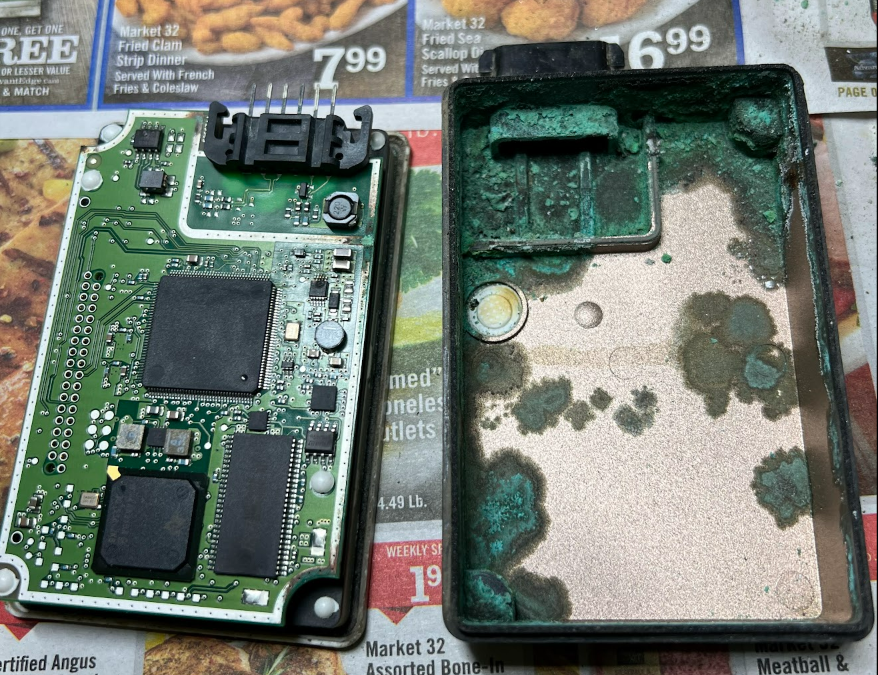

I just wanted to update this thread with my recent experience in case it can help others in the future. I started getting "blind spot assist inoperative" message in the dash during a recent 400 mile road trip. The message started on day 1, coming and going as I drove. On day 2 it triggered more warning messages, and basically all safety systems and traction control became inoperative, but the car still drove normally. After sitting a few hours and restarting all but the initial message went away and the car drove normally.
Upon getting home I scanned the car with my Icarsoft MBII and noted that I could communicate with the left rear radar module but not the right. The space where the modules sit is tight but I was able to remove both without removing the bumper. From there I swapped places with the modules and the problem moved, so that confirmed it was a bad module not wiring or something else. I had seen some other videos where people tried to clean them but I didn't have any luck with that. I was able to find a used part on ebay with nearly all matching numbers (the "Q#" didn't match up) and it was plug and play, no coding necessary. I sealed the cases with exterior caulking and put a decent layer of dielectric grease around the plugs to hopefully help seal out water. Others may wish to do this as a preventative measure rather than wait for an issue. This simple thing *may* strand you somewhere.
Message received trying to communicate with right rear.

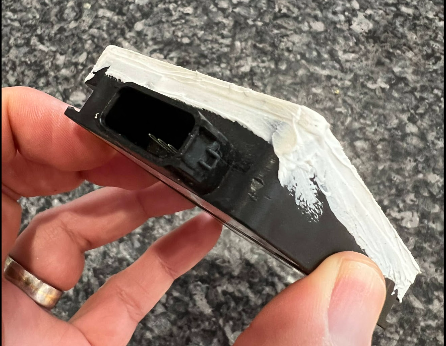

I pried the case apart by gently prying around the seam with a utility razor
Looks like this chip is blown out
Sealed with caulking
Nice DIY fixing
The one thing I suggest you should finish is the silicone job.
The case top and bottom are perfectly thermo sealed together. A doubled up seal all around can't hurt anything.
The original water penetration is by capillarity through the wiring harness connector seals.

post mortem evidence...
Don't take any body's words for granted... instead trust evidences of reality!
Thanks @up_too_late for providing us with investigation pictures. You get taylored inputs!
So here is what we have:
connector area is 100% saturated
Connector pins are fully/partially oxidized
unsoldered connector 😳
In conclusion, you should reseal all your exposed "waterproof" connectors.

swampy harness connectors
My first ebay replacement documented in this thread did not last as I hadn't listened to CaliBenzDriver.
I put a second one in, and this time took his advice to seal up the plug side of of the connection.
So far, so good.
the rear radar modules are directly sprayed by the rear wheels without any splash protection
Other candidates for proper harness waterproofing are located upfront (bumper /radars/temp; engine; steering) and under carriage with the tranny Intelligent Shifter Module connector (ISM: "Proceed to workshop without shifting...") located the lowest near muffler and the main single GND Strap.
It's low priority maintenance until it acts up.

sealing wires penetrations...
Originally Posted by Zynthe
Can you advise how to seal the plug after its plugged in? Do i just seal it off with silicone after its plugged in and working?
It's easy... use automotive RTV silicone sealant generously around wires where they penetrate into the connector rear. Done!
You could seal where the male connector end meats female end... personally I did not. There is a ribbed seal in there that works well.
Soaking pins into a bed of silicone grease: I do not.
I keep silicone (grease or sealant) away from Mercedes electrical connections.
Silicone is dielectric you don't want to interfere with normal connectivity.
(Silicone gel can be beneficial to protect heavy duty connections that can establish contact. Here females springiness is light duty).
