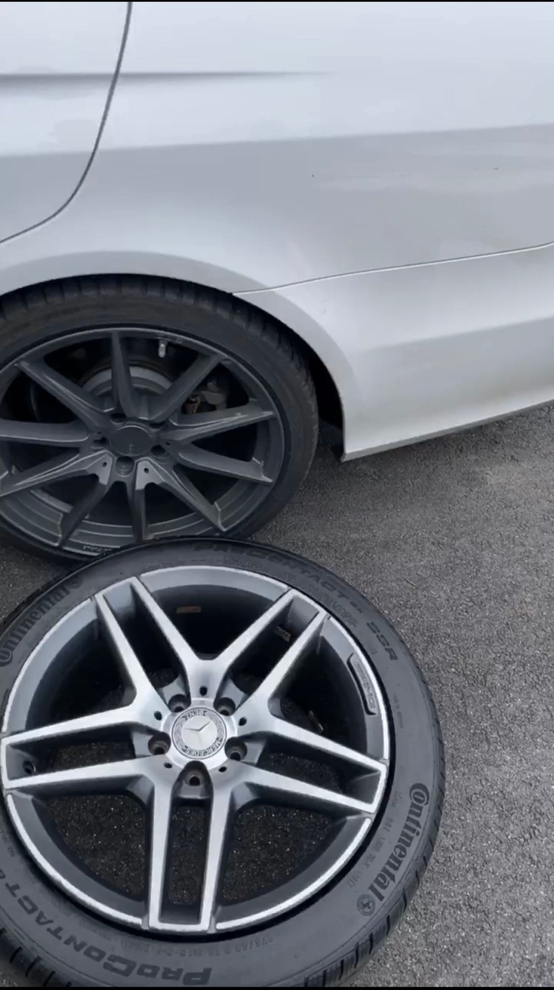

I picked these S Class wheels up yesterday and went to go test fit them but the tires are WAY too big to put them on my E class. The current tires on them are 255/45/19 and 275/40/19.
Does anyone know what the perfect tire size would be for these wheels on a 2014 E350 4Matic?
The wheel sizes are 8.5x19 et38 front
9.5x19 et38 rear.
Any feedback is appreciated!

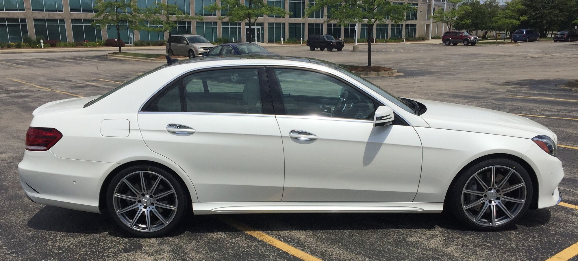

You won’t have any problem in front with that setup and the rear fenders are the same on the E63.
Here are my 285 rears. They got some beef!

Old Jan 29, 2020 | 07:01 AM
RA72825's Avatar
Joined: Oct 2005
Posts: 4,957
Likes: 1,640
2014 E550 4M on E63 AMG wheels

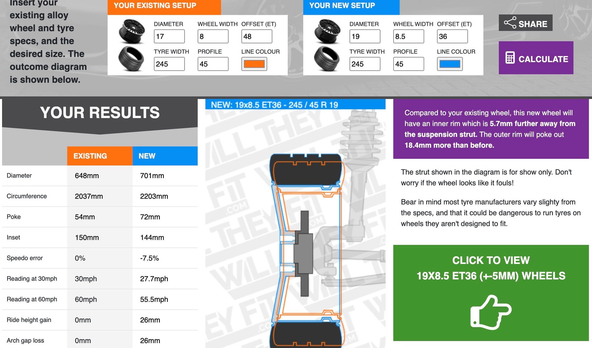

You can figure out the proper tire sizes with this tool: Tire size calculator

Hi.
I have tried that.
It doesn't look like "all that" much more than bone stock, yet, those who have tried say it does not fit...
Speedometer discrepancy is irrelevant to me.
Someone who has anything similar, your opinion will be Godsend! I really, really wouldn't want to lose out on the set.
