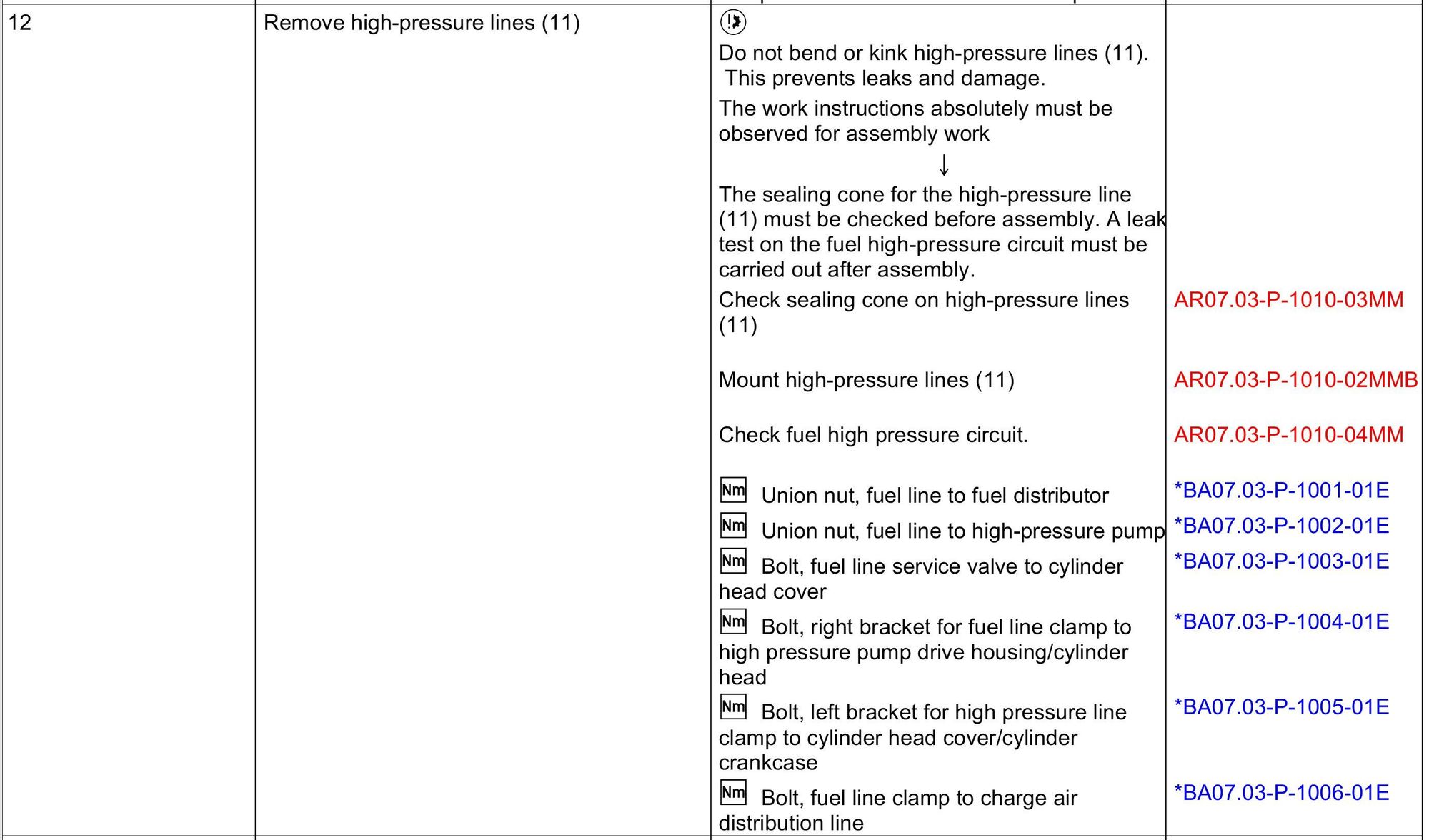

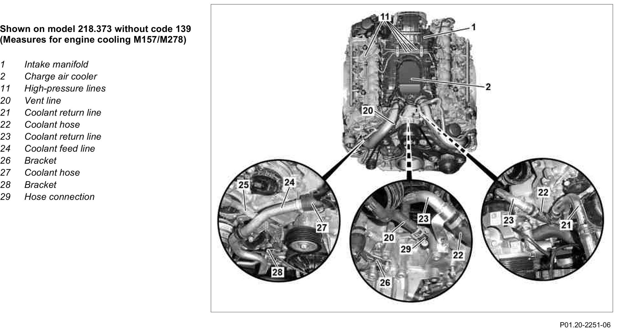

Hi All,

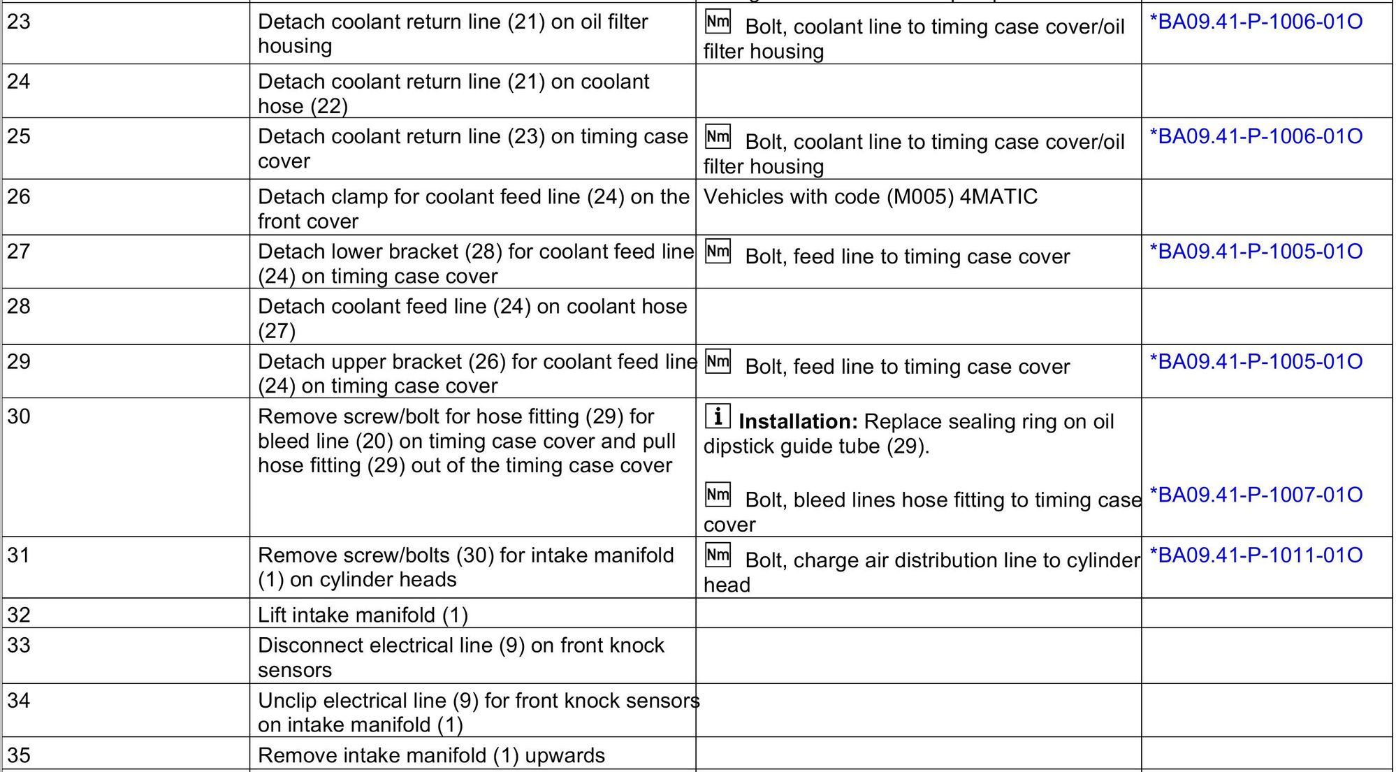

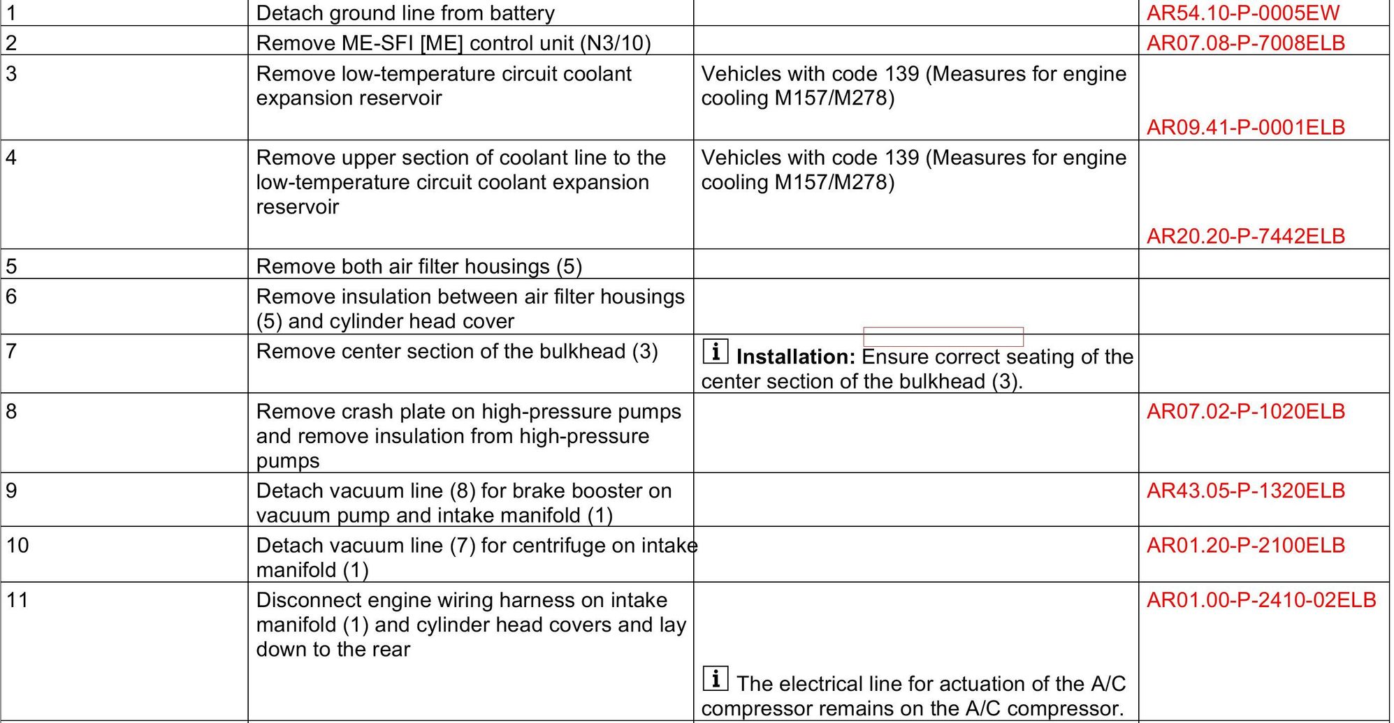

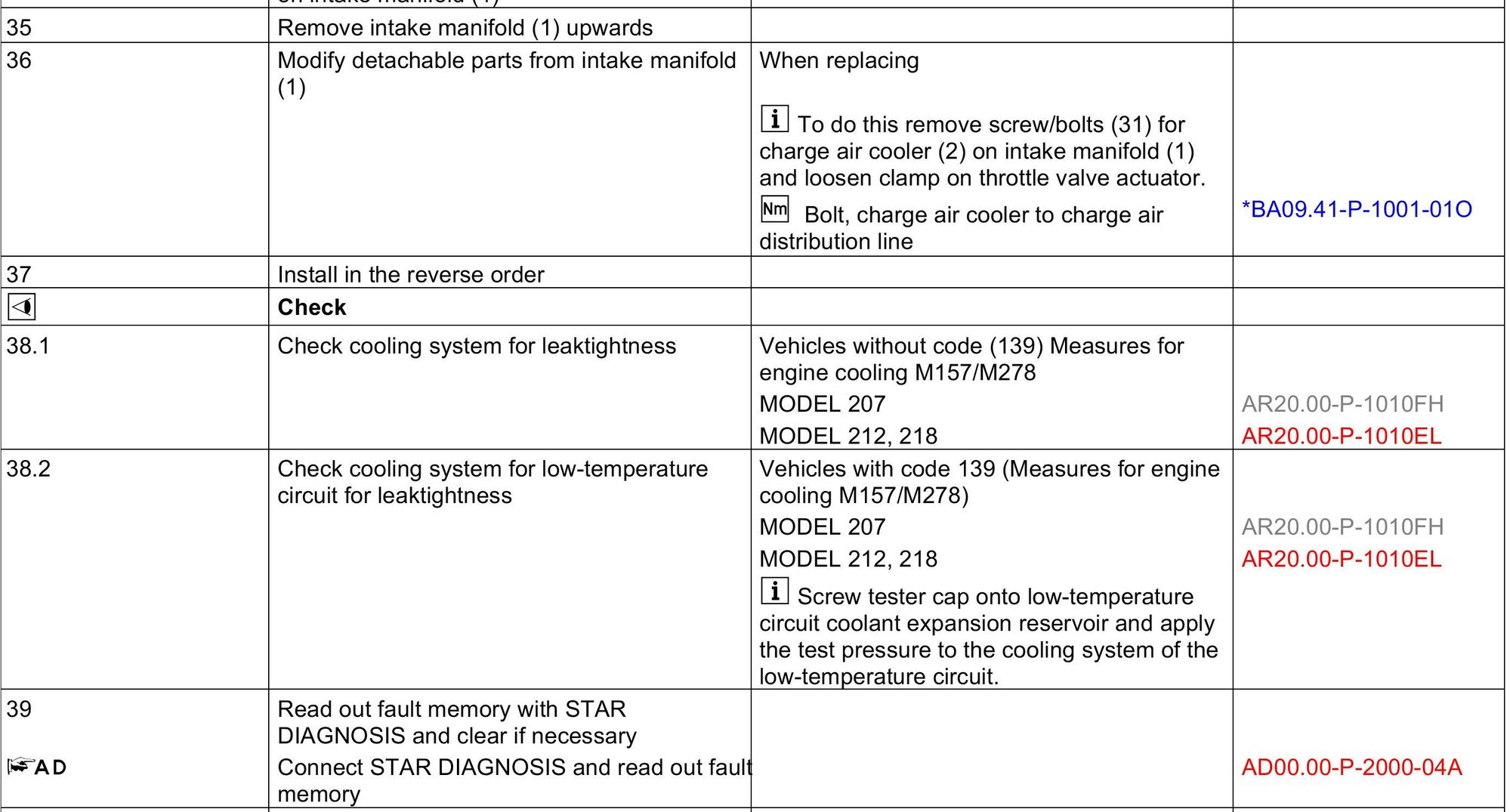

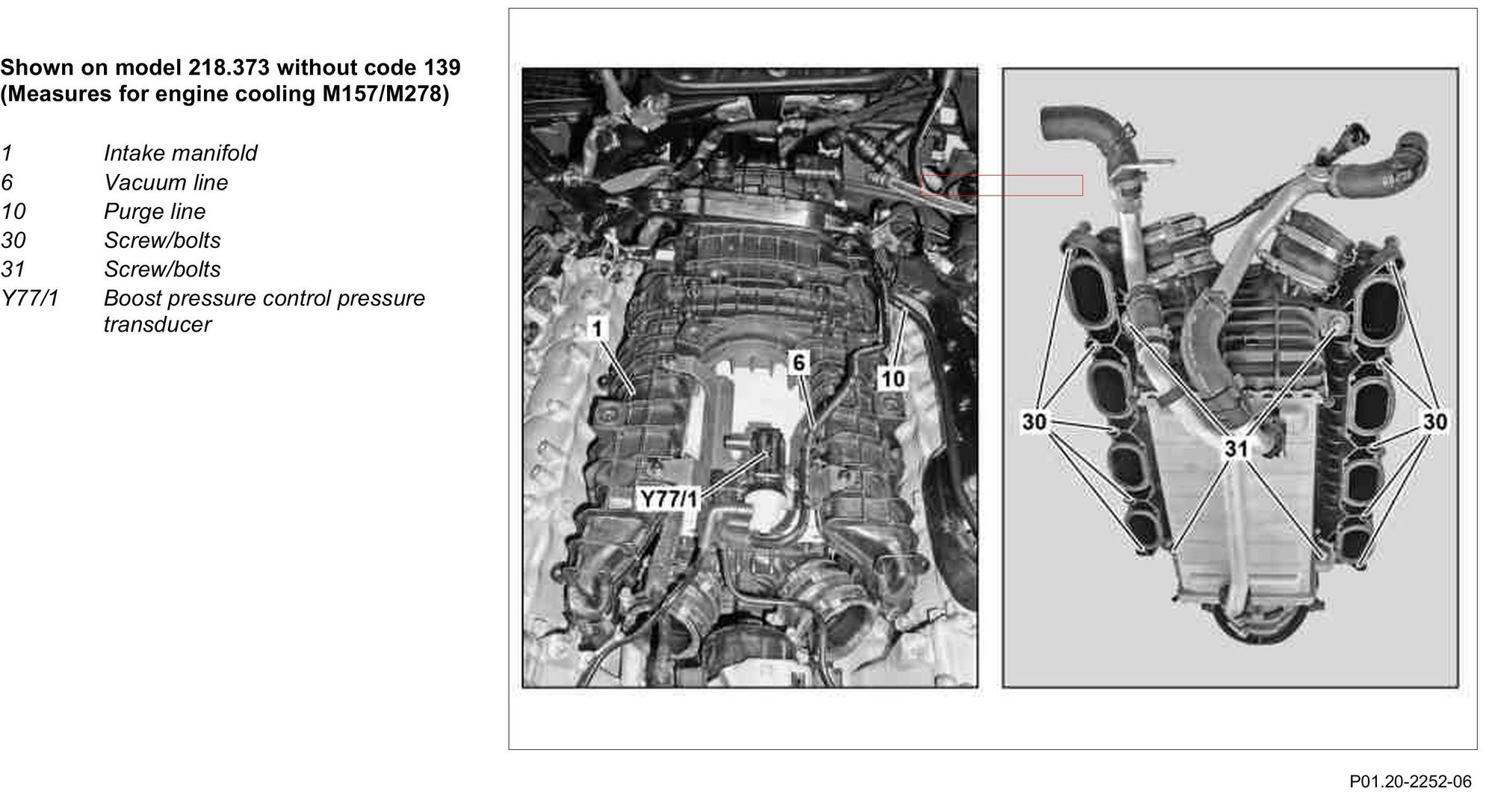

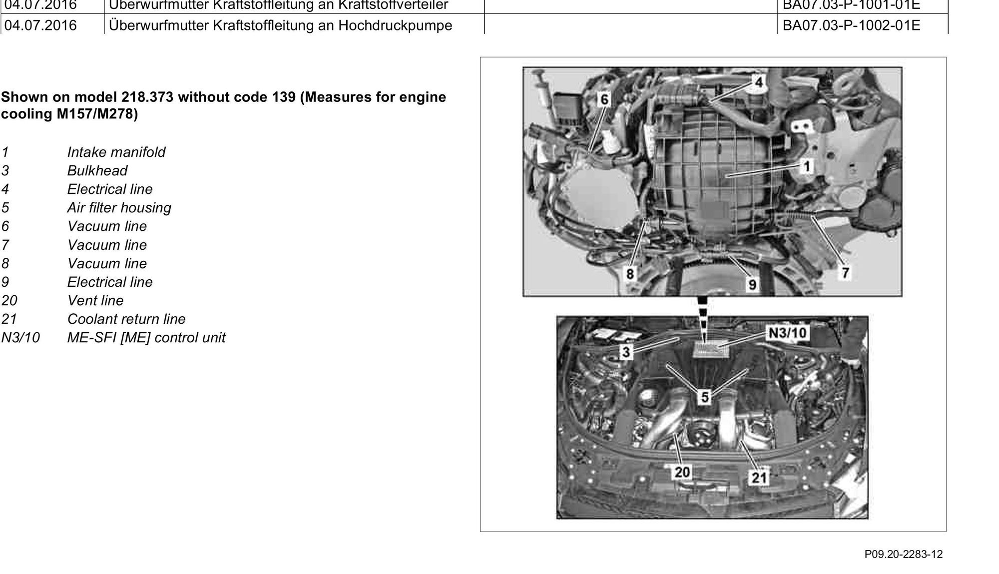

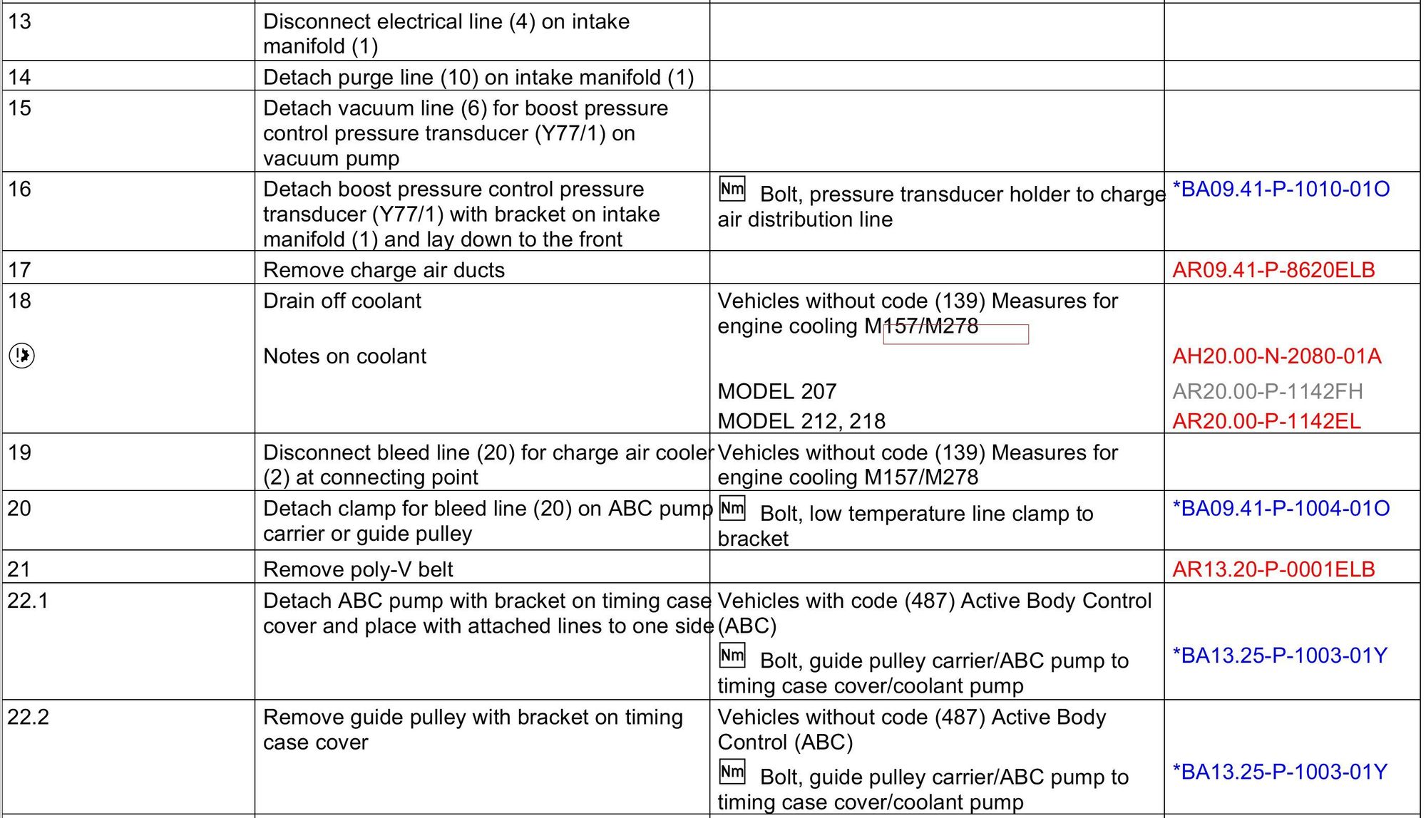

Here is what I got from the software:
We did open almost everything from fuel lines, ECU, electric wires over the manifold including 10 bolts on the intake manifold
but it seems to have some bolts/screw on the back so we could not lift the manifold up. Any suggestions?
Thanks in advance.

Hi All,
I would like to update you guys about my car misfire problem. One of my friend who own the garage for more than 30 years tried to take the intake manifold out. He spent about 4 hours but couldn't.
So, he then put back on without change the intake manifold gaskets. A month or longer later, another mechanic (both of them don't work on MB at all) out of town come and successfully replace the
gaskets for me. This guy spent about 9 hours to take it out and replace them. The tricky for this 2012 E550 engine M278 is that you much take out two bolts closed to the firewall (very close to the windshield).
In order to do so, you have to take out the firewall out. So the instruction I posted earlier from WIS software is correct, We have to take the firewall out or no way to remove these two bolts. Of course you have
to take the gas lines and coolant lines out as instructed. While the intake manifold was out, We saw some oil in the intake manifold especially two cylinders closed to the windshield, so we decide change also the
Engine Crankcase Vent Valve (part # 278 010 04 31). At the same time, we also replace all ignition coils and spark plugs. Now the car drive like a new car and NO MORE MISFIRE.
So if have misfire coded: P0301, consider changing the intake manifold gaskets. It takes lots of time but worth-ed
