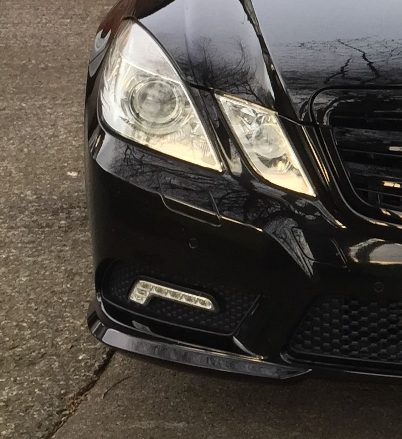

Hi guys Does anyone know how I can remove my DRL on my E Class 2010, as I’m going to try to fly mesh wrap them, pictures or video help ideal

If you remove everything from behind it like the wheel, fender liner, and gravel shields you can see the screws and clips and stuff on the other side.

Expect to spend some time getting them out and back in - its not a 20 min job...Take your time- you do not want to break any tabs
Also - you will want consider taking out the whole housing as its much easier than trying to squeeze it from the housing....You will understand when you pull it apart.
Not sure why fly mesh is? Maybe you mean blacking them out?
