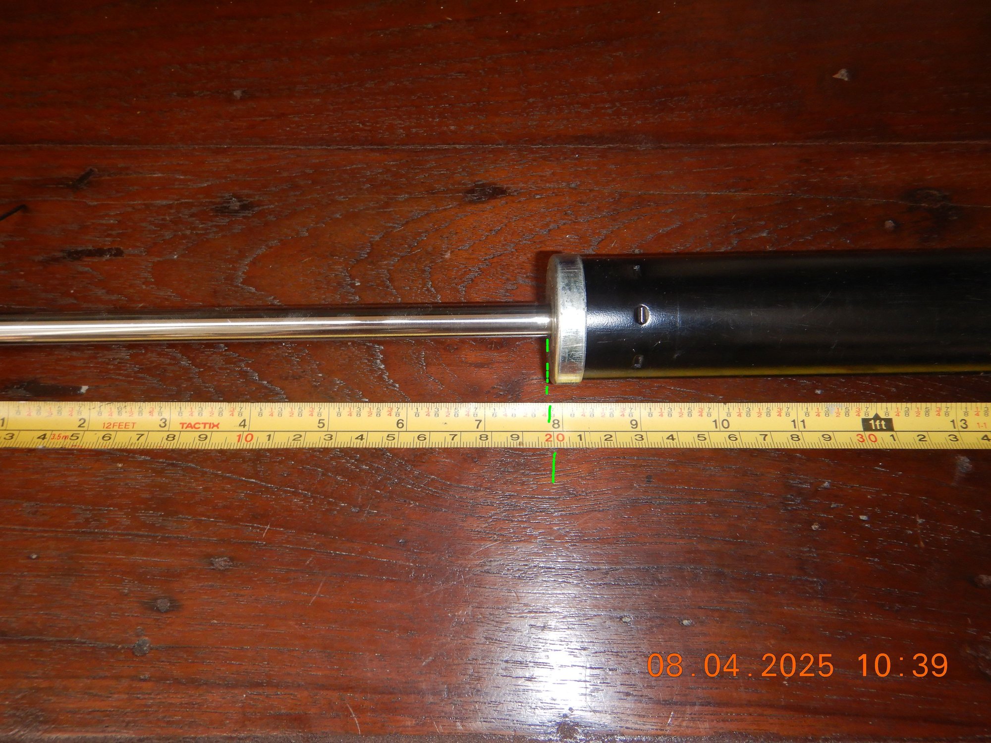

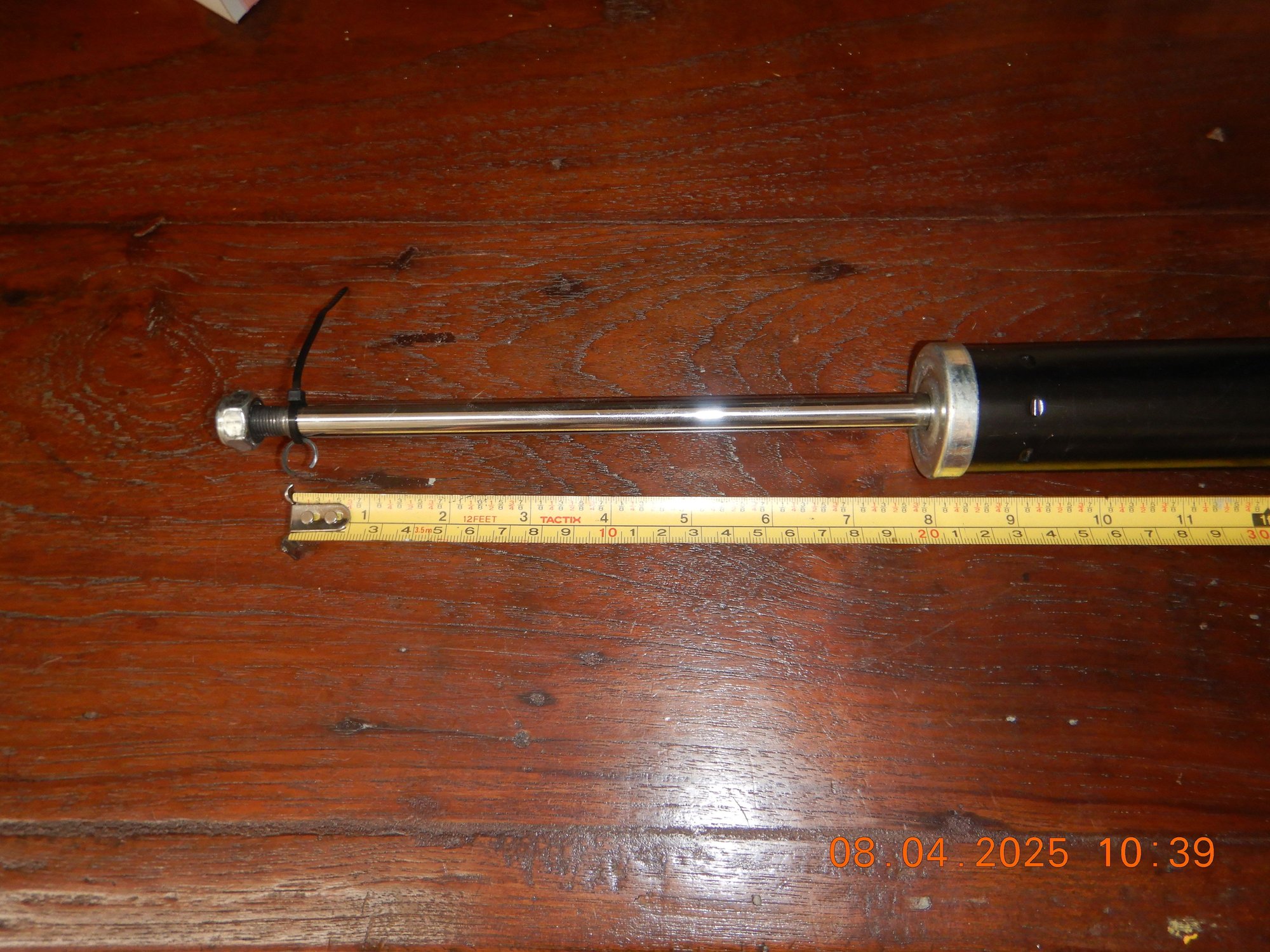

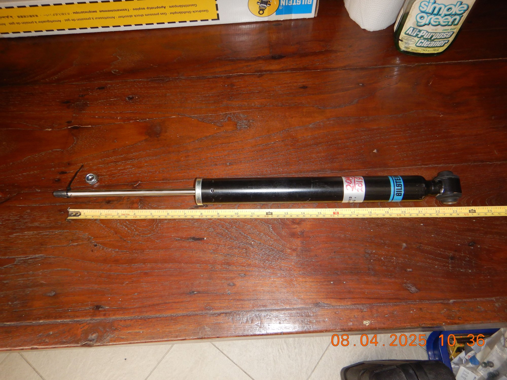

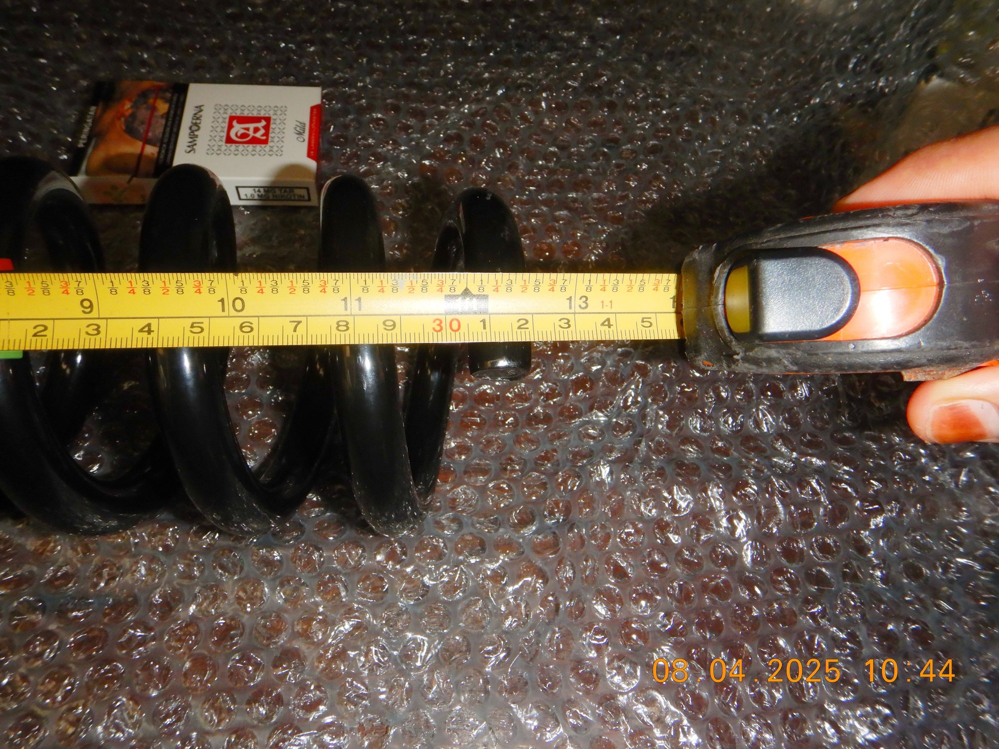

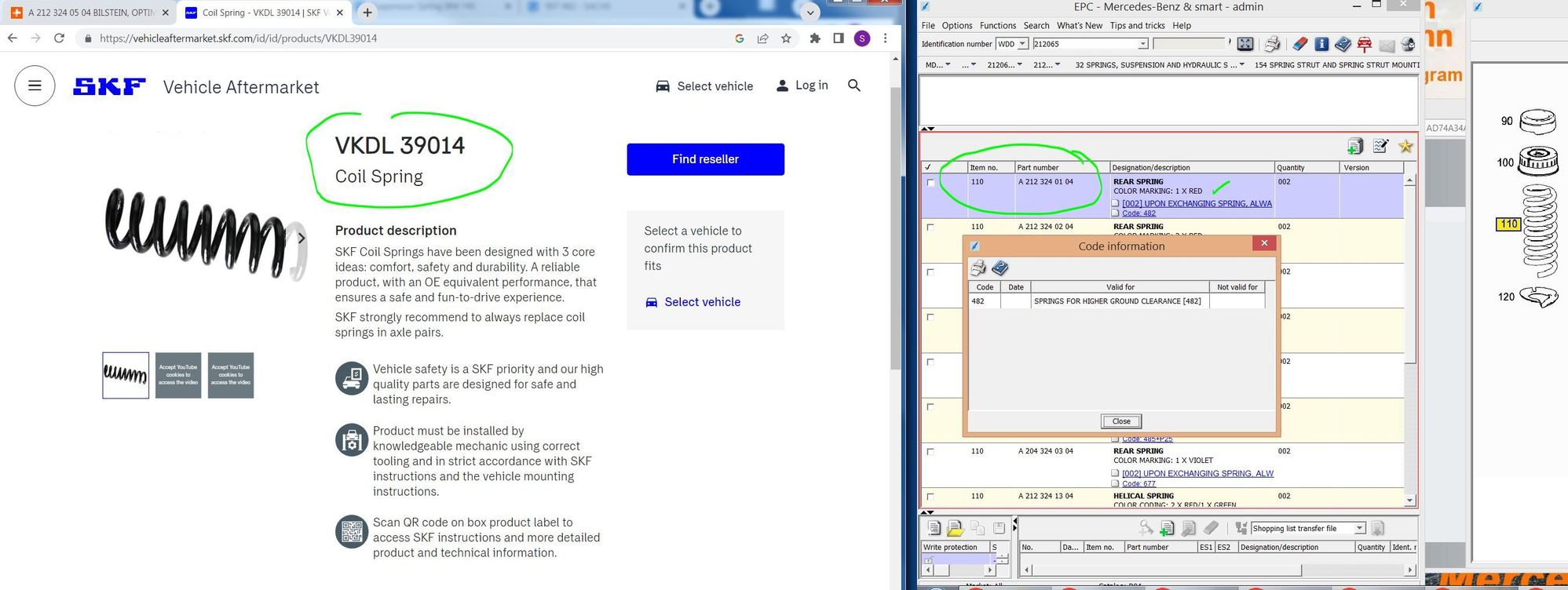

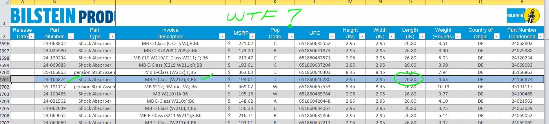

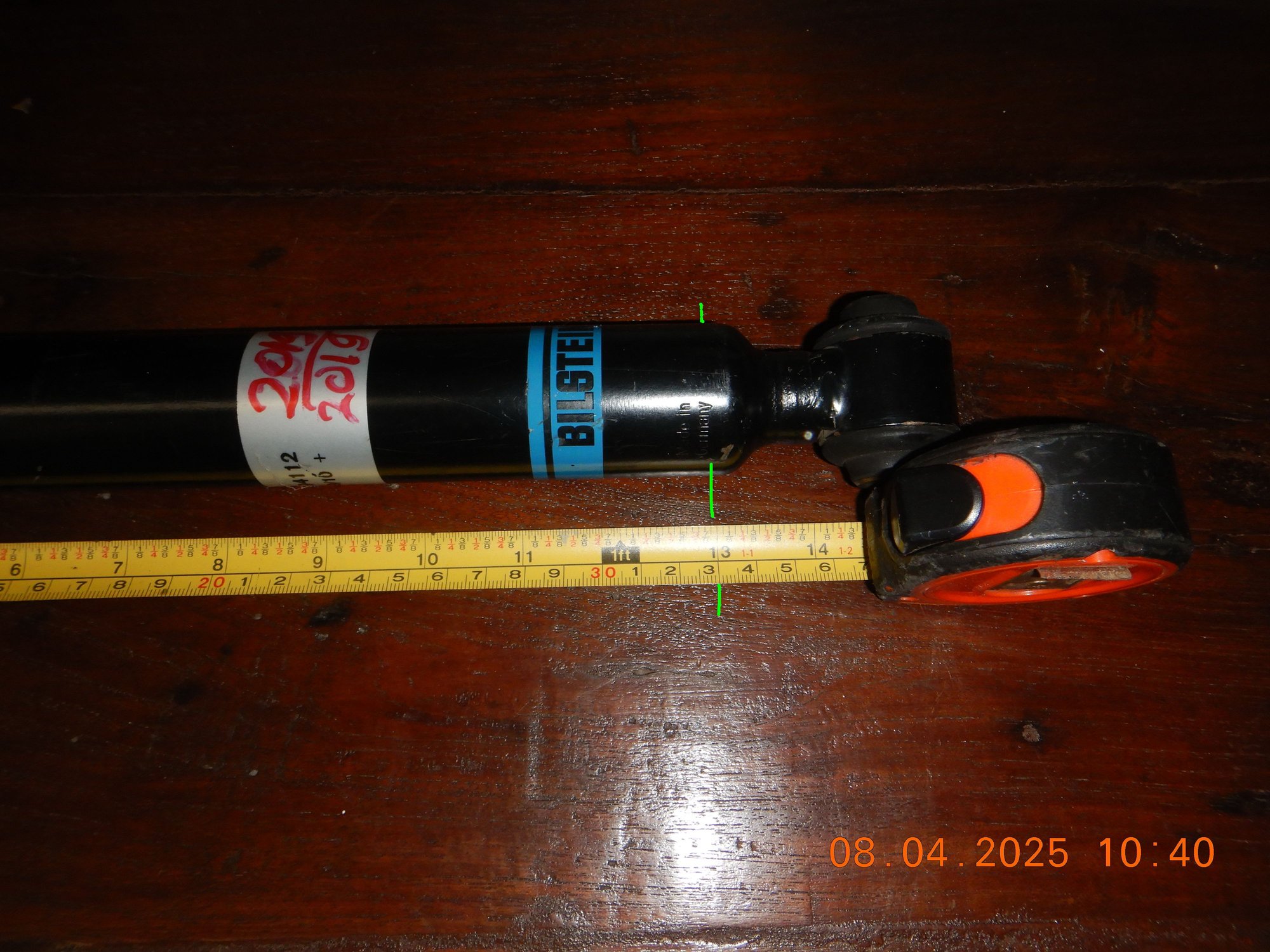

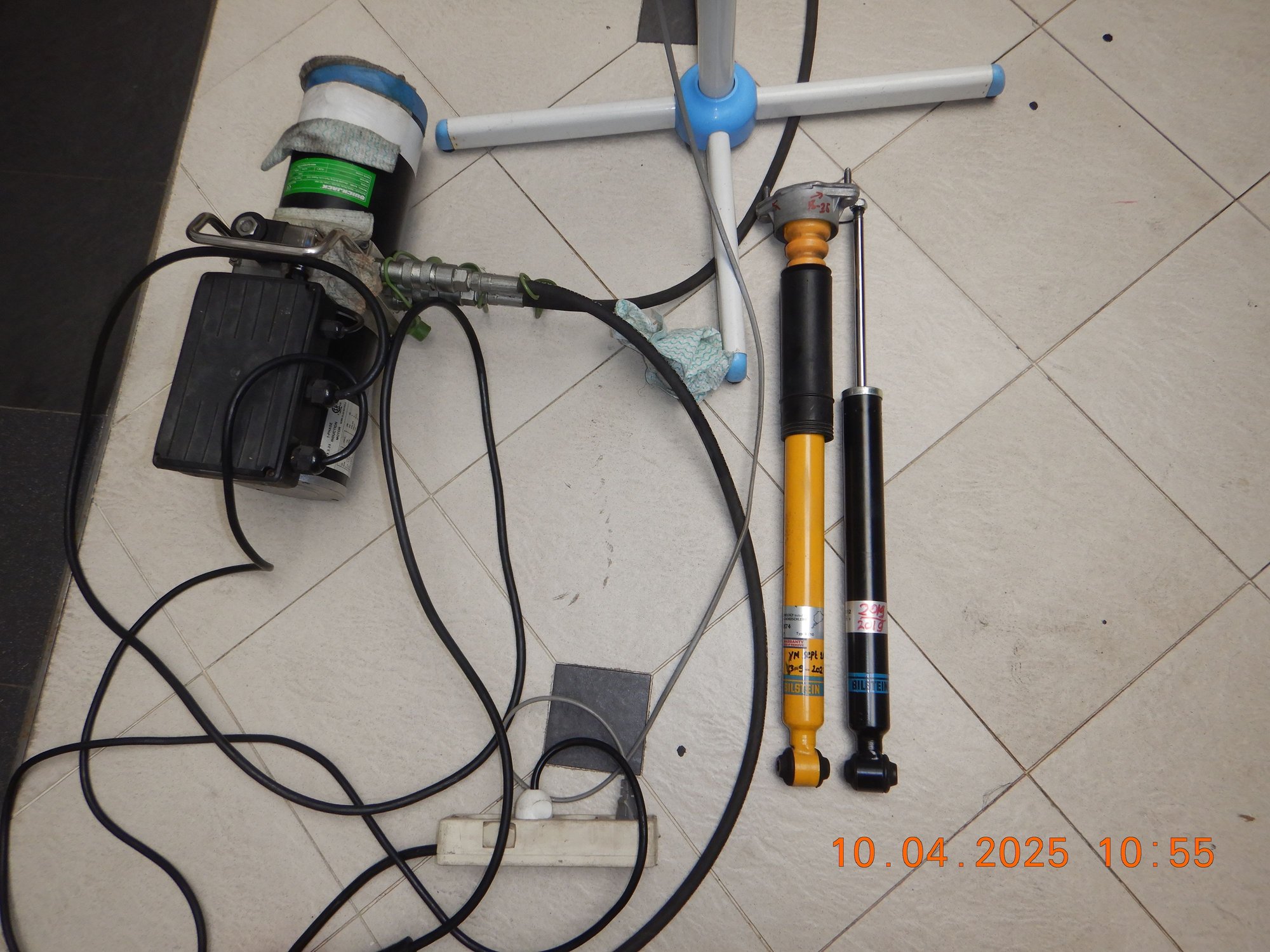

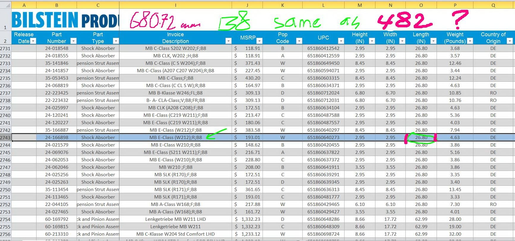

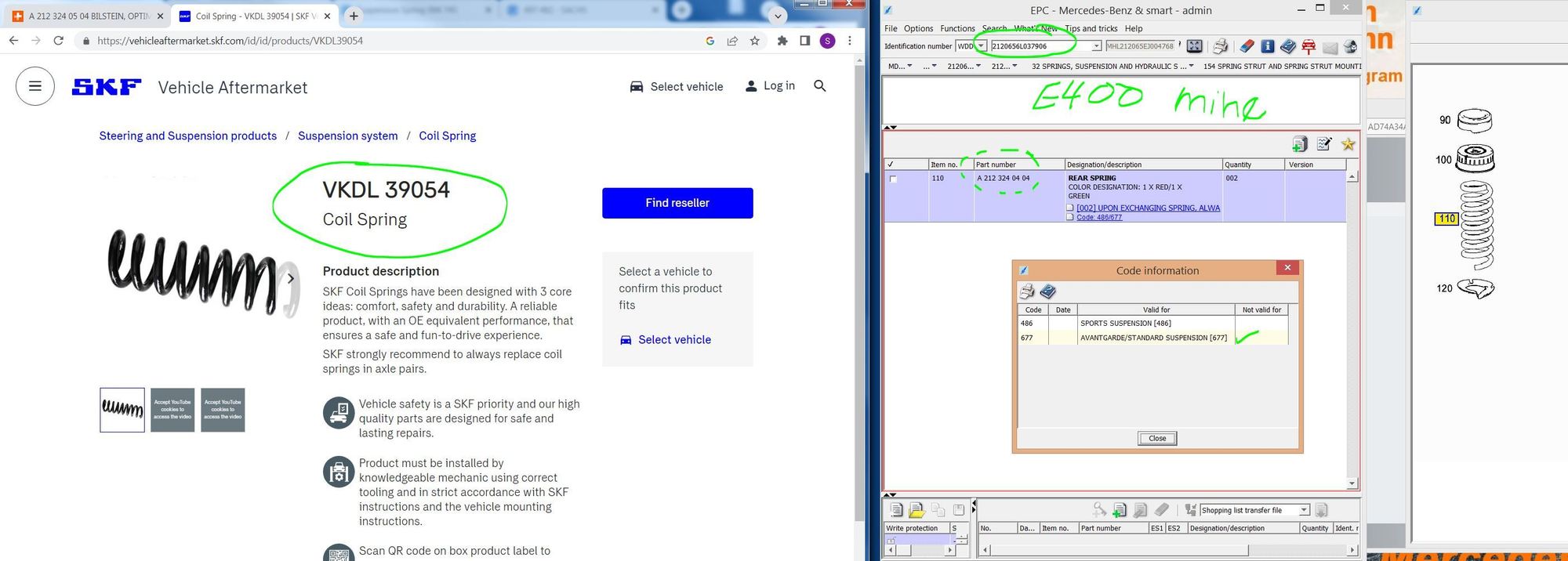

I done some measurement for you.

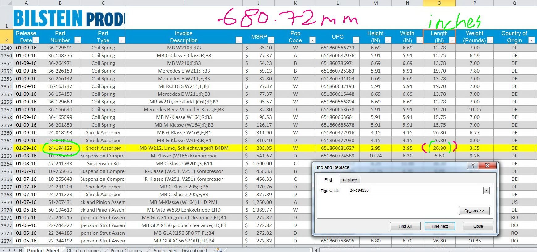

Attached Bilstein catalog excel file

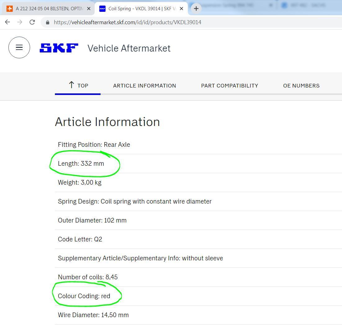

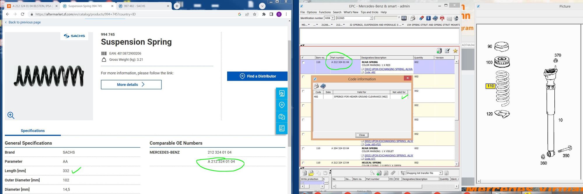

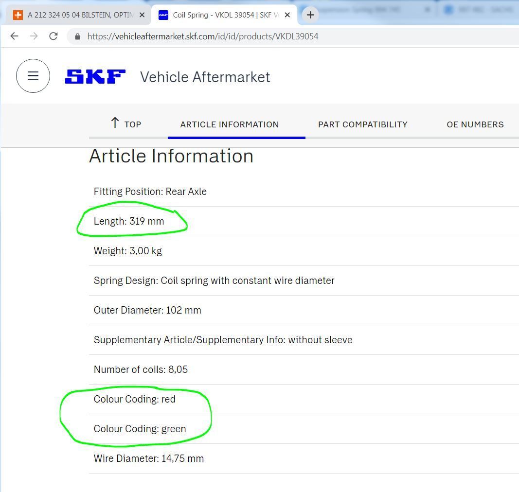

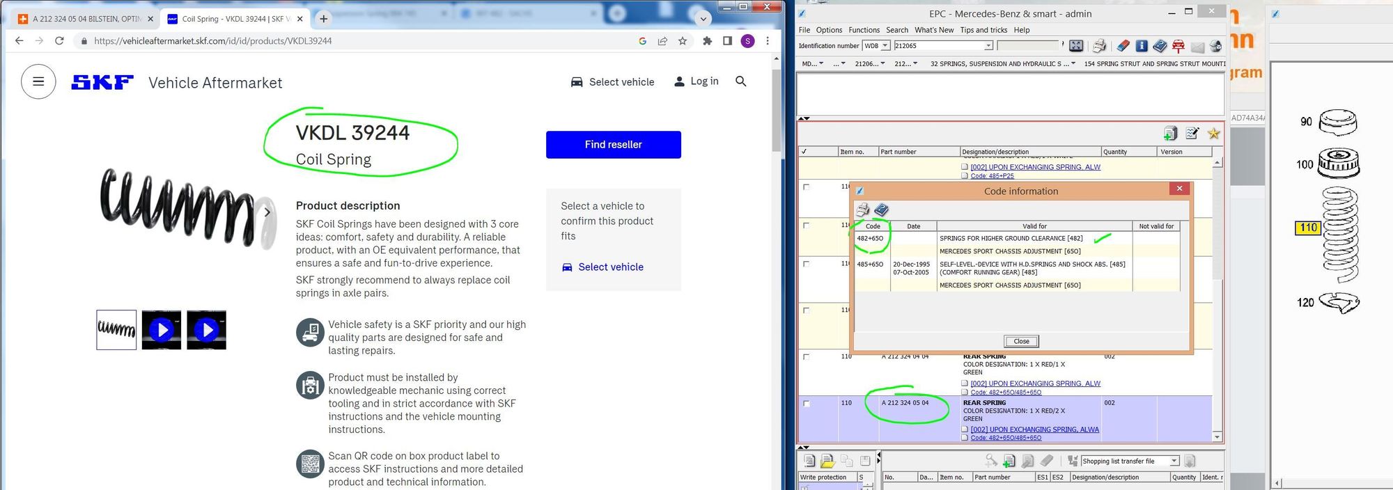

First we trace the spring spec for the intended 482 vs 677 suspension code
482, without 650
IF SACHS
IF SKF, sama data

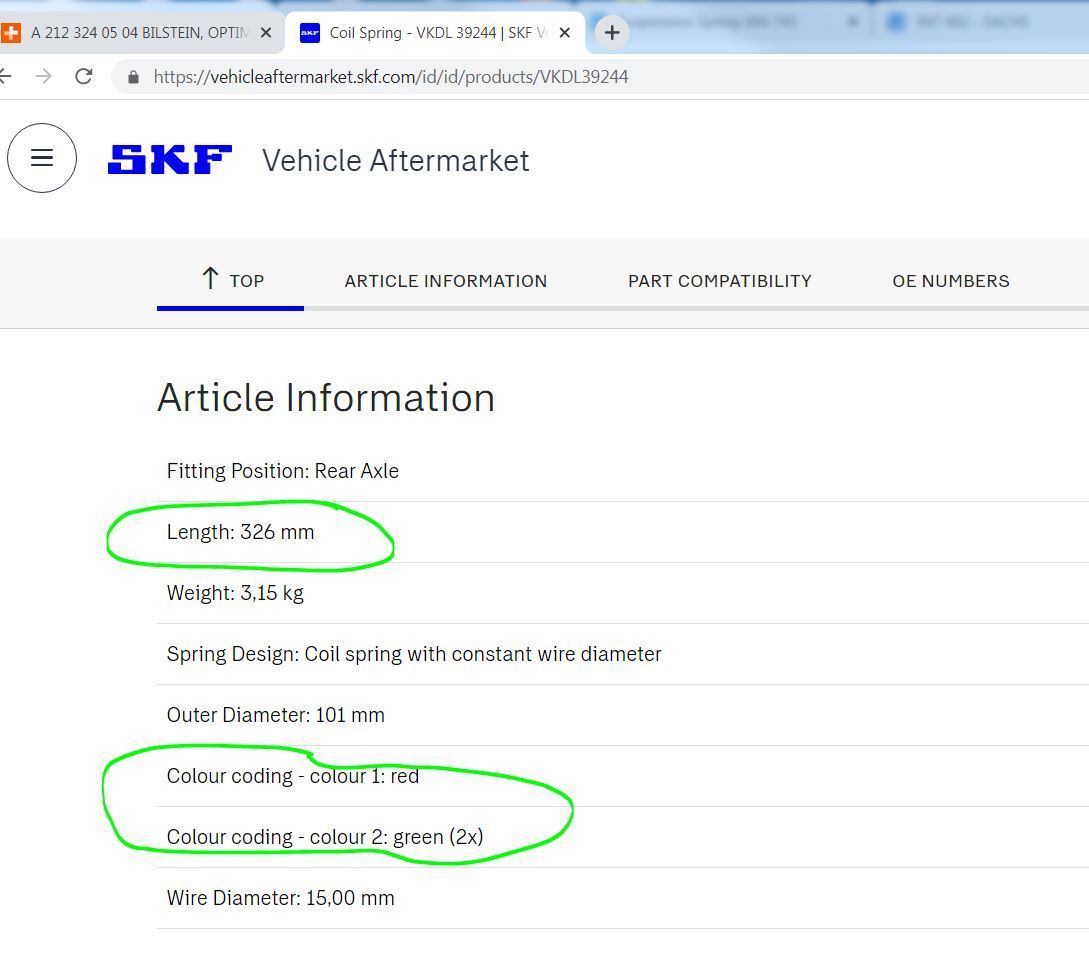

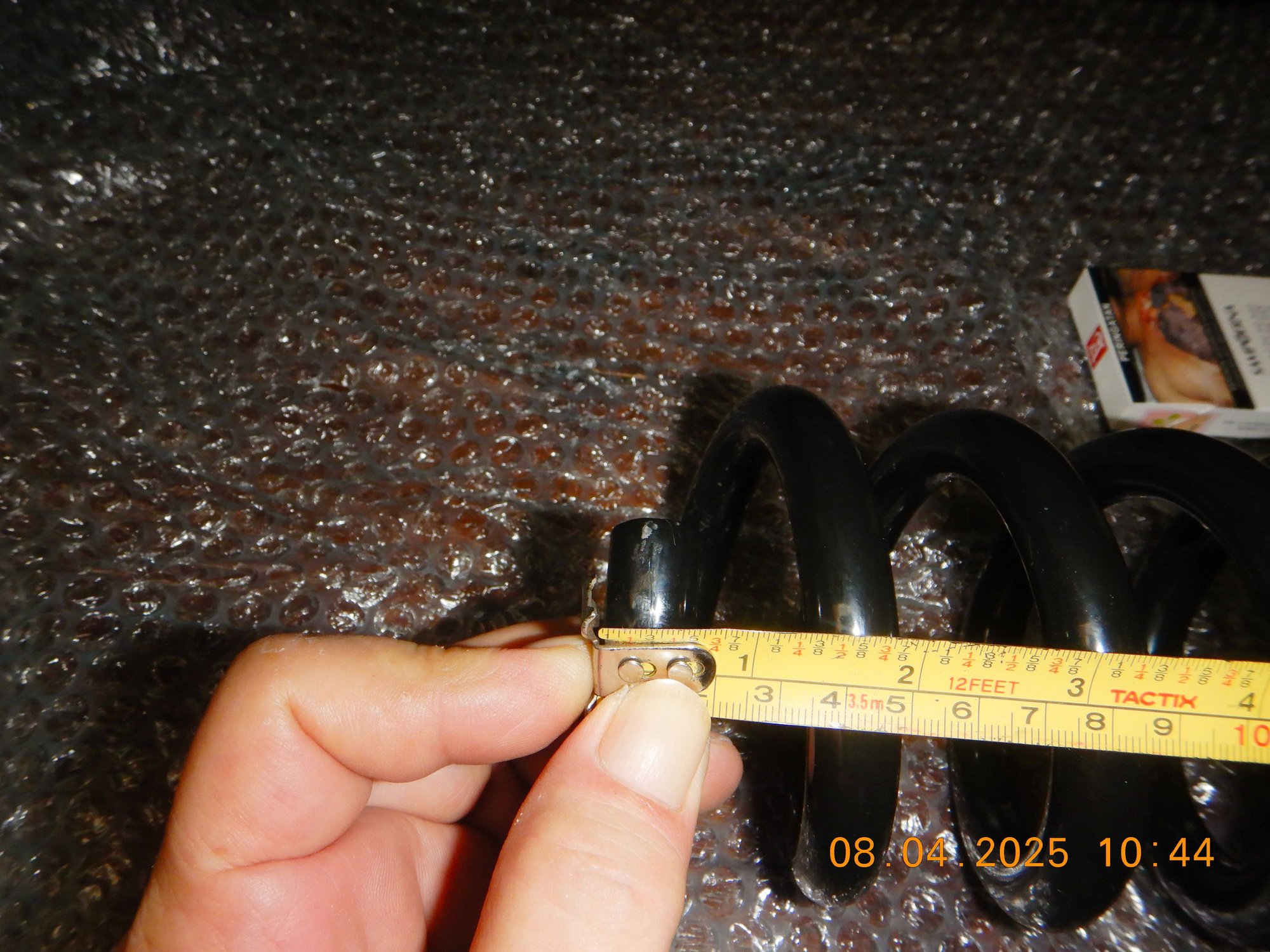

So, if 482 and P/N of spring being A2123240104 with 1 red dot only, total height or length is 332 mm.
If 482 + 650, P/N being A2123240504 , 1 red dot and 2 green dot. Total length is 326mm
Our 677 Spring P/N being A2123240404 , 1 red dot and 1 green dot. Length is 319mm and it i s true. I measure my new one, un-used one.

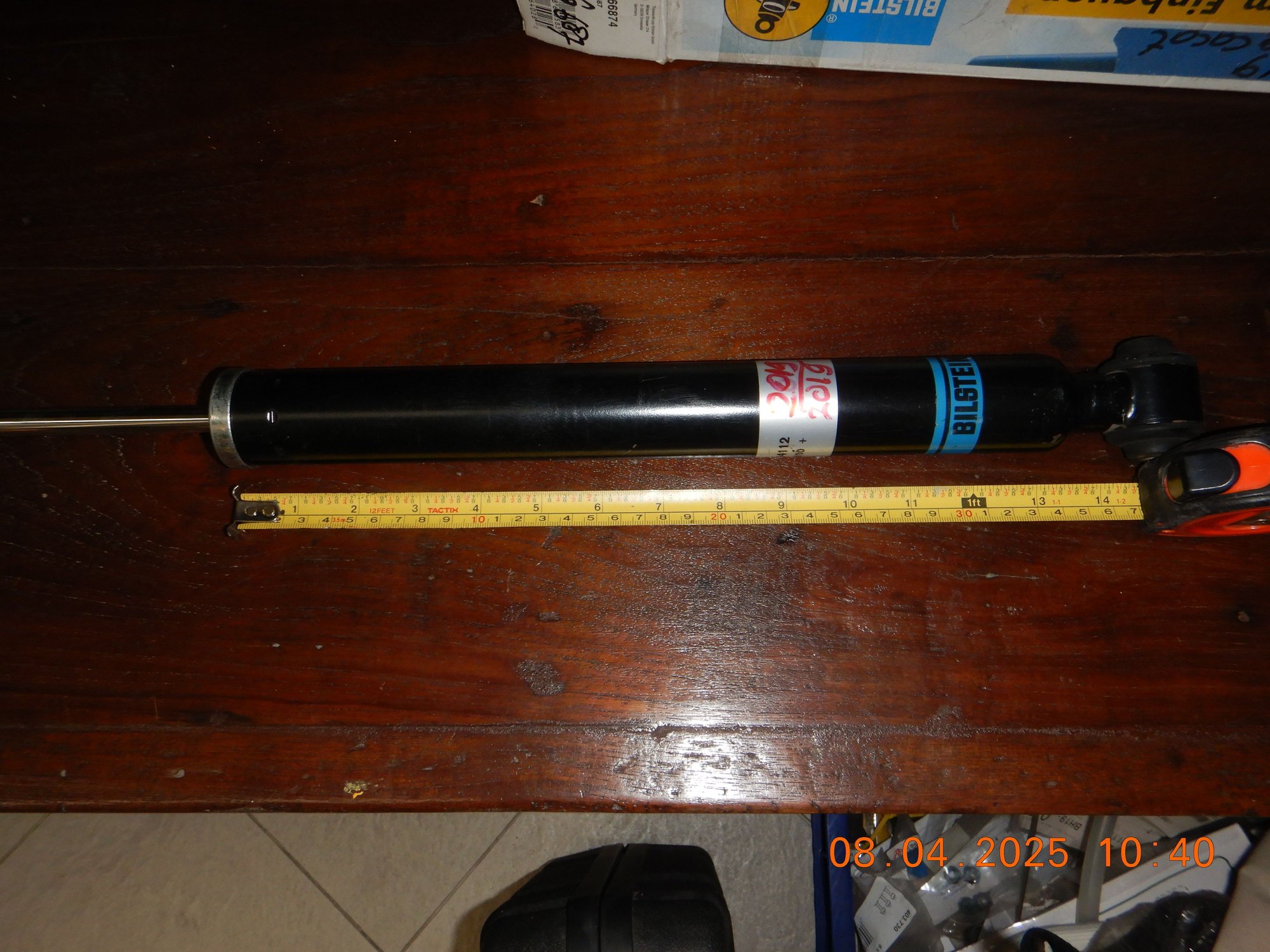

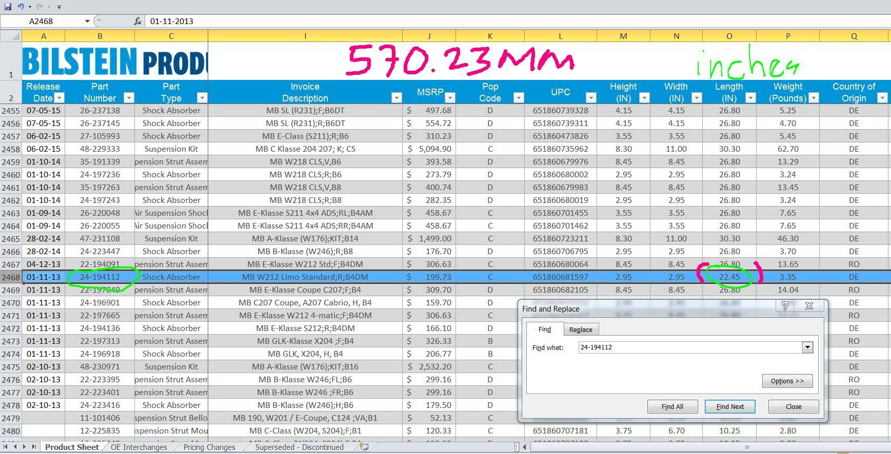

Verify damper total length.

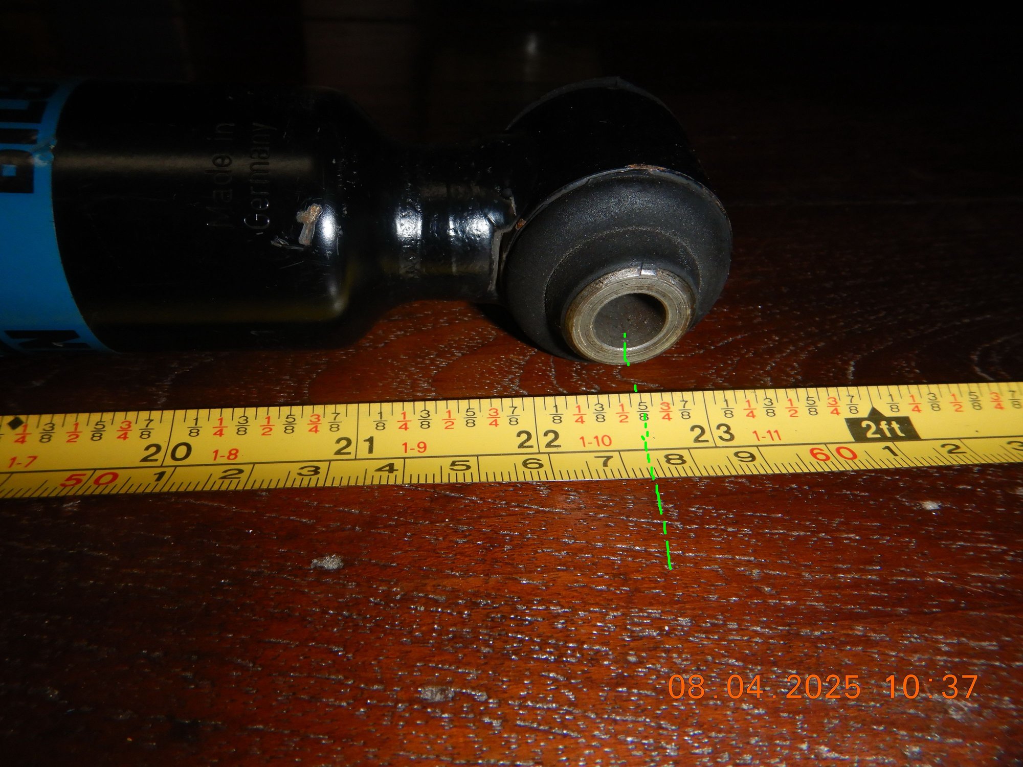

My B4 actual vs Bilstein spec. Yes, correct, it is 570.xx millimeters. P/N is 24-194112
Your in question P/N 24-194129 which is equivalent to the option 482 (SPRINGS FOR HIGHER GROUND CLEARANCE) is much taller, by 11cm
Verify how Bilstein measure the B4.

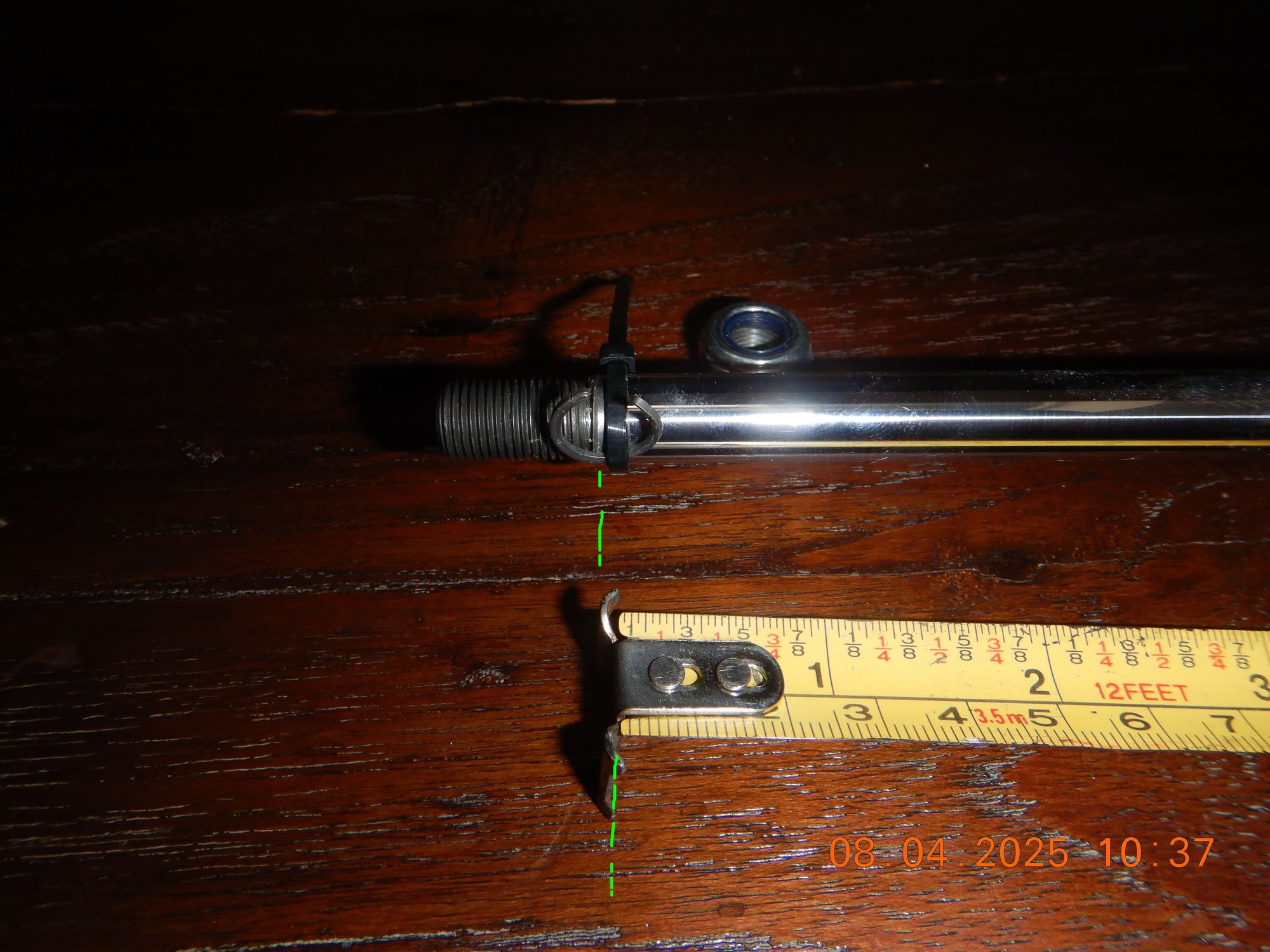

Length measured from C clip location to center of mounting bolt . 570.50mm approx
C clip location to body/seal 200mm << piston shaft working length/height
Body length, assumed useable space . 330mm
Useable as in piston shaft and pistons to be held inside it
I think it is a risk for you to use that : shocks 24-194129 which is equivalent to the option 482 (SPRINGS FOR HIGHER GROUND CLEARANCE)
When you bottom out, the damper/shock maybe get hit as in it maxed out first, instead of spring maxing out first. 10cm is too much.
This is based on, if that indeed 24-194129 is 680mm total length. Maybe ask the seller to measure ?
I said this is because funny enough B8 which is supposed for lowered cars, is as long as 24-194129 , if we trust the excel file.
https://www.bilstein-shocks.co.uk/bl...nd-bilstein-b8

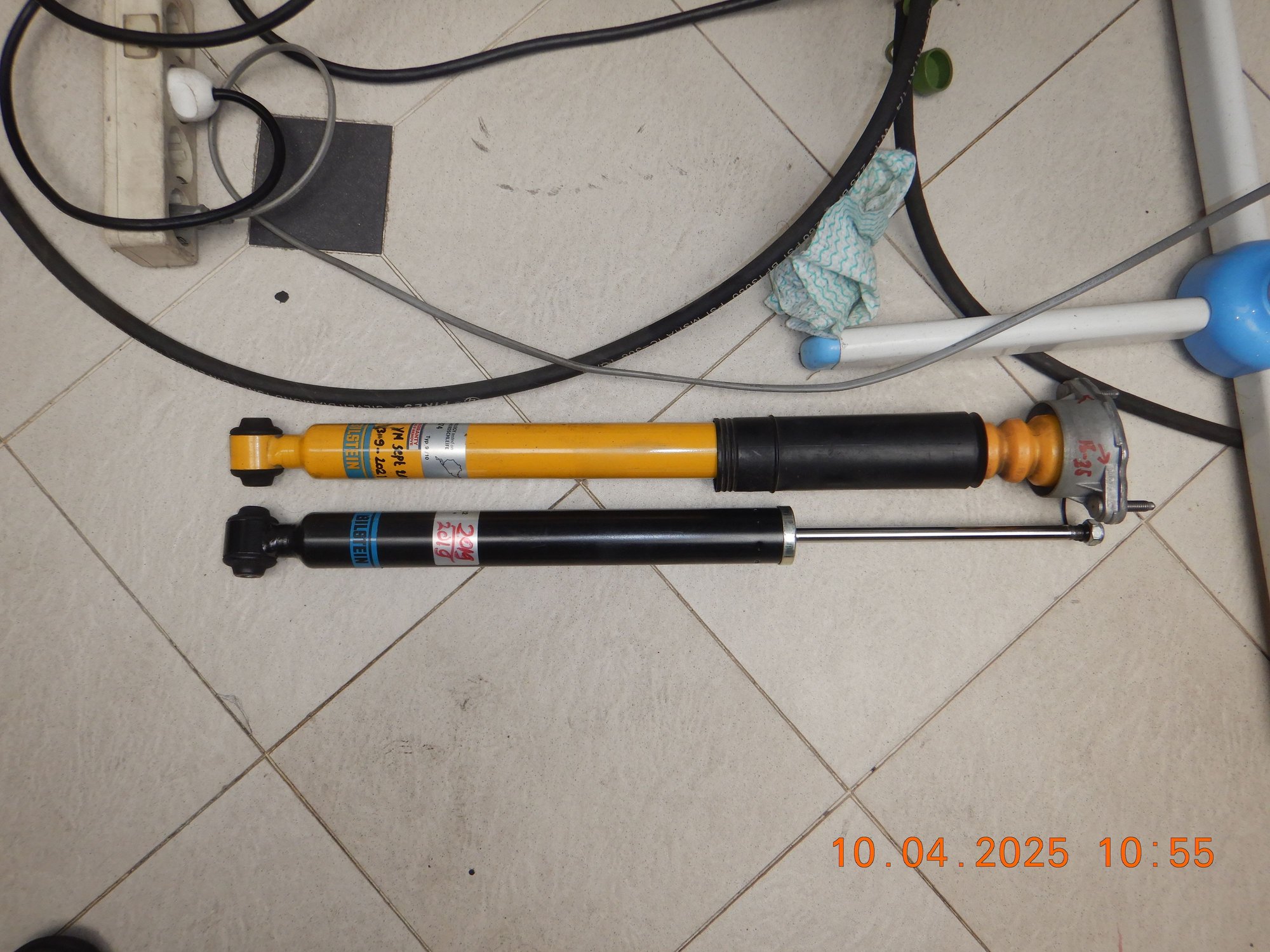

Let's look at my B6 by spec. What the hell, also 680mm...NOPE, it is the same length as B4
My B6, on the rear only.
Happy investigating..........

Hi @S-Prihadi ! Thank you for the information, as always, this was a deep dive.
I agree, 10cm is just too much. I was expecting the difference to be about 1 in (2,5 cm). It is odd the information on the length however. Filtering out all applications listed for the E400 they all have 26,8 in in length except 24-194112. I'll try and call the seller to check if they can measure the unit.

B6 and B4 uis 100% same height,,,,,,,,as I explained earlier.

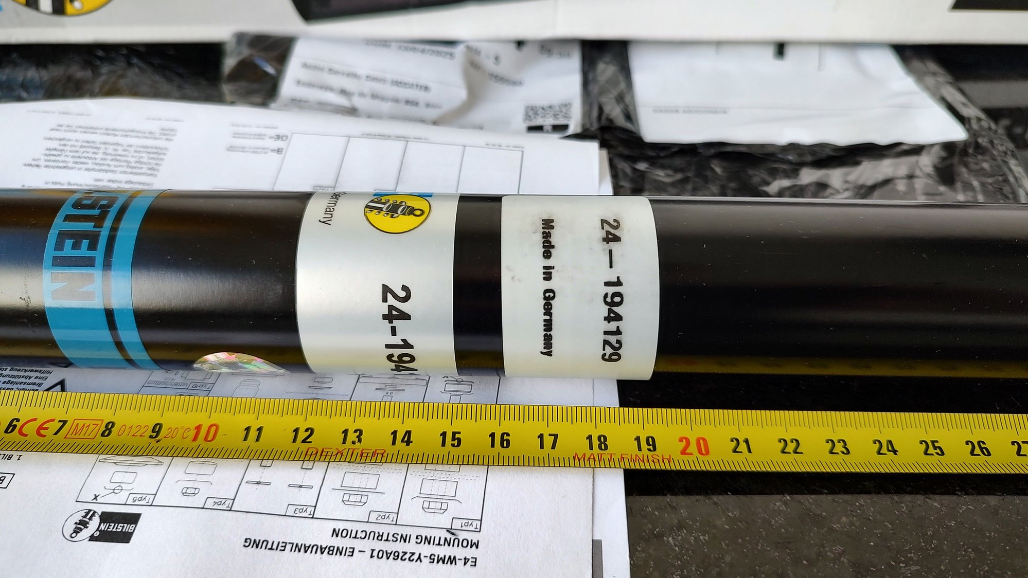

This means the length for the 24-166874 (B6) is listed incorrectly on the spreadsheet correct? As an update, the seller for the shocks 24-194129 (option 482) said he couldn't measure it but said that since they have a 30-day return policy (no questions asked) I could but the unit and measure it myself before installing. I've ordered it and it should arrive during the weekend. This way I'll be able to confirm whether it really is 10cm longer. I'm suspecting this is just a mistake on the spreadsheet perhaps. Looking at the option 482 spring data, it is only a 7mm longer with a beefier wire diameter (15mm vs. 14,75mm). I'm guessing the higher ground clearance comes from the harder spring mostly.
Thank you!
Old Apr 12, 2025 | 06:14 PM
  #60
Andre Cateb's Avatar
Joined: Nov 2018
Posts: 210
Likes: 119
From: Brazil
W212 (212.065/276.820)

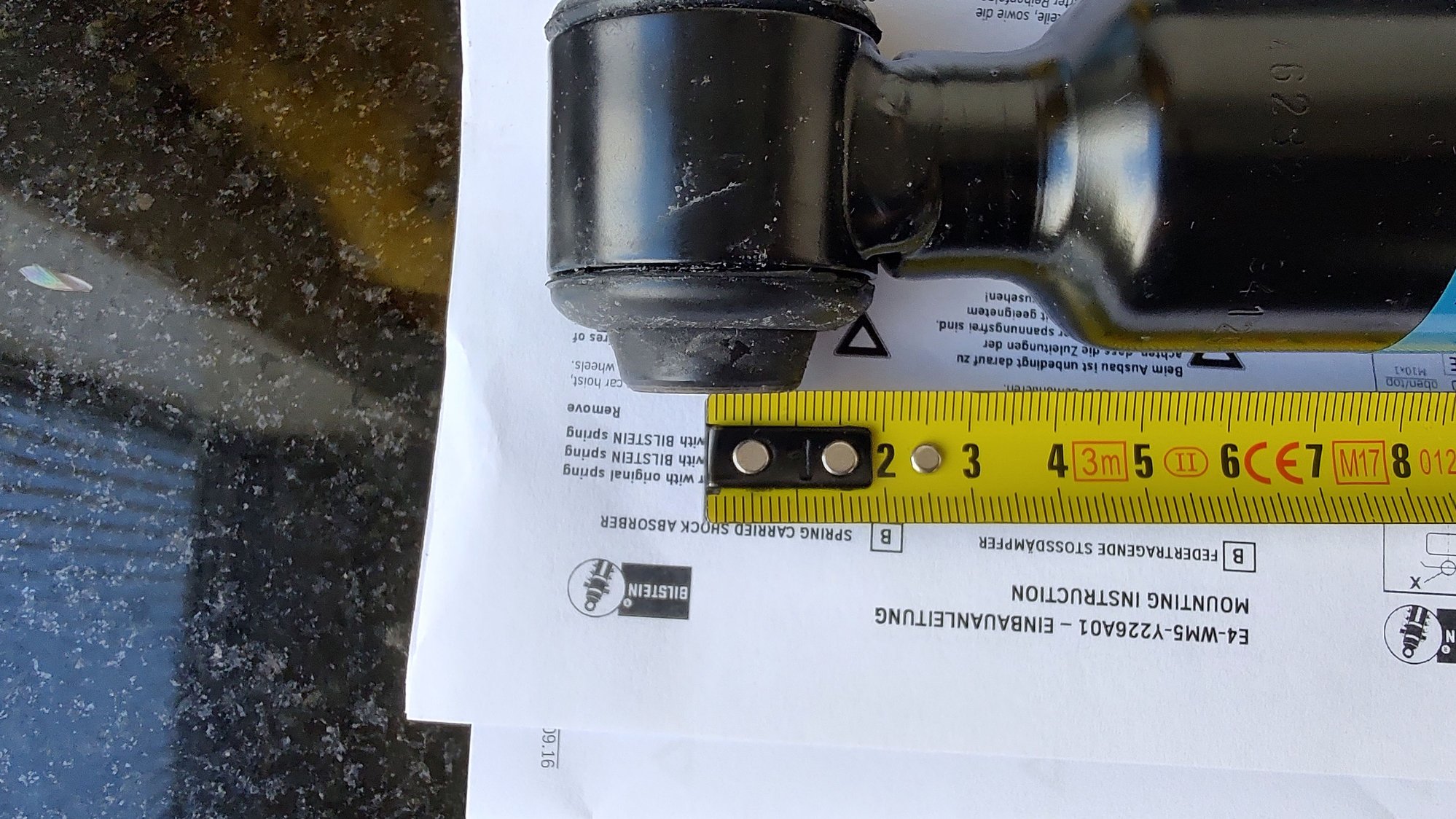

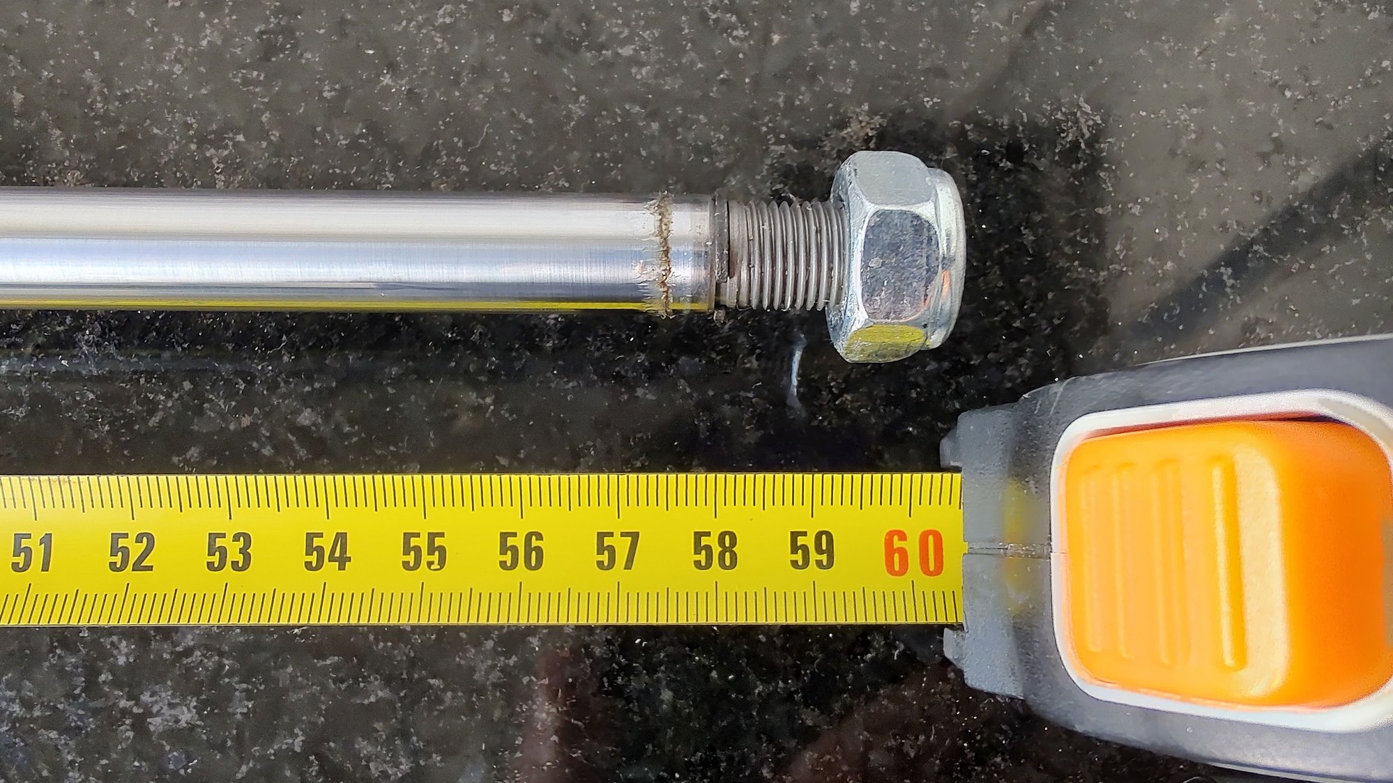

Hi everyone! The 24-194129 shocks arrived and they have about 58cm hence only 5mm longer them which makes far more sense. Since they are designed for a tougher spring I reckon they are likely assembled with more damping force which should be fine for my set-up. Should loose a bit of confort but get a firmer rear end. I'll share an update after installation.
