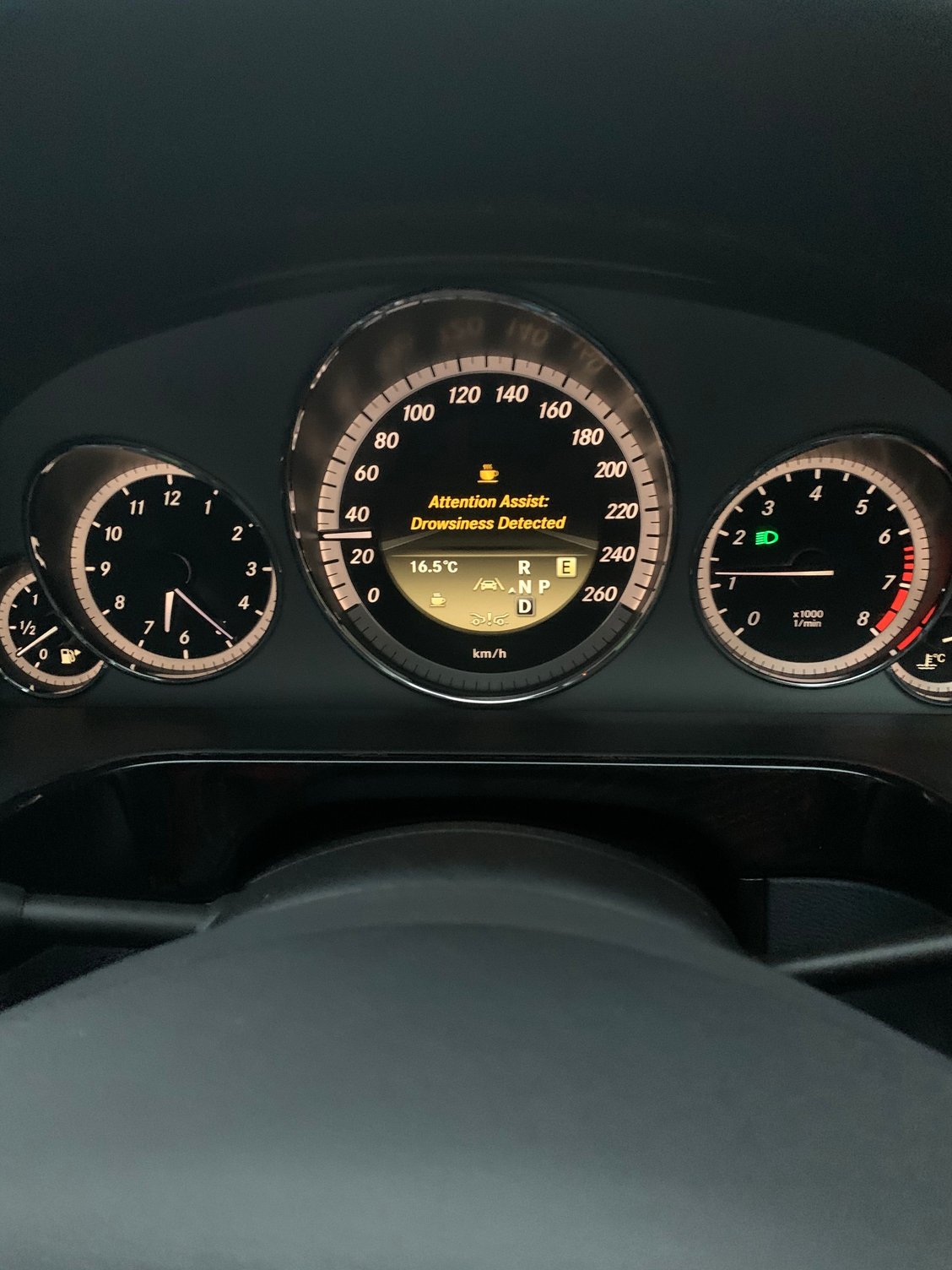

I have a 2012 E350. During a five hour plus trip, Google Maps gave me instructions that were at odds with my sat-nav. Strayed towards the edge of the road when I took a quick glance at my iPhone. The steering wheel vibrated vigorously in conjunction with three high pitched beeps, and a drowsiness detected message popped up.
