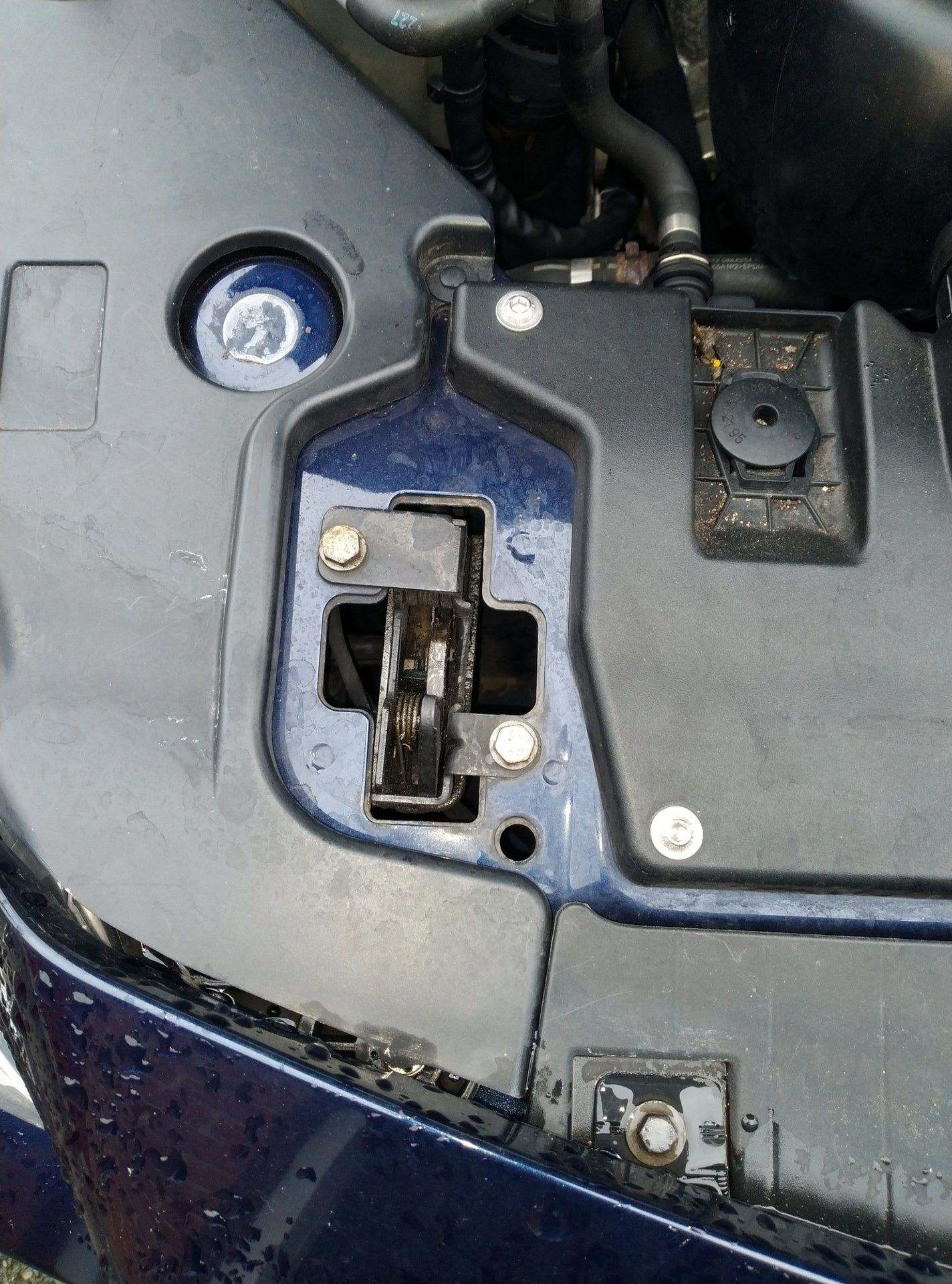

Had this happen to me a while ago. I kept slamming my hood and the message would still pop up. What I did was I opened my hood, took a look at both side where they latch onto. One side was noticeably higher than the other so i took a screw driver and press down onto the latch until it reset itself, went back into my car and released the latch and closed the hood. Seemed to work.
Pic isnt from a W212 but the latch is similar. I pushed down on the middle silver latch part till it reset itself.

In my case, I didn't realize the hood had right and left latches. Upon closer inspection I saw that one side of hood was closing nice and snug but the other wasn't. So, I applied even force to close it and now it's all fine. My Japanese car has only one center latch and doesn't need that much to close it. I guess I could say the same things about Mercedes doors, you need more "force" to close them
