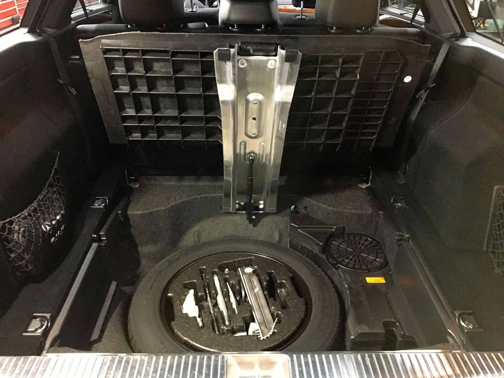

Donut housed within:
Old Jul 18, 2020 | 11:20 PM
Streamliner's Avatar
Joined: Oct 2010
Posts: 8,124
Likes: 4,352
From: Corona Del Mar, CA
Thanks very much. Might anyone have a photo of the well with the spare removed?
Absolutely perfect! Thank you SO much!

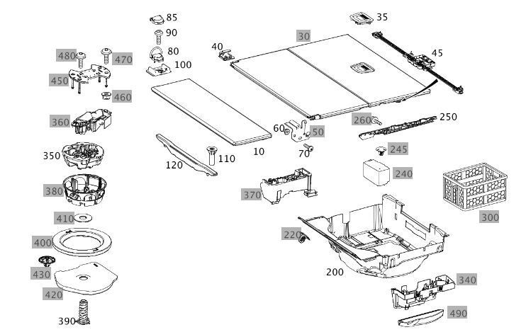

Could someone please post a picture of what's underneath the foam tool tray? Is it just the spare tire (as in my car) or are there other parts between the two? The EPC shows several parts that are supposed to go under the foam tray but that are greyed out meaning they are not applicable to my car's VIN#. I'm curious to see what others have there as my car generates a lot of rattle in this area going over rough roads or potholes.
Old Feb 24, 2021 | 11:18 AM
konigstiger's Avatar
Posts: 15,901
Likes: 4,630
From: North Scottsdale, AZ
'71 Pinto
See attachment for grayed part description/#s.
File Type: pdf
Old Feb 24, 2021 | 03:06 PM
Left Coast Geek's Avatar
Joined: Dec 2020
Posts: 2,412
Likes: 1,482
From: 122W, 37N
2016 E350 4Matic wagon, 2019 Ford Expedition, 2019 Chevy Bolt EV
I must be bored today.

Konigstiger - thanks for the parts diagram. As I stated, a whole bunch of parts below #350 (the foam tray for the tools) are greyed out. What surprised me is that part #390 (the mounting screw) is not greyed out. Yet, it is missing from my car. I don't understand the purpose of that part if the other greyed out parts are not present.
Left Coast Geek - thanks for the pictures, particularly the last picture on your post. This matches completely with my car. The question remains why the parts diagram shows the mounting screw as not greyed out.

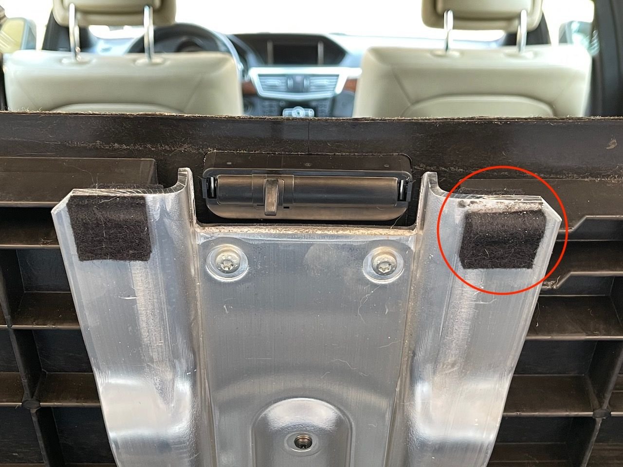

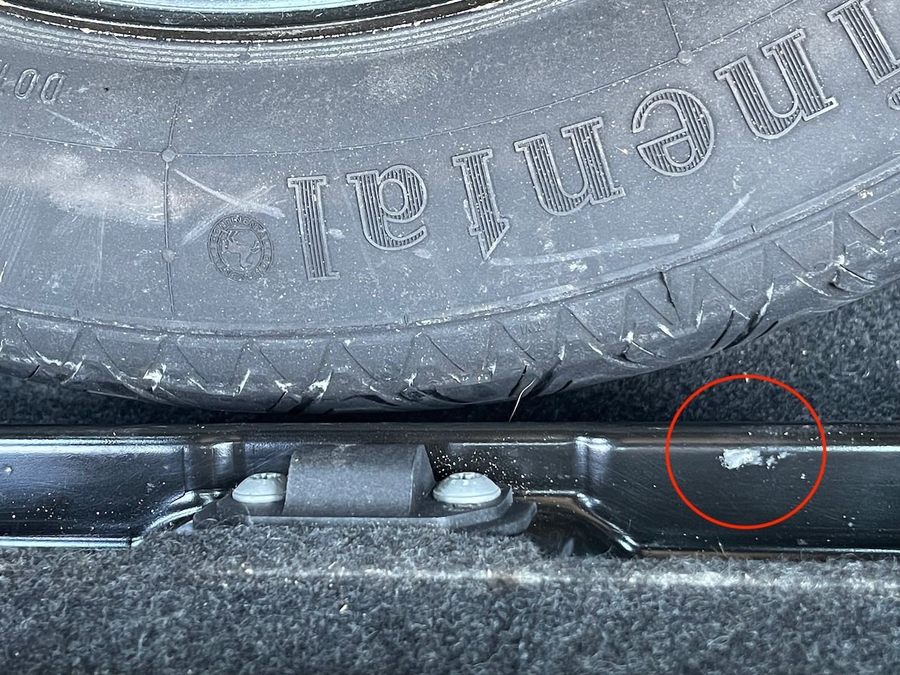

Old Mar 24, 2021 | 01:52 PM
atul's Avatar
Joined: Mar 2006
Posts: 24
2013 E350 4matic Wagon, 2002 E320S4 - E-class W210 Wagon 4-matic
Found the culprit!
Notice the foam piece off it's original position at the edge of the metal reinforcement arm (1st picture). The 2nd picture shows scratch marks on the mating painted metal section of the rear footrest where this reinforcement arm is supposed to rest and the foam is supposed to prevent metal-to-metal movement and rattle. For how the foam piece is supposed to be positioned at the end of the reinforcement arm, see the marked up area on bmwpower36m3's picture (3rd picture below).
Anyone else noticed this on their w212 wagon?
There is no part# for the foam piece in the EPC. I'll try generic foam of varying thicknesses to see what works best. Let me know if someone has a suggestion on what would work best here.
