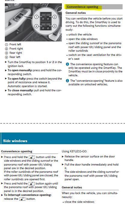

There is a convenience feature where you can open all windows and sunroof at the same time, remotely with the key fob. This has been a feature since the 90s (at least in my 140 S class). To do this, hold down the unlock button on the key fob while you’re a few feet away from the vehicle. All windows and sunroof will open. To close, hold down the lock button.
You may have accidentally held down the unlock button with the key in your pocket, squeezed by other keys or objects. This happened to me once while I was squatting (pants stretched over thigh where I keep keys) and the pressure from the objects/keys in my pocket pushed the unlock button and held it down.
Strange as in my to cars the convenience opening works only if I'm close enough to the car and aim the end of the key FOB to the small square "window" in the driver's door handle.It will not work if key is in the pocket.
I think it is IR beam and must have clear path from key FOB to the receiver on the door handle.

Correct, the "convenience opening" feature is only available thru IR transmission, all other functions of the remote are RF.

This information is incorrect. For at least MY 2014, with keyless go, there is no IR. You simply need to be nearby with the key detected, hold down the unlock button and the opening sequence begins.
And yes, I did just test this while I was standing at the hood of the car, with the key in my pocket.
