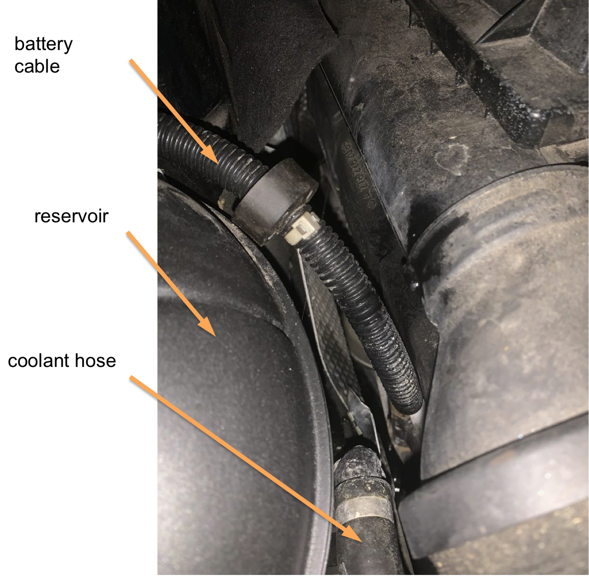

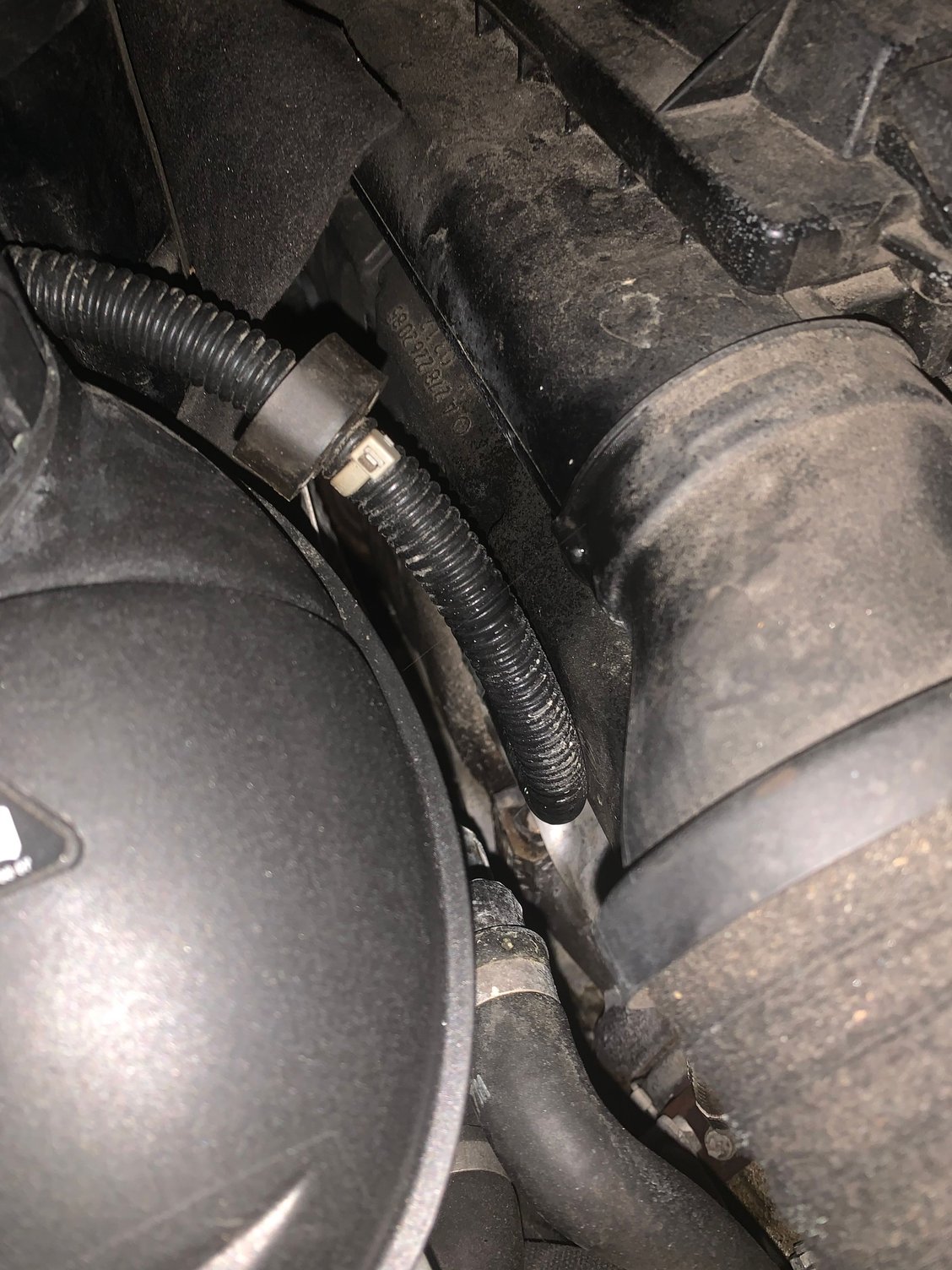

It's the same Hose that is in the picture and in the video leak for this thread. I mean it's doing exactly the same thing. it looks like a fine pin whole leaking coolant out of the hose dripping on the engine. the dealership told me it was a oil leak cause smoke but you can clearly see the coolant dripping from the hose. VIN# WDDKJ7DB9EF243343

To me the video shows a leak from the reservoir, maybe a tiny split in the seam between the upper (black) and lower (opaque) halves.

No, each part is separate. I made a mistake thinking it was the hose between the reservoir and radiator, when you mentioned hose. What do suspect is leaking?
If its the coolant hose in the photo above, I can't say for sure since I don't have a M278. A wider angle photo would help with where the hose connects on either end. I'm thinking it runs back to the heater core.

so this is line that I mention before. Just like the leak video in this thread. Its leaking coolant right from this line not sure what it's called as far as the part.

That line goes to the pre-fuse box, positive jump point circled in yellow, right? That’s your battery positive cable, so it can’t be leaking coolant. Unless the corrugated sleeve is filling with coolant from somewhere else and leaking out where your pointing to.
Take a better look... make sure coolant reservoir is filled to correct height, warm up engine, while engine is running open hood and check for leaks in the area.

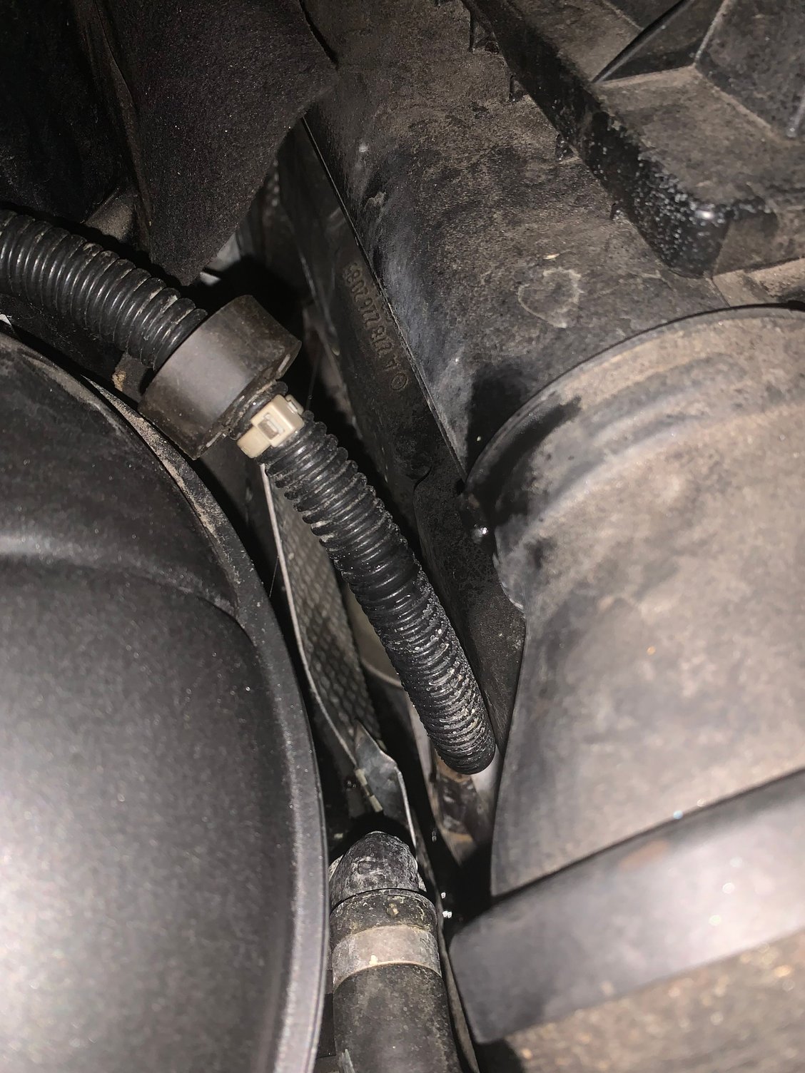

Based on your pictures you definitely have a reservoir leak and MB pressure test not showing this is a bit of a mystery. The test is with 17 psi to see if the system holds pressure. I don't know how long they test. I just happened to do the test myself and my system held 17 psi for two hours so I think it is ok but perhaps the pressure in the system is higher during engine fully warmed up? Or is that 17 psi just below the pressure the reservoir cap springs relieves the pressure?
Anyway, if you see some residual in the cap it means the reservoir filled up all the way with hot engine and the relief valve on the cap let some coolant out. This is proper function for over filled cooling system.
