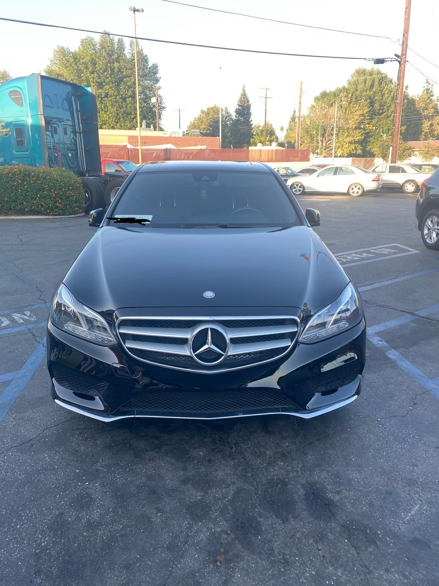

Hi everyone!
I have a black 2016 e350 sport sedan, limo tint windows front and back and the currently stock chrome rims.... What type of rims look good on this car/what color? What other things can I do to make it look dope?

OP has standard LED lights, like mine. The ILS mod will not work on these.

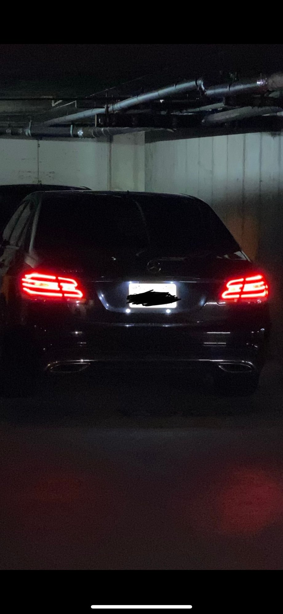

Congrats on the new acquisition!
As for wheel selection and other mods to affect the dope factor, it is all personal preference. Personally, on my MY2016 I went with BRABUS suspension and wheels, trunk spoiler, AMG rear valance and exhaust tips and left it at that. An unseen contributor to the dope factor on mine that it almost imperceptible is an Escort Max 360ci system.
as for the ILS upgrade, I'm 1 year and hundreds of dollars into the project and still not done - I wouldn't recommend it.

Where you get that rear diffuser? looks really nice.

I bought it at my local Mercedes dealership and had it custom painted

oh nice. Got a part # by any chance?

It's about a dozen parts to put it all together. From what I remember:
AMG Diffuser
Diffuser trim (3 pieces)
Diffuser hole covers (2 pieces)
Tow hook cover bracket
Tow hook cover
Diffuser support bracket
Exhaust tip brackets (2 pieces)
AMG exhaust tips (2 pieces)
A few rivets
I'll look around for my parts list. If I find it, I'll update the post.

And roughly what was your total conversion cost?

Roughly around $1,200 USD - that's because my son-in-law gets me employee pricing and I found a great deal on the exhaust tips used. Otherwise that would have been the cost of the exhaust tips alone

Looks really nice. Great execution in making the change.

Here's the parts list to upgrade the rear diffuser:
AMG Diffuser
part no.
212-885-31-38 ($157.00)
Diffuser trim (3 pieces) - these are for the black trim. I don't have the part numbers for the chrome version
Right part no.
212-885-54-21 ($102.00)
Left part no. 212-885-53-21 ($99.00)
Center part no. 212-885-50-21 ($100.00)
Diffuser hole covers - "cap" (2 pieces)
Left part no. 212-885-11-24 ($9.00)
Right part no.
212-885-12-24 ($8.00)
Tow hook cover lower bracket
part no.
212-885-02-56 ($7.50)
Tow hook cover
part no.
212-885-09-26 ($50.00)
part no.
212-885-66-14 ($53.00)
Left part no. 212-885-67-14 ($35.00)
Right part no. 212-885-68-14 ($35.00)
AMG exhaust tips (2 pieces) - I don't have part numbers and IIRC, they're in the neighborhood of $350-500/ea
However I believe these are the part numbers - confirm before you buy
Left part no. 231-490-01-27
Right part no. 231-490-02-27
Rivets (3) part no. 003-990-94-97 ($4/ea)

Love the look of the rear. How did you install the diffuser? I'm trying to get an rwcarbon diffuser for my w212 as well.
