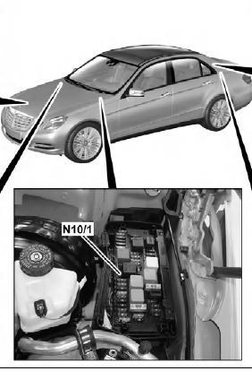

Before disconnecting battery try pulling f11 (COMAND display + control panel) & f26 (COMAND unit/radio) @ front fuse panel (engine compartment) for about 10 minutes or so.
Thanks for this suggestion. Is the location of the fuse panel located in the manual? Sounds like it is in the engine compartment somewhere. I have never played around with the fuses.

Remove cover:

I removed the two fuses for a little more than 10 minutes then reinserted them. The function buttons still no longer work. As this "fixed" itself before and the buttons were reacting but wrongly before completely failing, I have to believe this is a software problem somewhere and not a hardware problem.
