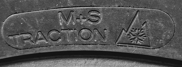

rather, its conditions R1 and R2 that exempt AWD with M+S rated tires. Calfiornia Road Controls are...
  • R1: Chains are required – snow tread tires allowed.
  • R2: Chains are required on all vehicles except four wheel drive vehicles with snow tires on all four wheels.
  • R3: Chains are required – all vehicles – no exceptions (almost always, highways are closed before you get R3)
and 'snow tires' implies M+S rated, although 3PMSF (3 Peak Mountain Snow Flake) are highly advisable (and I do note the All Season "MO" Contis on my 4Matic are M+S but not 3PMSF).
3PMSF refers to this icon on the tire sidewall...
huh. for my 17" Luxury 4Matic, there's *ONE* tire in the 'grand touring all season' category at Tirerack.com which is 3PMSF rated, a Vredestein Quatrac Pro 245/45R17 XL
ditto for the 18" size on 'sports' E350's...
Yes, always count on California for regulations, my Conti DWS06 has that snowflake and works out ok in the summers too.

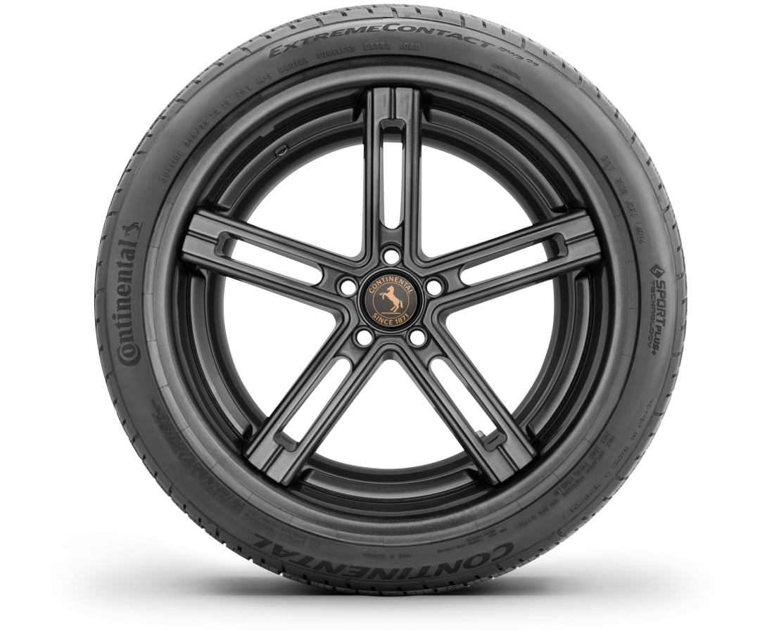

there aren't THAT many places in the country that get as much snow on a major interstate overnight as I80 over Donner Pass can get. Donner is like 7000 feet, and surrounded by 10000 foot mountains, and gets an average of 35 feet of snow/year, and some years as much as 70 feet that and very high traffic volumes of people who live where it never snows. its also heavy dense snow, and this is only about 60 miles up I80 from where it rarely snows.
and huh, tirerack does list the Continental DWS06 in my size, but does NOT say it is 3PMSF rated. Literally the ONLY all season they list with 3PMSF is that Vredestein.
Continental makes 4 tires that are 3PMSF so do many others, in your size. The DWS06 is 3PMSF.
Yes, I spent an hour or so one day watching you guys drive up this very pass, LMAO.
huh, https://www.continentaltire.com/prod...-24545zr17-99y says nothing about 3pmsf, and the side view, enlarged, I see M+S but no 3PMSF icon.
Try harder, LOL.
https://www.continentaltire.com/cust..._api_relevance ? still coming up blank.
at 6:30, that triangle is the ⚠️ caution symbol on the usual warnings...
Hmm, mine don't say" Sport Plus" either, and the reference to the caution symbol was uncalled for, I will send pictures of my DWS with the mountain and snowflake tomorrow... Maybe.
I'm not understanding your issue - do you ski? A lot? If so you know that once CalTrans has determined the snow rate is more than they can plow, and lead groups of cars single file (With chains on the drive axle or 4wd with at least M&S) over the pass. They shut it down. I've never seen them use R2 or R3. And there used to be a level 4, which was 4x4 with chains on all 4... And they never used that either...
So you can get over the summit in your 4Matic with M&S Conti's, or the road is closed. But I didn't think you were asking that Q... My impression was the driveways or other roads that had actual ice on them. Studded tires, or chains are the only reliable way to safely get through that...

well, I've been on snowy roads in remote places with 3PMSF tires (on a Tacoma 4x4 w/ BF G KO2's) and they were nearly as good as dedicated snows. AND I put like 25000 miles on those tires on pavement dry and wet, and they were excellent all around tires. older KO2's that weren't 3PMSF were just as good on dry and wet and dirt, but not as good on snow, in the same vehicle.
but yeah, its mostly curiosity on my part. was just kind of surprised almost none of the all season M+S rated tires for the E350 had the 3PMSF rating too.
re: pictures of your tire, you might try and find the tire model number, its like 15499710000 or something (thats a 245/45r17 99Y DWS06 current version). tires change without changing their branding, it can get downright confusing.

I think, where we think alike... is in Geek-dom... We over think things, often... Go see your son, any, time of the year... Your 4Matic will keep you on the road...
The Extreme Conti Contacs .... Rock IMHO, in most all conditions...

So you were partly correct, apparently Continental dropped the snowflake with the DWS06 and it is just M&S rated. My mistake, I assumed as I bought the new DWS06 it was rated the same as the old DWS.
