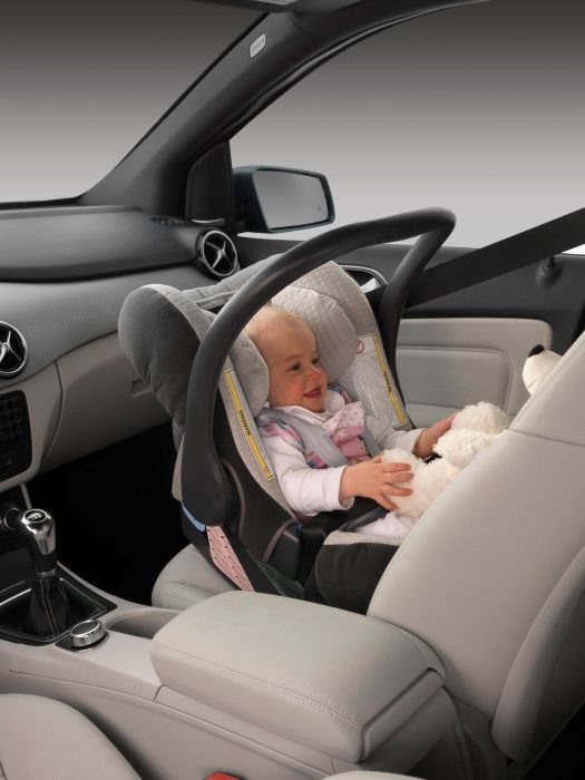

I can only see installations of rear facing seats in Mercedes cars in the front passenger seat or the rear outboard seats. I agree with bmwpower that these are the tested and recommended locations. Thus no latch in the center. I think the issue is also there is no seat back concave in the center to allow room for the child’s feet as they may project from the seat. The normal seats will have more room available. I have changed my opinion about using the center seat.
