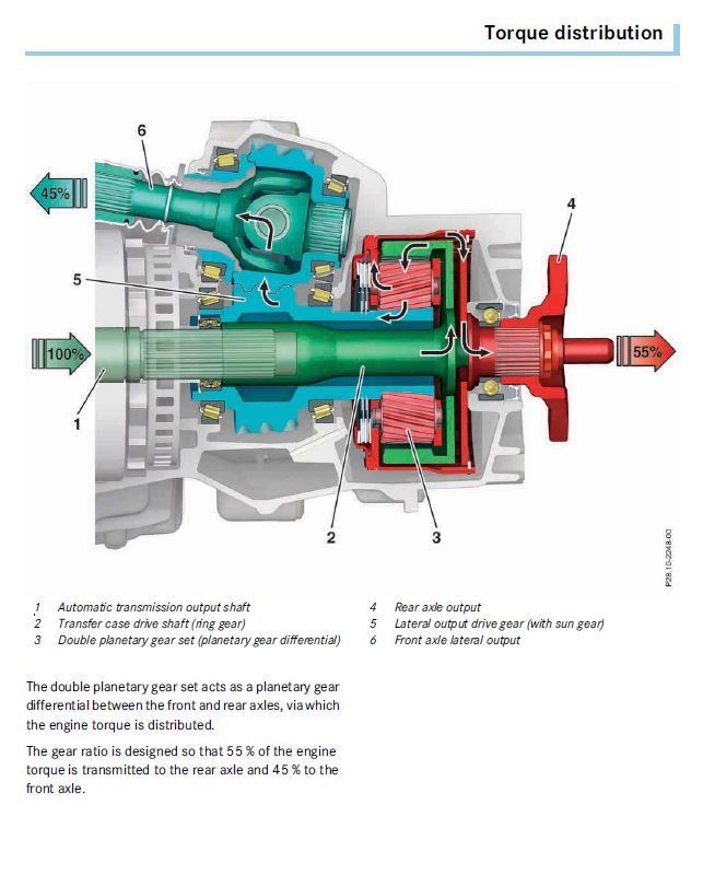

do these cars have a center differential? I suppose they have to since they are always in AWD.
and I've read they have a fixed 45-55% torque distribution, wondering how that's achieved mechanically with a simple differential ? I thought diffs were pretty much 50-50 unless there is either a gear ratio difference, or a friction element to limit output. From what all I've gatherred so far, these 4Matic systems use the ESP via the wheel brakes to control slippage.

yeah, its the torque distribution I'm not getting. I know how its done on dynamic systems that use clutches or brakes, but this isn't a dynamic system at the differential level. I keep reading articles that describe what torque vectoring or distribution IS, but none explain HOW its done.

ah, I just noticed, there IS a clutch (8) in there.

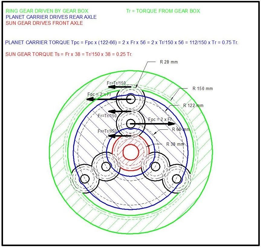

I made a major assumption that the shaft from gear box drives the ring gear in this planetary system that is used as the differential. Reason for this assumption is that there are double planetary gears, which are needed as without it would make front or rear axle go opposite direction.
The torque between axles is set with the diameter difference between the ring gear and the sun gear. I made the two drawings to explain. Hope they help to understand how it works.

Nice job Arrie!

so that stilll outputs the same RPM but with different amounts of torque? that was the part I didn't get... increasing the output shaft RPM lowers the torque but if you compensate for that with a different final drive ratio, then you bring the torque at the wheel right back to where it was.

The way this planetary gear arrangement works is that as long as both front and rear axles go with the same speed the whole differential assembly turns as one body. This means that during normal straight driving it is pretty still but when you make turns this arrangement allows for speed difference between axles.
then there is that multi disk lock that allows one axle to move the car when the other is in slippery surface.

Excellent drawing!
Where did you get the dimensional information?

Dimensions are not real. Just for example.

so now we need someone who can get their hands on a blown 7G 4M to crack it open, and take LOTS of photos and measurements of the transfer case mechanism

ahh, I poked around in my new WIS looking for that sort of thing and didn't find this,b ut of course, I was looking for 212.288 related stuffs.
and hah, my picture that I pasteda bove is from page 10 of the firrst of those docs...

Ok maybe this is standard for those in the gearbox industry, but to me its pretty clever.
Having said that trying to figure out which bearings are prone to failure. I think it is one of the main tapered roller bearings. Then the next question is why? Is it simply undersized for the thrust loads?

The picture does not show all details but there seems to be a chance for a serious design flaw with this. The mesh from sun gear to the front axle seems quite robust with conical bearings. Of course, I don't know what size those bearing are and what magnitude axial forces they need to carry. But what does not seem right to me is the ball bearing at the far end of the transfer case. The planet carrier (red) does not carry axial force as the helical gear mesh forces cancel them out but what carries the axial force of the ring gear (green)?
The shaft for the ring gear seems to be just a spline fit over the gear box output shaft in the left end. It does nor show bearing for the other end and this is normally not used as the three planetary gears will center it but where does it carry the axial force that is generated between the ring gear and the outer planetary gear? If there is a thrust bearing inside the output shaft where the planet carrier seems to go inside of it then the axial force is carried by that ball bearing at the right side end of the transfer case. Ball bearings do carry axial forces but they are really not meant to be used for that.

There is not axial load on that bearing. There is barely any load on it. The gear goes one the output shaft from the tranny and planetary gears go over it. So that load sit on transmission output shaft. The ball bearing at the end is just there to provide additional support when shaft is connected IMO. Im not engineer. That bearing was like new but WIS says to replace when taking apart. Cheap insurance I guess.
What goes are the roller bearings. I think the warm style gears put too much twisting force on the roller bearing and ATF lubrication is probably not the best for this. Proper diffs use gear oil and not ATF. Again MB probably tested this and found good enough for 100k miles after which point they don't really care.

L1 thru L4 are the tapered bearings which fail

L3 in my case....the last one to get fresh fluid.

The 4Matic W221 describes the oil path... when stationary and underway, in both cases the oil enters the L3 / L4 area first. Maybe their desire to reduce windage and increase efficiency, by keeping a small "effective" sump, leads to poor lubrication. Another consideration, is the flow rate is only 100 ml/min into the transfer case and the max capacity is 700 ml. So the fluid is exchanged once every 7 minutes... is that causing build-up of local heat and leading to wear.
