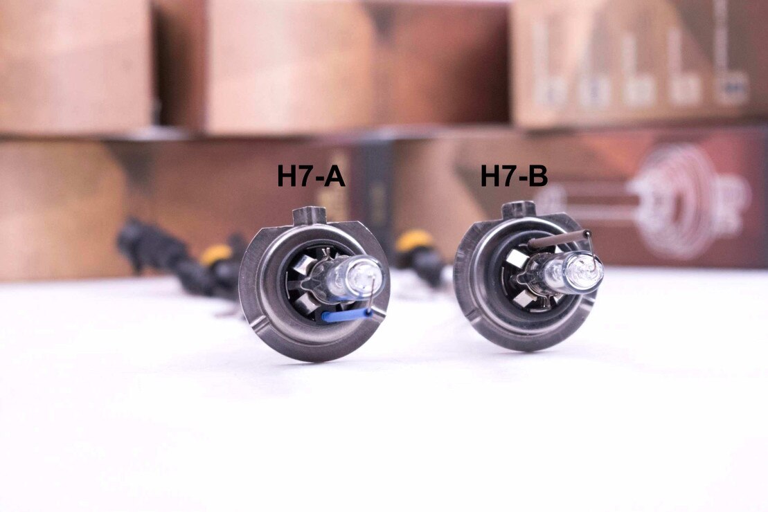

I'll give actual experience from my HID install into my E350 back in 2015....
I've done full projector retrofits on other vehicles using E55 and RetrofitResource mini projectors and I would not install HID into any non-projector housing. I found that the E350 projectors used for the P1 halogens appear to the same as those in the P2 (xenon) package. There was no need to change anything about the factory headlight assemblies. My Morimoto kit came from RetrofitResource (no affiliation) and has been bulletproof since the installation. The only issue I found was a pinched ground wire inside the left assembly, nothing to do with the HID kit. The installed kit is a 35W with CANBUS connectors, ballasts and ignitors. In this case a separate relay harness wasn't used nor has been needed in these past almost 6 years. Bulbs are also Morimoto brand (5.5k) and are still the same as initially installed. I did get a set of U-shape bulb clips to go around the new bulb harnesses. Everything is outside of the headlight housing which I prefer to avoid adding more heat inside of it. Just be sure to add some padding to avoid rattles.
Bi-xenon is where the bulb does double duty for both low and high beam, using a movable shutter in front of the bulb to direct lighting. Xenon is a standard low beam only bulb.
Some comments:
- Key considerations are light pattern, cutoff and beam spread. The Morimoto bulbs are very good quality and are oriented properly so that the light pattern is even within the projector. Cut-off is virtually the same as oem projectors with an even "stepped" line that directs light downward from curb to road crown as it needs to be for US (right side) driving. Light doesn't blind oncoming traffic yet helps illuminate curb side of the vehicle.
- the Kelvin rating of 5.5 to 6 for all practical purposes is a clean white light, a huge improvement from the oem halogen bulbs.
- customer service from TRS has been very good for any questions on this or other installs where I used their kit, and there's a decent warranty on the components. I also believe from actual use that the components are very good quality.
- I left the oem halogen high beam bulbs in place, I hardly ever use them and don't really worry about them.
- not once, ever, has an opposite vehicle flashed me when I've had the low beams (HID) on. But this is not unexpected because of the above-mentioned proper light spread and especially the light cutoff.
- I removed both sides front section of the wheelwells to make life easier and to do a more thorough installation.
- All bulbs deteriorate slowly with age but the only reason I'd replace the current bulbs would be curiosity or boredom as I don't really have complaints about the lighting level. I'm older and it helps me considerably to actually see what's in front of the car.
- I used the proper CANBUS (shielded) connectors with the kit to ensure that no "bulb out" warnings came up and also to avoid wiring in a separate resistor that is usually not insulated and gets very hot.
Lots of opinions about HID kits and installs, so my intent is not get into that debate. What I can say based on experience and observation is that this has been one of the best and most consistent improvements I've done on this car. Worth every penny. I'll never even consider going back to the original halogen setup.

Thank you for this post. I have purchased basically the same kit you bought with 5K bulbs and a newer generation of Morimoto ballasts (possibly smaller). I made the right guess, apparently, on the H7 bulb (the "A" type). I won't be able to install mine until the spring but I intend to do it after taking the front bumper cover and wheel well plastic off for other reasons (broken lower grille). I want a clean and totally rattle free install; I HOPE to make/install brackets or some kind of sheet metal structure to bolt somewhere for all of these loose parts - I also think throwing it all into the housing is a very bad idea.
Were these the options you selected?
Chris
Smart move. The beam pattern on the high beams seems less suited to my Morimoto kit for some reason *and* there is a brief delay when hitting the high beams.

I've upgraded 3 different halogen equipped cars with LEDs from www.auxito.com with very good results. I used the suitable 12000 LM 6500k bulbs, got excellent low beam patterns and plenty of high beam. They have worked well in both reflector buckets, and projector lamps. Depending on the lamp type used by your car, these are $50-65 a pair.
I'm looking to replace my factory halogens with Xenon HID on my 2013 E350. But while an installer says that he can do it with the right kit he sells, without replacing housing ($475 parts + labor), the MB dealership Parts person tells me that I cannot upgrade this period. Too many modifications required. Just buy a light bulb for $18. Not sure who to believe. Advice?
