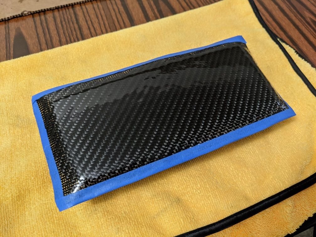

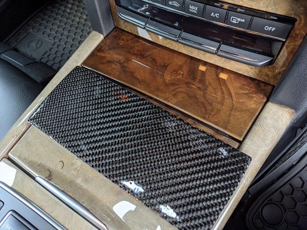

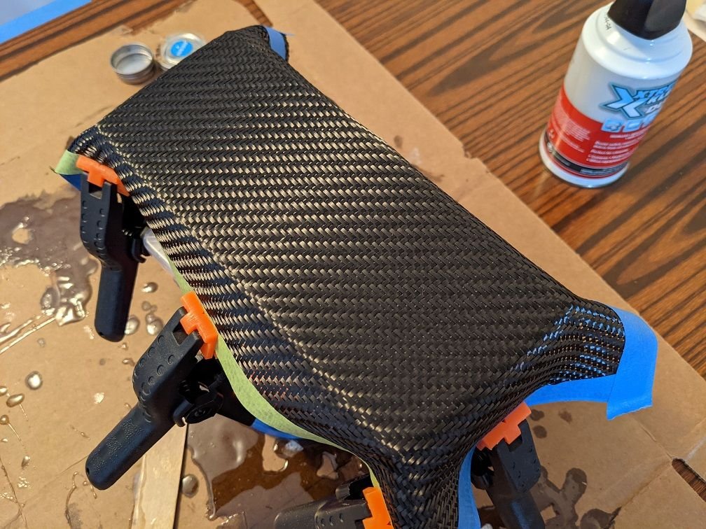

COVID had gave me infinity amount of time at home so I can finally start my long await project of replacing the faded trim.
First piece 80% done, a lot of high and low spot soo still need a good surface correction, polish and UV resistant coating, but I'm starting to get an idea on how it will looks at the end.
If anyone want to do the same, put in mind that it's extremely time consuming if done right, it's not for the faint of heart.
You need to budget about 5-6 hours each piece. (post facelift W212 has 11 wood trim, pre-facelift has 18!!!)
I'm not talking about "apply epoxy, wait 4 hours" something like that, I'm talking about 6 hours of constant labor, and 5-7 days total time form start to finish for each trim piece.
Total cost of material is around $400, tools around $50-70, if you're getting a full set of trim from scrap yard that's another $250-400.
I'm hopping to post the full finish interior when everything is said and done. Stay turn.
