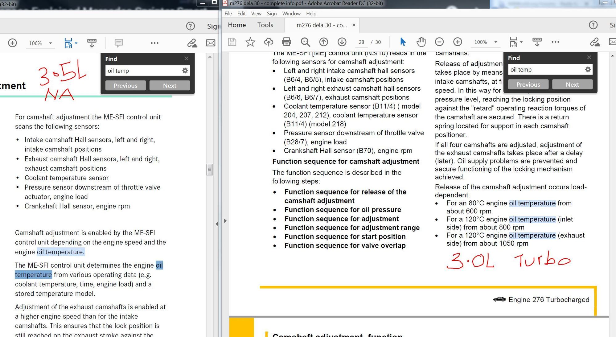

Where is the oil temperature sensor actually located on M276 3.5L N/A ?
I can't find it in EPC. Is the oil level sensor also an oil temp sensor combo ?
I sure hope my 3.0 TT M276 has the same oil temp sensor or whatever combo it may be, but I can't find it in EPC or in WIS.

This statement on the variable timing info, M276 3.0L Turbo, would and should be the same for M276 3.5L NA since it also has the variable timing.
Yes, I am still chasing this engine oil temperature ...
Too bad is is a SIMULATED data based on 3.5L NA document.
Probably the same for my 3.0 turbo
OMG... even the oil temperature is calculated by software instead of measured with a 50¢ sensor 🤣
