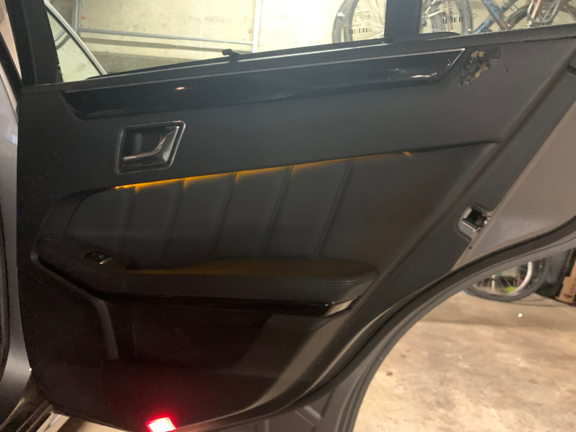

My new to me E350 wagon had one of the door cards chewed by the dog of the previous owner. I found a replacement black panel on eBay but the leather insert is grey. Can I swap them out with mine in black? Does anyone know if the leather inserts are indeed detachable as the trim is?
thanks
My panel with a chewed corner

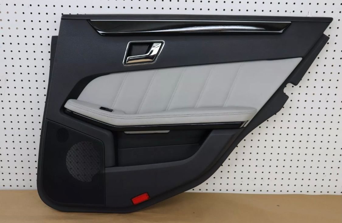

thanks for the part Nr. I made a quick search on eBay and nothing is available. I might wait a bit longer. Do you have a part Nr for the driver side rear seatbelt? That one was attached by the dog too 😒

indeed. I got the grey leather one, it has sunshade and will experiment and hack it. Let’s see if I can make it fit

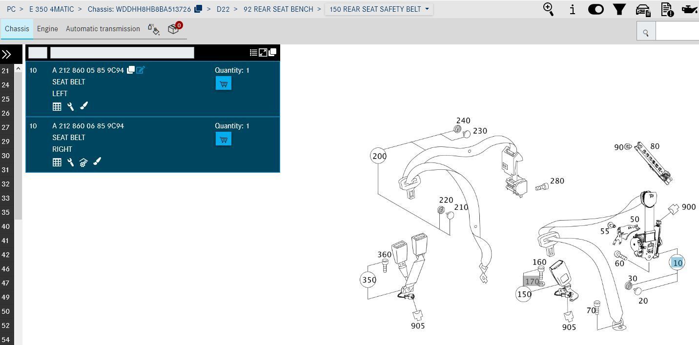

the seatbelt part Nr you quoted is 212 860 0565.
I found a bunch of replacement seatbelts out of Europe that have part Nr 212 860 5985.
do you guys know if those are interchangeable and what is the difference?
Old Mar 15, 2021 | 01:11 PM
konigstiger's Avatar
Posts: 15,901
Likes: 4,630
From: North Scottsdale, AZ
'71 Pinto
Don't know the difference but correct part #s for your VIN/model are shown in post 9 above: left 2128600585, right 2128600685.

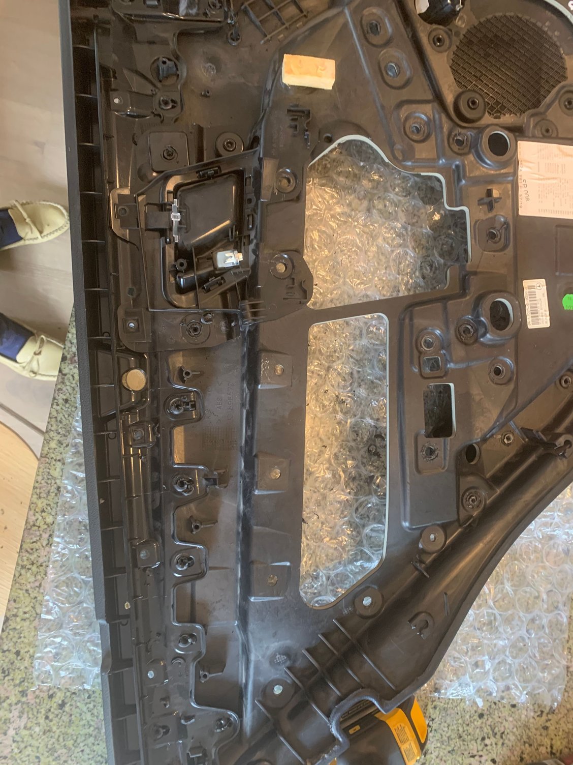

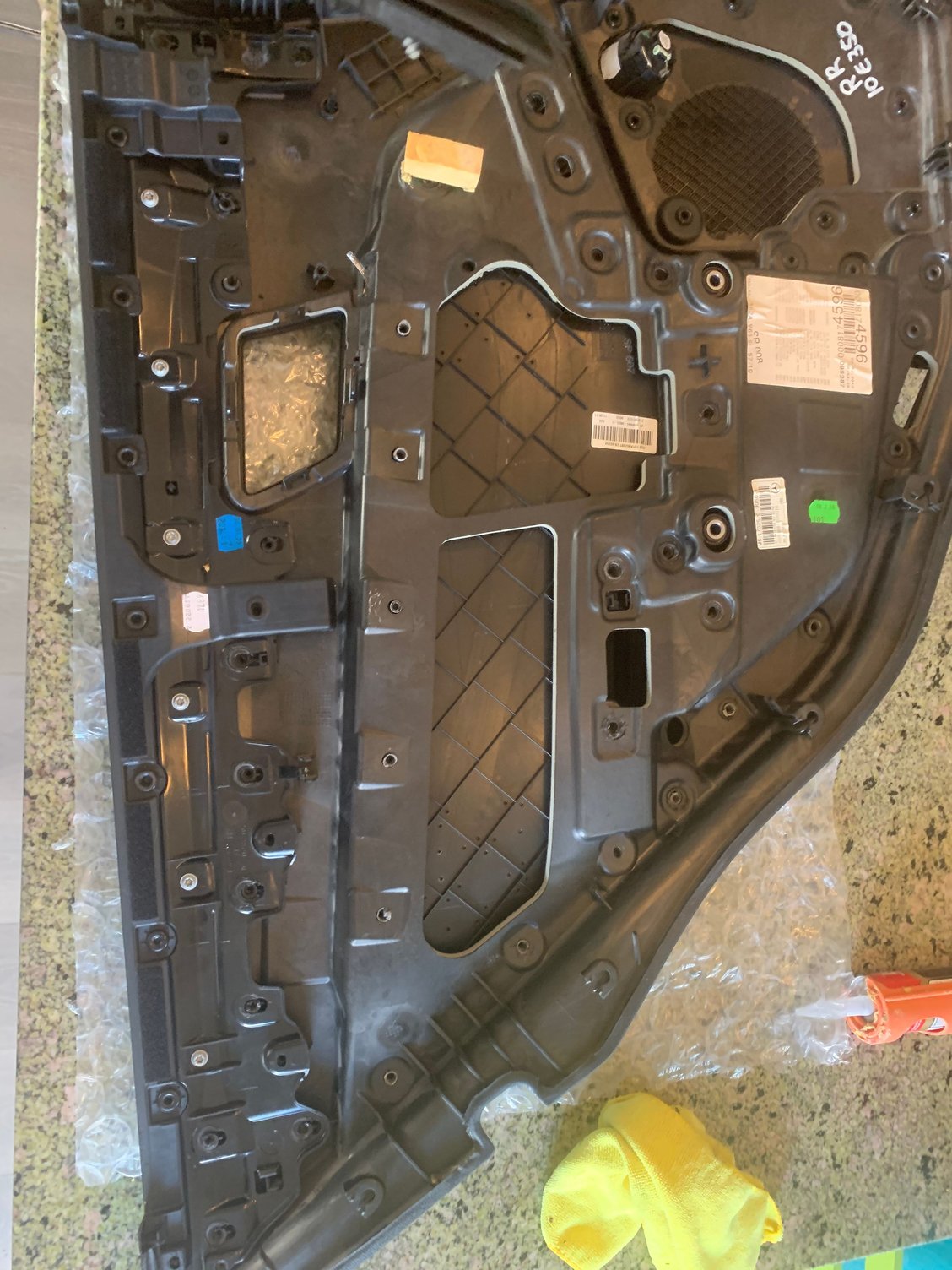

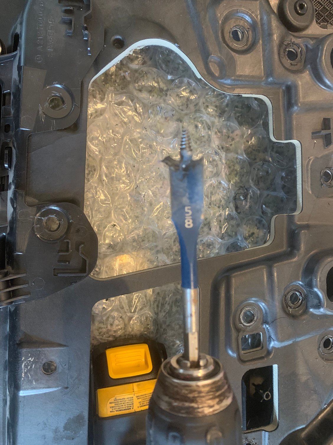

A couple of hours today dedicated to the car, I replaced the chewed seatbelt (part nr A2128605985 is a perfect fit for the wagon) and the door card. Unfortunately the eBay seller shipped out the wrong one so I had a bit more work to do to make it fit. I drilled out the plastic rivets and replaced the leather inserts and the upper trim for the roller blind. 30min of work and got it done. I used a drill for the rivets and then glued them back with construction adhesive.
