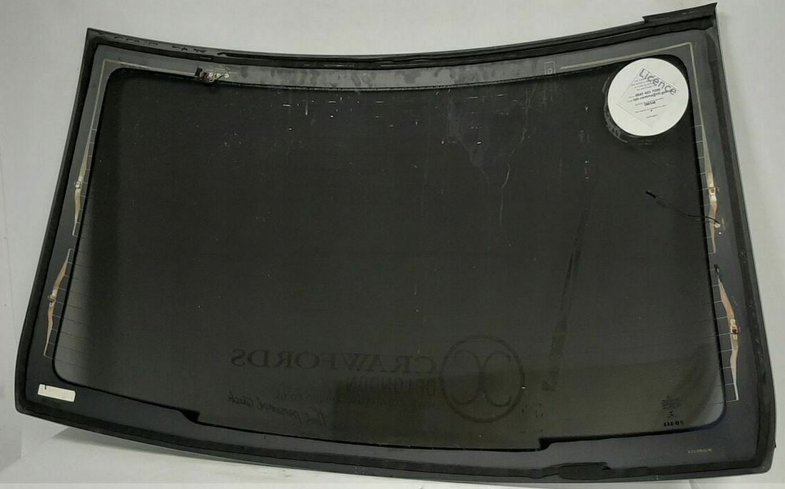

I think heating wires are towards the inside to remove fog on inside first and then eventually it keeps going to melt what is outside...
Normally you see is defog or frost where the lines are first... so it has a real defined shape.
But to check find wire connection and check resistance.= and then power from wires
I am sure koenstigggy has a pdf of how many ohms it should be....

Close inspection shows no visible damage to any of the wires along the rear glass. But the pattern that you refer to and that I'm used to seeing in every car I've ever had - nope, does not appear in this one. It simply slowly defrosts from the outside edges inward.
Thing is, I can't remember ever noticing this before so who knows if it has always been that way. I doubt I bother fixing this if it will require replacement of the window.

I had to get the rear hatch window replaced on my wagon because the heating element had failed and it's part of the window. The bronze lines were practically gone, barely visible.

Reads to me that it is not working at all. You should see the lines visible if working... clearing from the edges is just cabin temp defrosting as you've observed.
I've had rear window tinting on every car I've owned since 1985. Rear window tinting covering the defroster grid plays no role in it at all, unless a tint installer cut one of the leads, or pulled the grid loose in removing the tint...

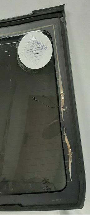

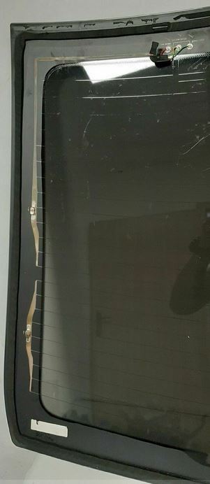

I might start with the connections for power, I believe they use water or washer fluid to install the tint, having been done twice and removed once, there might be a chance that the connectors got corroded slightly.

There is no visible damage at all on my car. I went over the rear window and I don't see so much as a scratch on any of the wires/lines.
Guess I'll have to have this diagnosed, and then I'll go to the tint shop.

I still wonder if one of the wire connections is corroded. I do not mean in the glass but in the trunk at the wiring harness connections, I also did not mean to indicate that the tinting itself was involved at all, just that the installation and removal may have used enough liquid to corrode the connections to the wiring harness.

i've fixed a few rear window defroster grids on older cars when a few lines were broken via a kit youi can buy at a local auto part store. the kit is basically a tiny bottle of conductive silver paint, and some special masking tape, and another paint to put over the first once it dries. you need to carefully inspect the broken wire and find where its broken, then very carefully sand off the insulation paint for about 1/4" in each side, lay down the masking tape, paint the silver paint, let it dry, then paint hte insulation paint and remove the mask. repeat this for each broken 'wire'.
but if the whole grid is damaged by removing old tint, or whatever, its probably too much to fix this way. I fixed 4 'wires' on an old Volvo wagon this way, I wouldn't want to have to fix 20+ spots.. In the case of my old wagon, a new rear window was NLA, so its the junkyard for another one, or fix what you have.

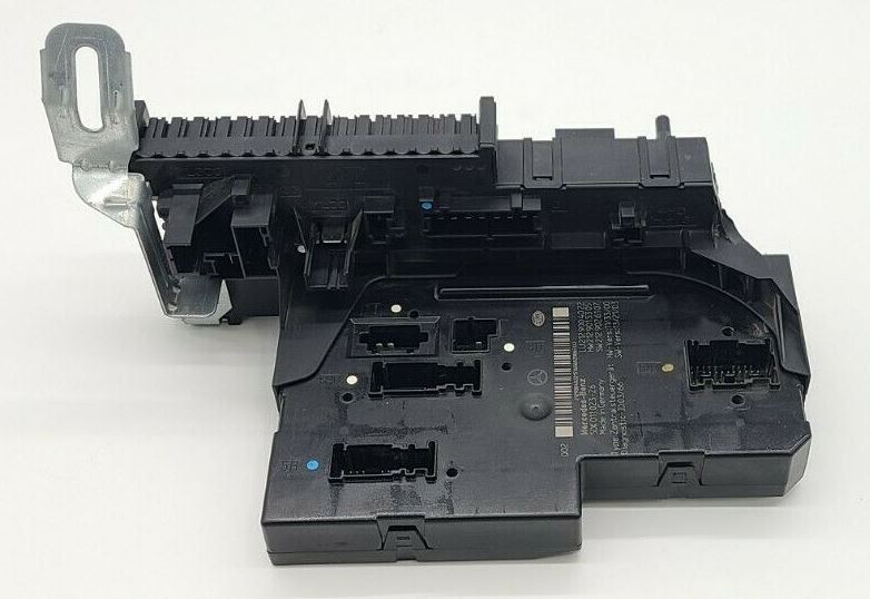

Things to check: f49 (40A), C relay, and connections @ trunk fuse panel. Could be relay however, on occasion wiring, connector (check all connections), and pins may melt due to corrosion and sometimes amperage. Here are photos of window connections should you decide to inspect.
File Type: pdf
File Type: pdf
File Type: pdf

Relay is good, fuse is good, voltage drop does happen. Rear defrost does not function.
Not good enough to disassemble anything further. I will ask dealer to evaluate @ 50K service but if not covered under CPO, not sure I'll repair it at all.
