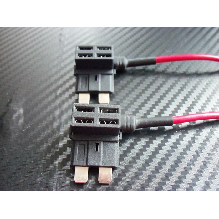

Later I will get this type of fuse jumper
I will then able to measure what is the loaded voltage of the ECM fuse #27 while ECO algo doing its battery drain.
If at #27 fuse the voltage does indeed showed as low as ECM voltage via OBD2, something is wrong at power PCB copper trace maybe.
No way in hell a 6mm cable can drop a voltage that much while loaded only at 5-6 amps load.
If fuse #27 showed higher voltage ( it should ) than ECM voltage via OBD2, that is EXTRA HOMEWORK for me . I then need to mess with ECM wire assy , that I want to avoid.

Yes, surely I will measure F27 voltage output, hence I need that fuse jumper,otherwise it is not safe to cruise and log that voltage.
The fact I need to find out is, how much voltage drop each connection from MR6>>F27>>ECM under heavy and long discharge using my own DMM.
It would be nice if I can back probe the ECM connector power wire from that F27 fuse, but it is a BIG risk if car is moving.
So until I can find a safe way to measure power input voltage at ECM connector while car is cruising, I have to assume OBD2 Control Module voltage is accurately representing ECM working voltage.
