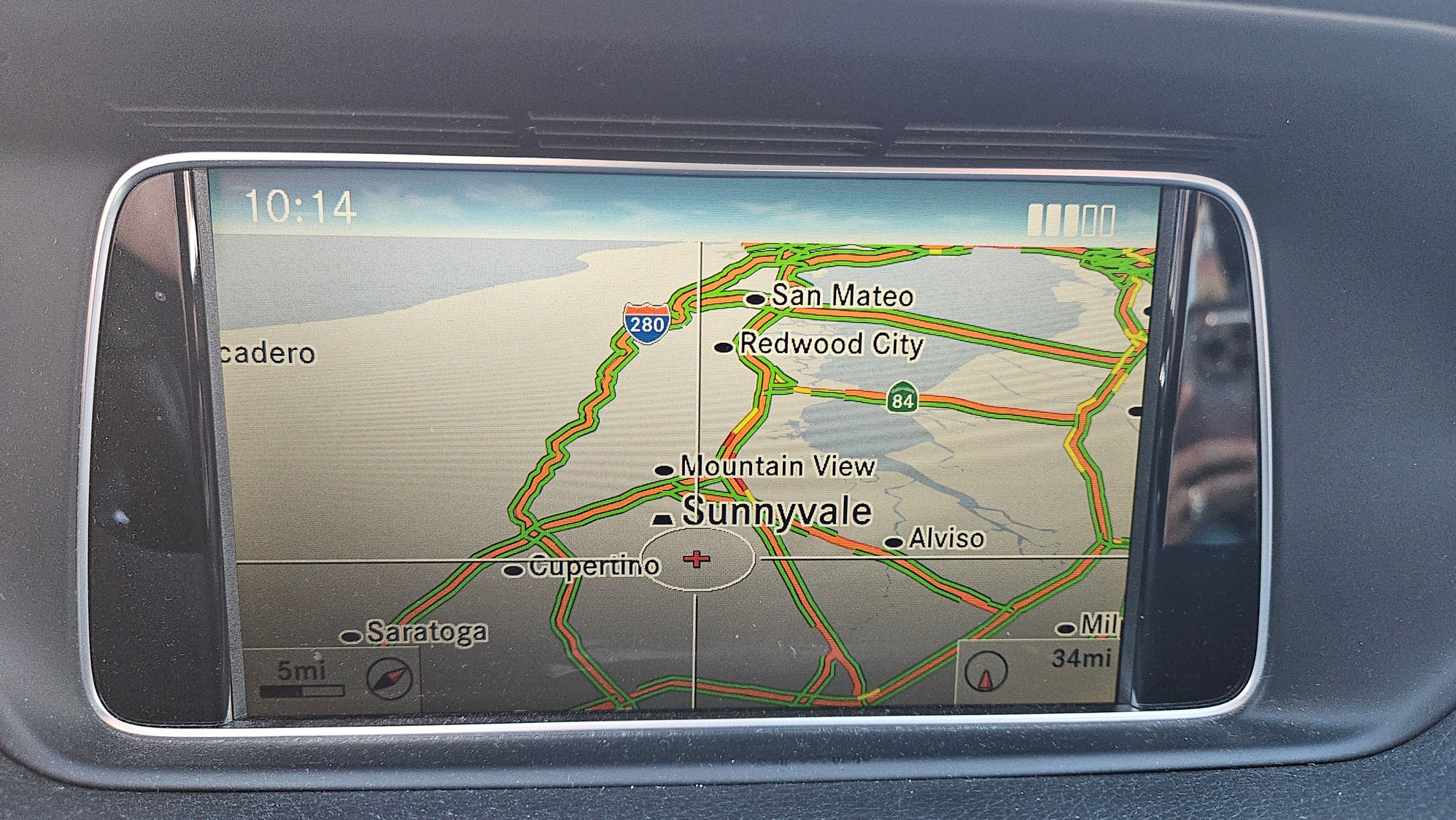

SAT NAV ACTIVE
NAV traffic got self-activated
red green yellow live traffic markers
red + green + yellow traffic markers are active
I was away nearly a month and upon return traffic came on... I'll take free live traffic assist.
I haven't tried the XM audio to see if it's open as well.
