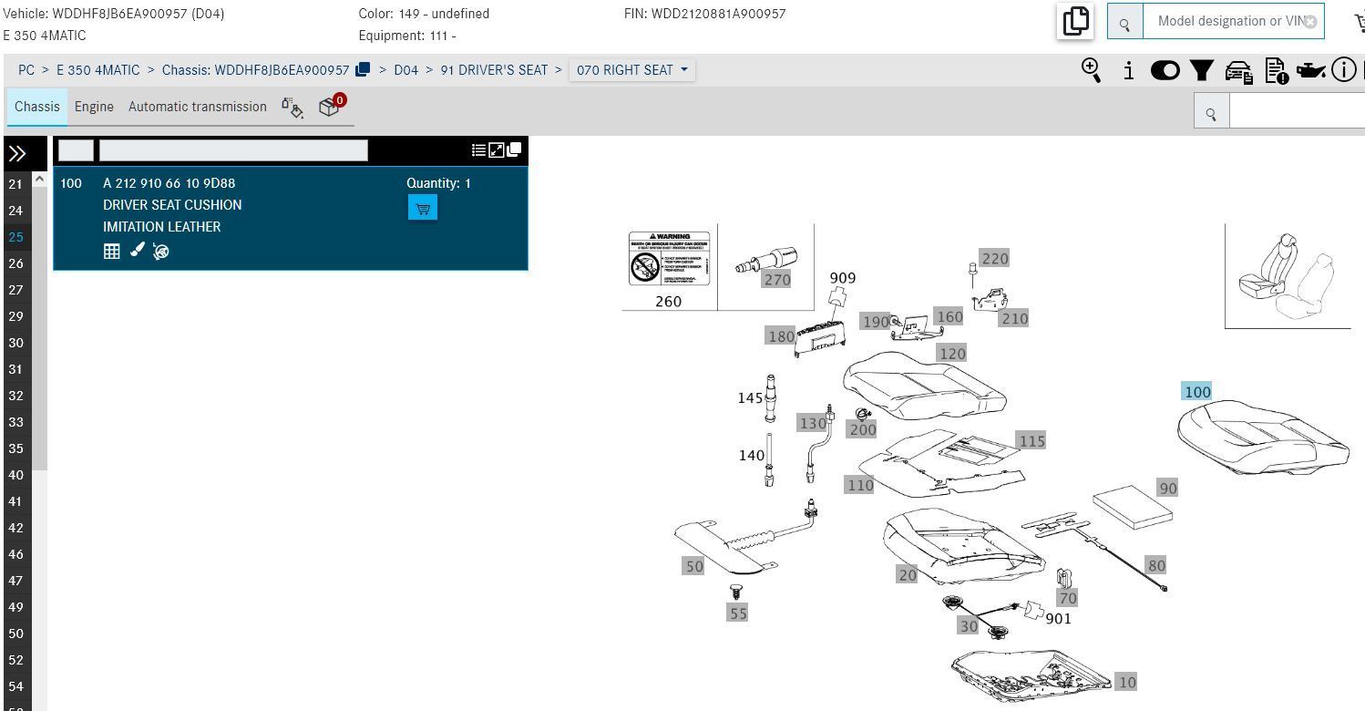

I know this has been discussed to death, but after over an hour of searching I can't seem to find what I need.
My passenger's seat bottom cover split a few years ago, after realizing the cover alone was $1800 I had it stitched back together at a local shop for $60. This was over 3 years ago, maybe more, so I'm happy with that.
Predictably, however, it's split again. I was wondering if anyone would be able to give me the part number so I could search around for it, I am hoping since it's been a few years and these cars are getting older, maybe prices have gone down or ebay will be helpful. I am either looking for just the cover, or a complete cover / bottom cushion assembly (if the assembly has its' own part number).
Details: 2014 E350 4Matic Sedan, base seats, black MBTex. Heated w/memory, not cooled, not massaging or active contour or any of that stuff.
As I recall, because of this the cover itself was replaced with an updated version with different stitching to prevent this. I'd be happy with part numbers for either the old or the new but obviously the new version would be preferable.
Thanks and again, sorry - I really did search, including Konigstiger's immense TSB thread, but I must have just been missing it somewhere.

WDDHF8JB6EA900957
Thank you very much!
Old Jun 14, 2021 | 02:37 PM
konigstiger's Avatar
Posts: 15,901
Likes: 4,630
From: North Scottsdale, AZ
'71 Pinto
21291066109D88

Thank you, this is for the NON-multicontour seat, right? Thanks again!

What's the part number for just the cover, in black? #100 on the diagram
That IS the part number for #100. Doesn't look like it came down that much on price. You could also try some junkyards like car-parts.com, but they may also eventually rip. I believe new MB parts come with a 2 year warranty.
https://www.buymercedespartsnow.com/...21291066109d88

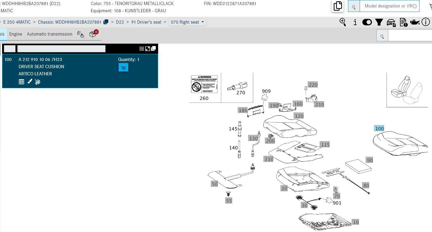

My passenger seat just split recently as well. '11 e350 wagon, Grey MB Tex. VIN#wddhh8hb2ba207881
My local indy shop told me the only fix on the passenger seat is a complete cover/cushion replacement due to the weight sensor.
Does this sound correct? If it is, it seems like a relatively easy replacement, as opposed to stretching and recovering an existing seat cushion.
Thoughts or comments would be appreciated including guidance teo the correct part number(s).
Thanks!

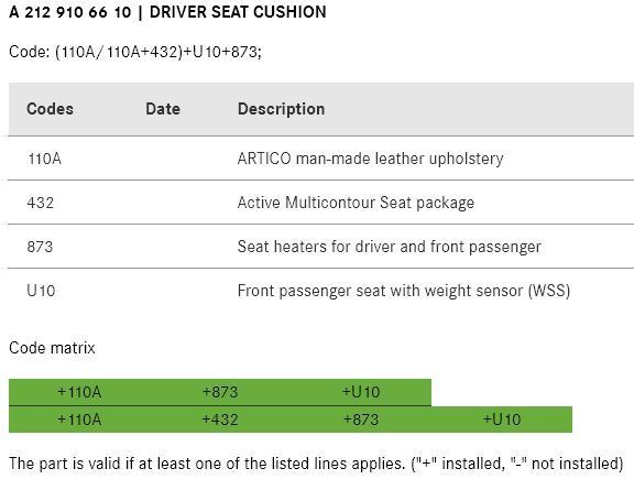

Not saying Darel’s approach will not work but Indy is correct MB only offers complete seat cushion for your VIN notice cover (120) is grayed out.
