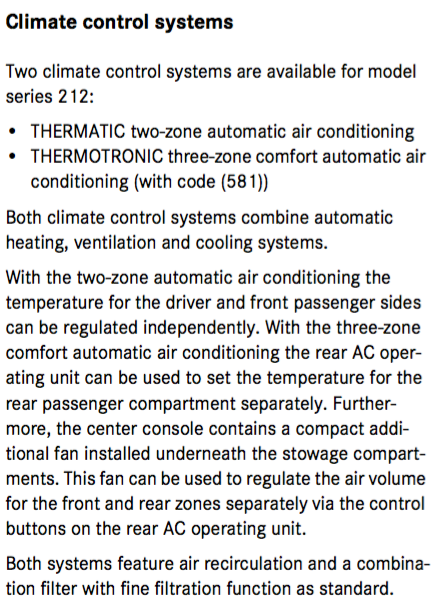

Sure, I could climb under the glovebox and start taking things apart to see if there's an air filter buried in there (yes, that's a dumb place to put the air filter compared to my 211) but is there a better way? Do ALL the W212's have the cabin air filter? I've yet to see a definitive answer online.

Three screws and two wire connectors... super easy, compared to a W124 or BMW E36. Easiest was wife's Civic, open glovebox, two tabs to fully lower glove box and right in front of you was the filter access tray. Like a 5 min change.
Here you go:
Two options: 2-zone (code 580) or 3-zone (code 581)... both feature a filtration filter. What gave you cause to suspect no filter... just curious?

Yes, a 3 digit code on the data card. Sounds like a non-issue, and I'll be ordering up a filter tonight. ROMwife and I are going to hit the Missoula fair in a couple of weeks and I do believe Montana is on fire. Her lungs will appreciate clean air for the drive.
