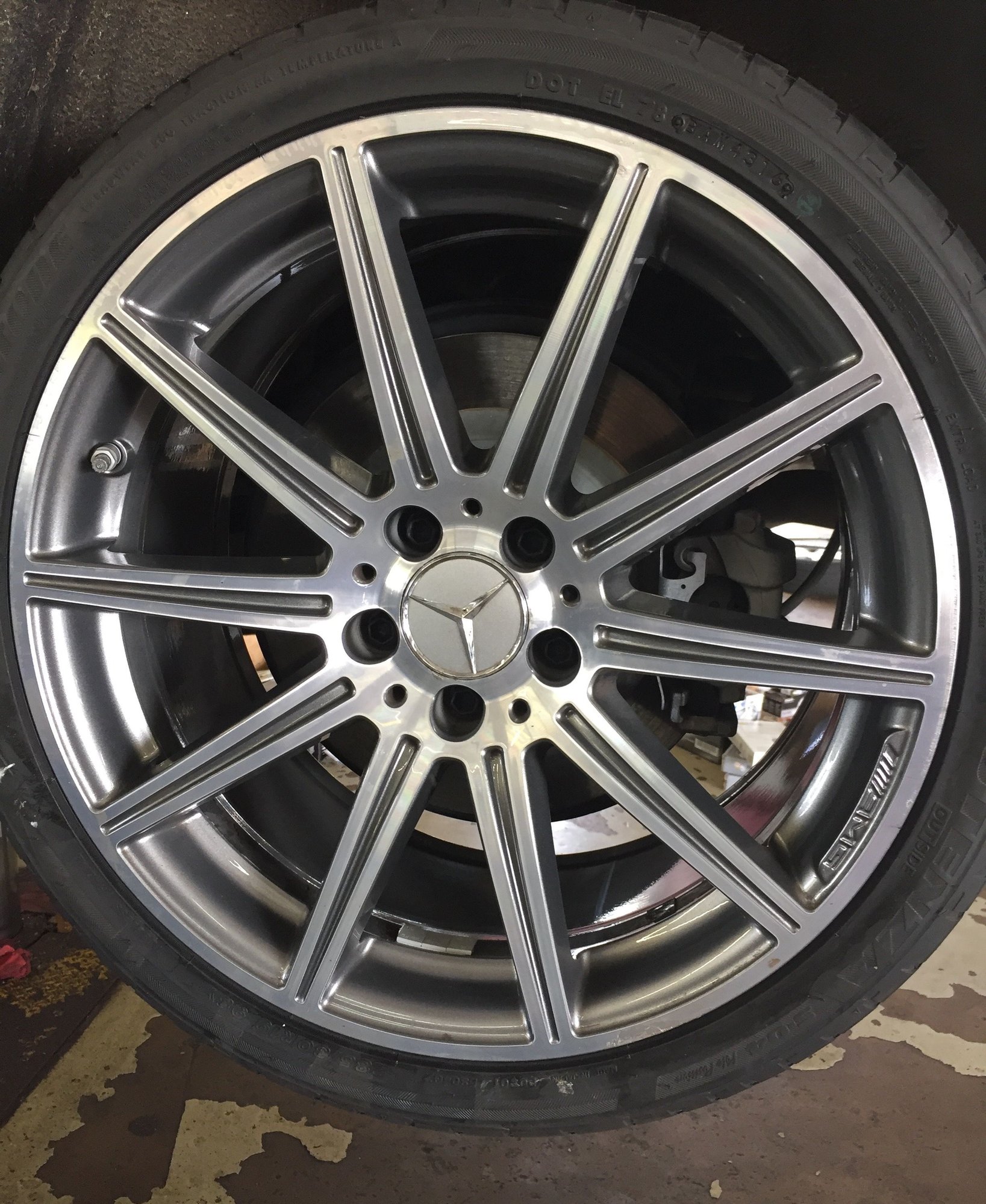

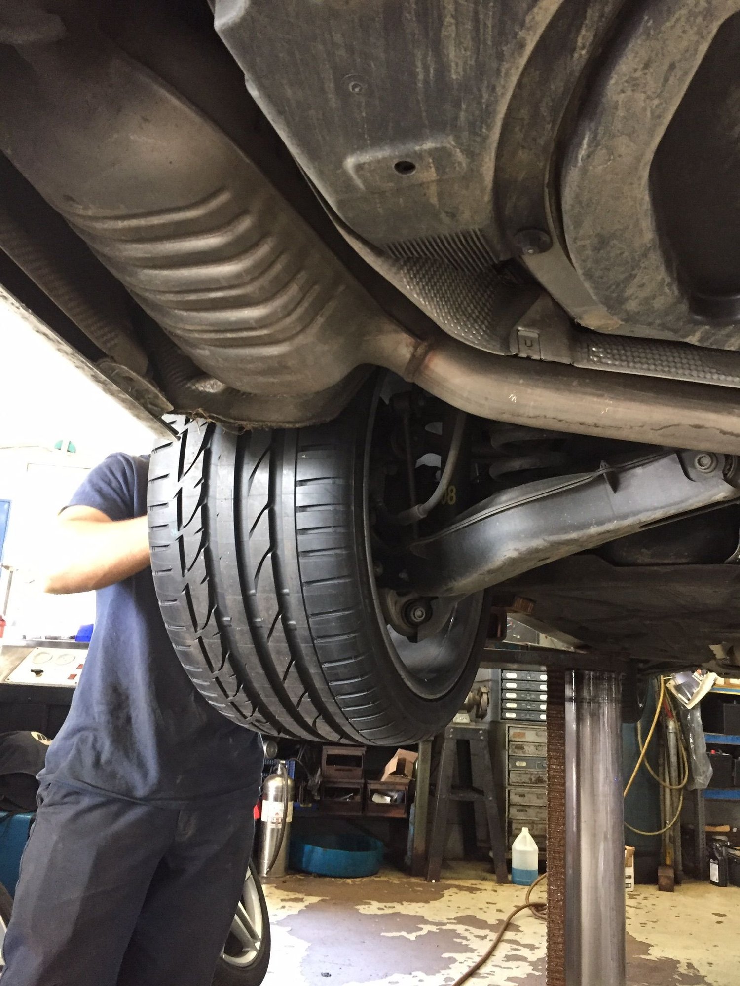

Good looking out and I didn't catch that! Found a set of what I think are CLS63 AMG wheels with 255/35/19 and 285/35/19 tires on 19x9 +37 and 19x9.5 +52 wheels. Will these rear specs clear the struts/shocks? They sit 17mm closer on the inside compared to stock 18" AMG sport wheels that come on our W212.
yes, the rears will fit. They are probably 285/30-19, not 35. I have those on my E63 AMG wheels, which are 52 ET as well. I have the 245/35-19 up front with 37ET
Oh yup you're right, I made a mistake. It looks like they are E63 AMG wheels based on your info and the part numbers I was given. Thanks!

if they are these BBS multispoke wheels, they are very stout and expensive. Anything under 2K is cheap. Most sets will sell at $3,000-$3,500
