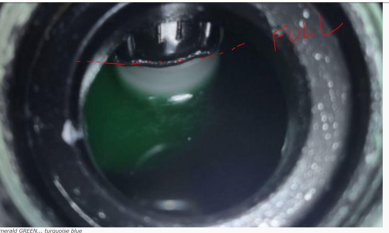

2011 E350 has " check coolant level" message
Hello there. Just few days ago there is a " check coolant level" message popped up. it goes away after few seconds and doe not come back. it comes back the next morning and then goes away. I checked the coolant level but I can't tell if it's low or not. The color looks blue-greenish. If I do need to fill it, where can I buy the coolant? owner manual says MB326.0 coolant. Can I get this from autozone, or does it have to come from mercedes dealership? Thanks for your help everyone.

Clean off the reservoir and use a bright LED flashlight to see the coolant level in the reservoir.

Q: how many miles since your last coolant device?
I would follow Chassis suggestion and determine how much is missing. However, if you are planning to service it soon, I would just add distilled/demineralized water to top it off. Do NOT use tap water.
Not certain if because of the picture, but it looks a bit on the dirtier side. Just an opinion from very far.

Yes, looks low from this angle, about a half inch or so, usually AutoZone has Benz compatible coolant, I buy mine there as they have Pentosin brand.

GREEN!
classic emerald GREEN... turquoise blue
it looks like someone has taken the liberty to use the classic green coolant in your engine...
I believe your car MY should use YLW/Gold or BLU/Turquoise chemistry being compatible but Green is a no-no for compatibility!!

GREEN.
I am not sure what technology you have in your car, but MB makes unique coolants and in some years the coolant level sensor is electric probe checking the level by reading current, who depends on PH or other chemistry.
Wrong coolant will not activate it.
I would strongly advise switching to proper coolant, but old remedy for poor coolant is adding few grains of salt to adjust PH.

I stopped by Oreily's and picked up a gallon of Valvoline Zerex G48 premix. Topped it off and will find out tomorrow if the message still come up. Thanks everyone!!
