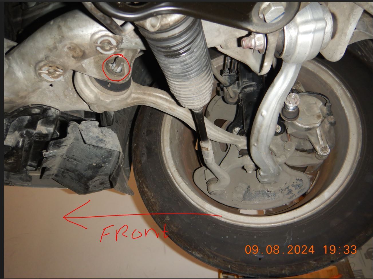

2 control arms on each side, with the larger one “upper” in first pic, smaller “lower” second pic, with different names I’ve seen these control arms called.
Upper, forward, larger, torque strut
Lower, rearward, smaller, cross strut
Didn't notice you talk about a GLK. I assumed W212 that I have. It has no upper control arm, just two lower ones and then the strut that takes place of the upper arms.

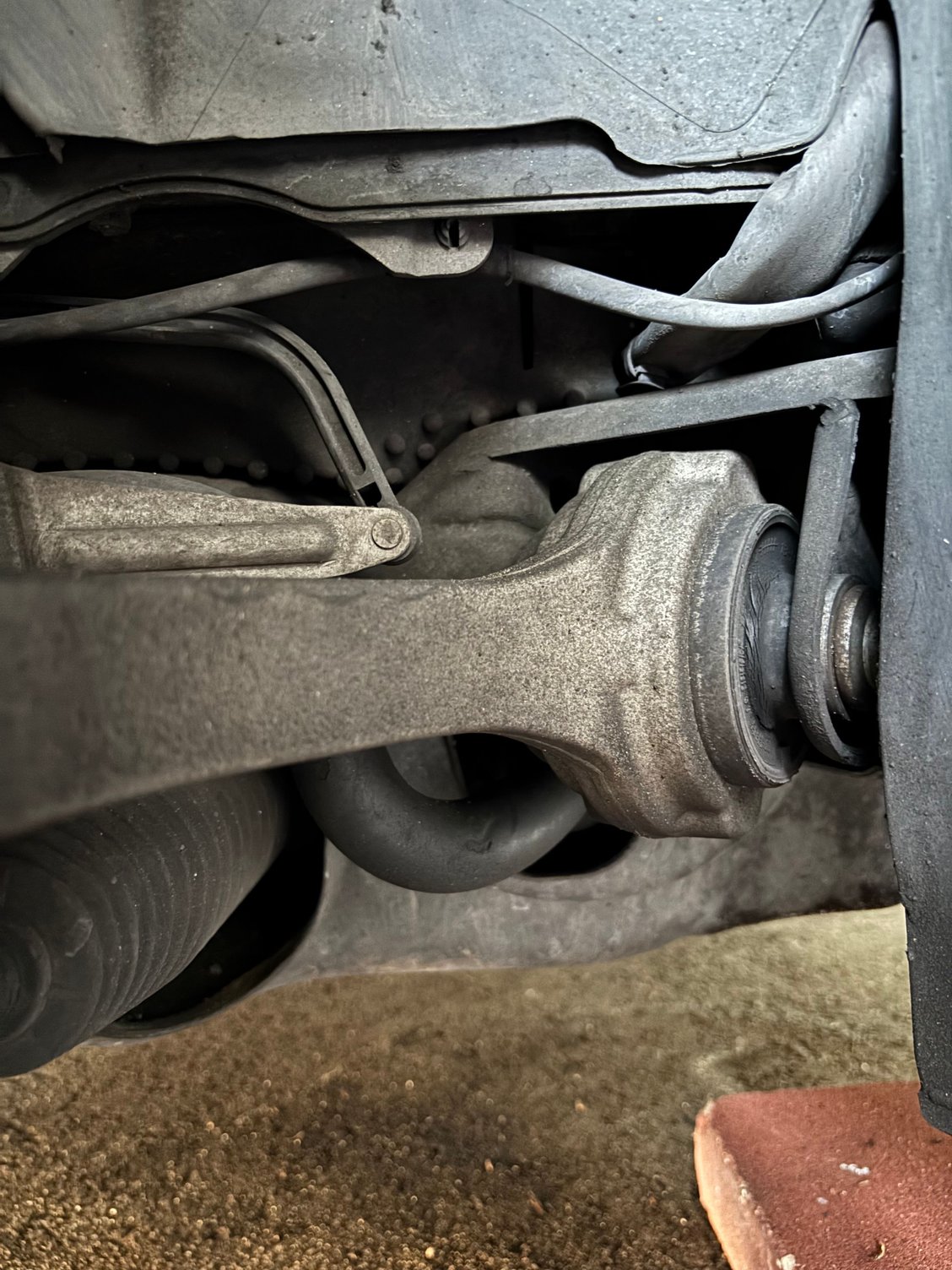

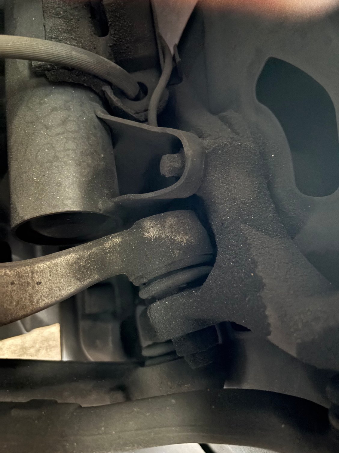

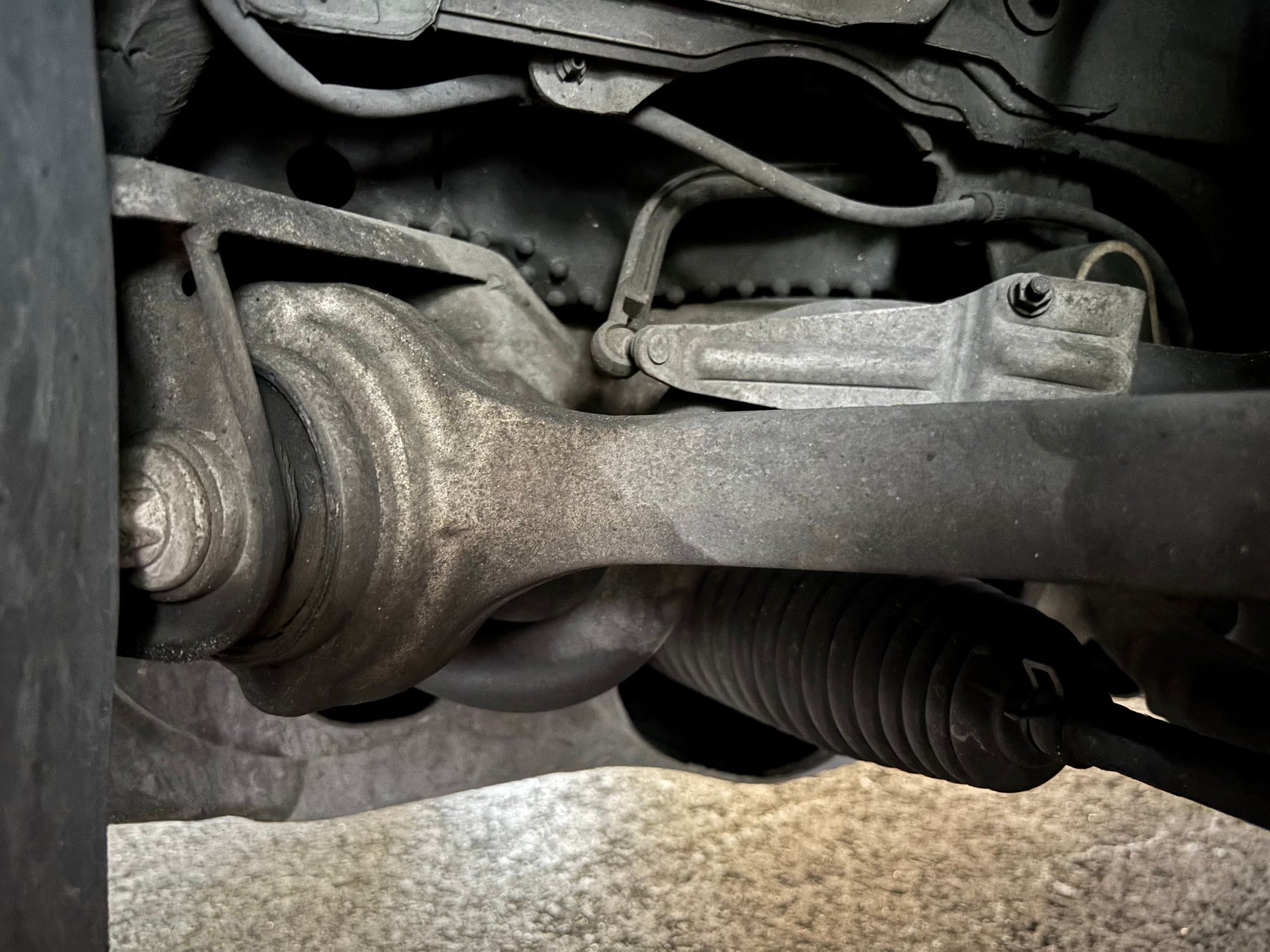

Thanks! Here are a few pics of the control arms.
Old Nov 20, 2025 | 06:14 PM
TimC300's Avatar
Joined: Aug 2023
Posts: 3,689
Likes: 1,110
From: MA Coast
Great photos.
From the looks of it i'd say your drivers side torque strut has seen better days. Looks like the bushing is cracked and signs of fluid leaking at the bottom. And at the ball joint it looks much dirtier than the passenger side. Maybe the grease leaked out and thats what were are seeing covered in dirt. Notice the threads on the passenger side are visible, drivers look encased in filth.
I see that little ball and socket joint, may want to clean and lubricate that.
Heres the passenger side for comparison:
Passenger side bushing does look cracked and fluid seeping but not as bad as drivers side.

Thanks for the insight. Quick question - Is the thrust arm the lower or upper control arm? Just trying to understand the terminology. So it appears the upper and lower control arm needs replaced? They are also wanting to replace the sway bar links.
Something happened to the ball and socket on the right side and the lever would repeatedly come off. The car would go into sport mode at 30mph with the lever off. I put it back on and wrapped a piece of tape around the ball to let it move, but stay on the ball. I will take a look at the left side.

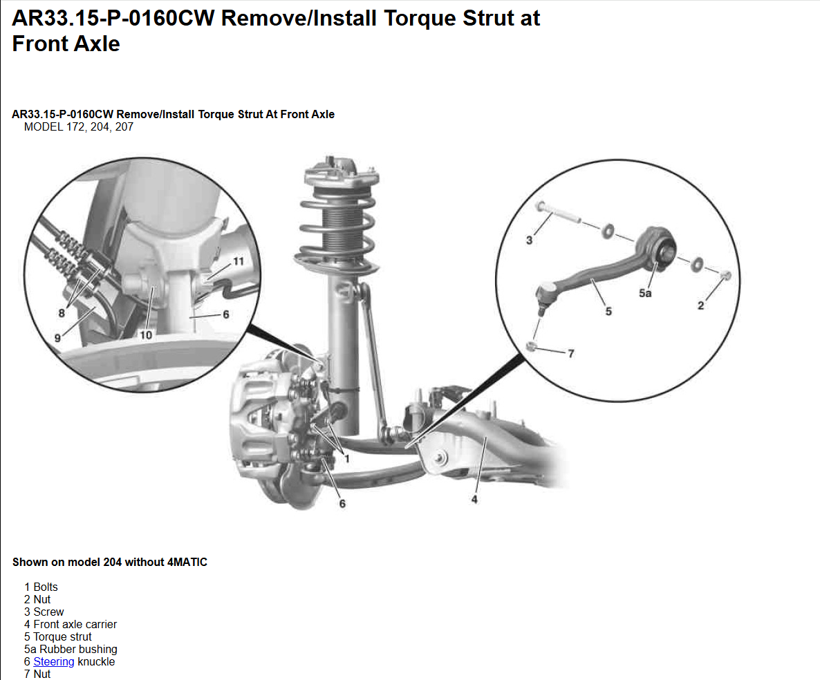

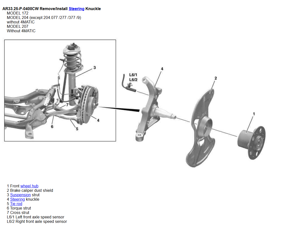

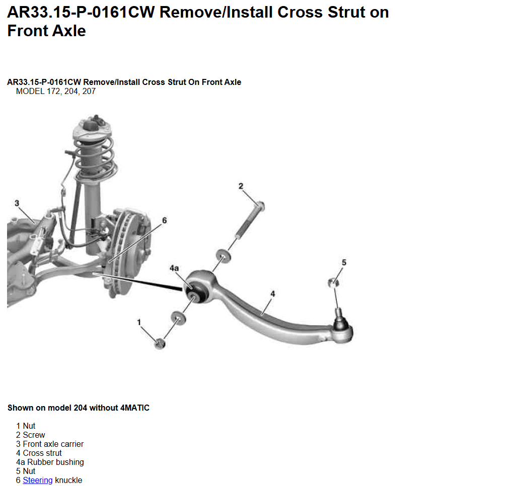

When I hear thrust arm I think of the rear control arms.
On the front there is the torque strut (upper control arm) and the cross strut (lower control arm).
In the photos im not seeing the cross/lower control arms so cant tell the condition.
I would replace the drivers torque/upper control arm. The passenger side looks worn and would be on my list of parts to replace at some point.
For the headlight sensor lever ball and socket you may be able to just replace the arm. Not sure the exact part# you have so just found an example on ebay.

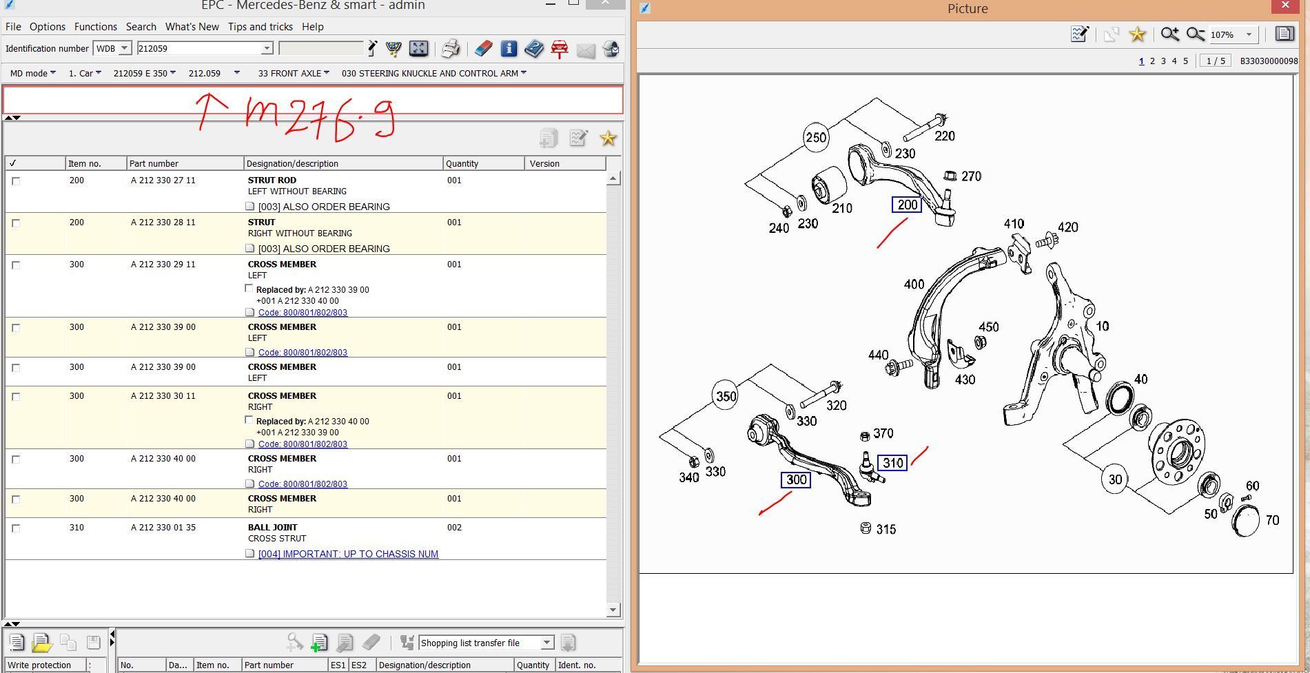

Originally Posted by Davery
I noticed today my suspension is creaking when I do a low speed turn. The car has 100,000 miles and the last 10,000 miles has killed me in repairs.
100,000 miles is good enough to refresh many suspension and steering components if you want you car to be tight almost like new again.
In my county the 2 front arms won't last well pass 50,000 miles, due to crappy road.
Your coupe is a C class chassis and no E class. W207 is your chassis code.
So becareful when sourcing for parts.
Here is the major difference of C class vs E class, for RWD version, not 4-matic. FRONT SUSPENSION ARMS
E class RWD has the L ball joint, item 310.
W212
Strut rod #200 is the bigger one and the installation or bushing is in front of wheel carrier/knuckle, this is CASTER ARM
Cross Member #300 is the thinner one and installed perpendicular to wheel carrier, this is the CAMBER ARM.

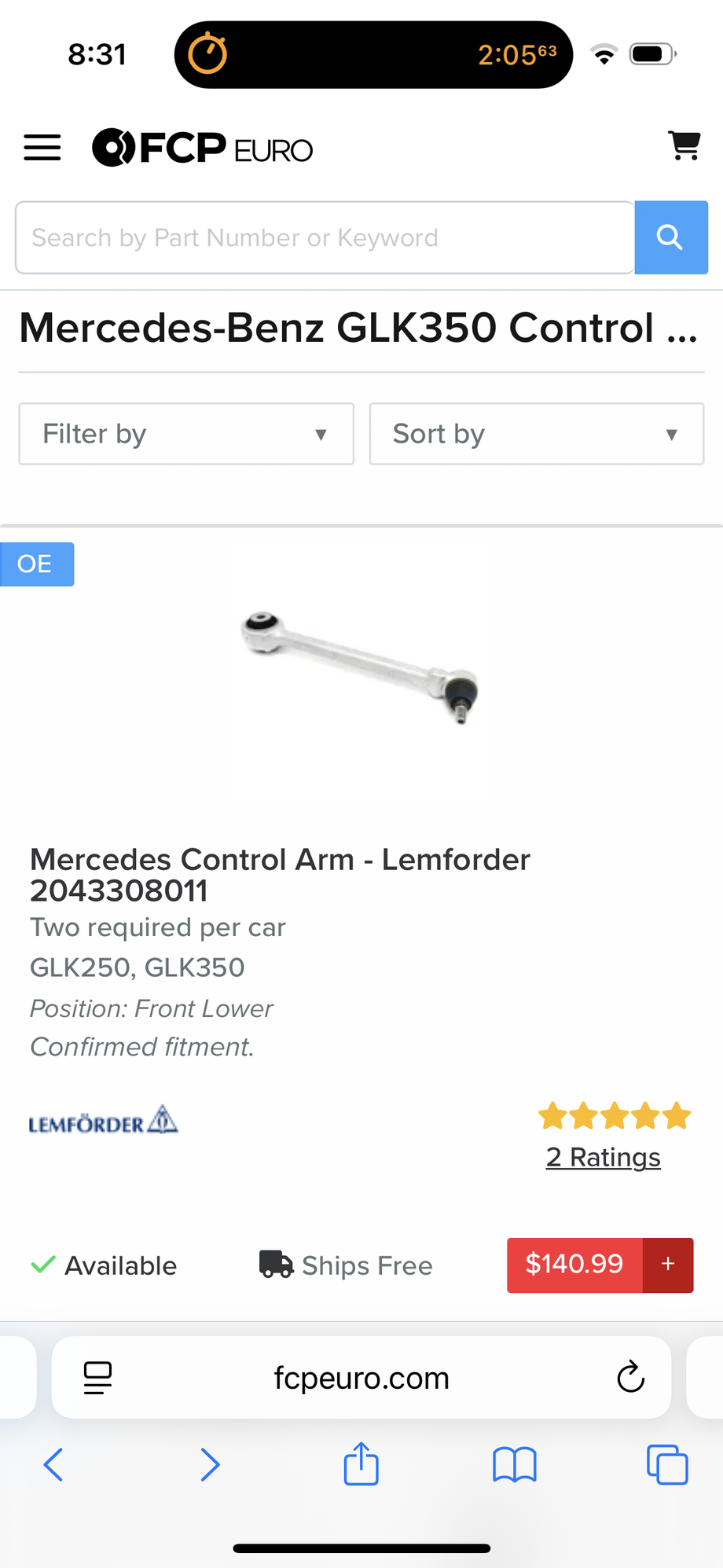

Mine quiets down when raining, I can easily move them slightly when under car.
I’m trying to decide between Febi Bilstein and Lemforders, the later would be liken $150 more.

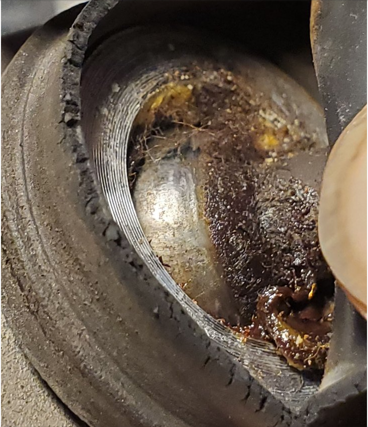

I did not have good luck with Febi sway bar links. I had one fail after 2yrs and now i think the other side is failing so will be 3yrs.
I made a thread on it here: https://mbworld.org/forums/c-class-w...iled-2yrs.html
Even with buying them from FCP and the lifetime warranty getting the "free" replacements is still costing me more money since the prices have gone up a good amount.
I work on my car myself so replacing failed parts isnt really a big deal but if I were paying a shop to do it I would really only buy Genuine Mercedes or the OE manufacturer.
Below is the failed Febi link. Looks like hardly any grease was in there. And I had ripped the boot open to check so its not like the grease had leaked out.
