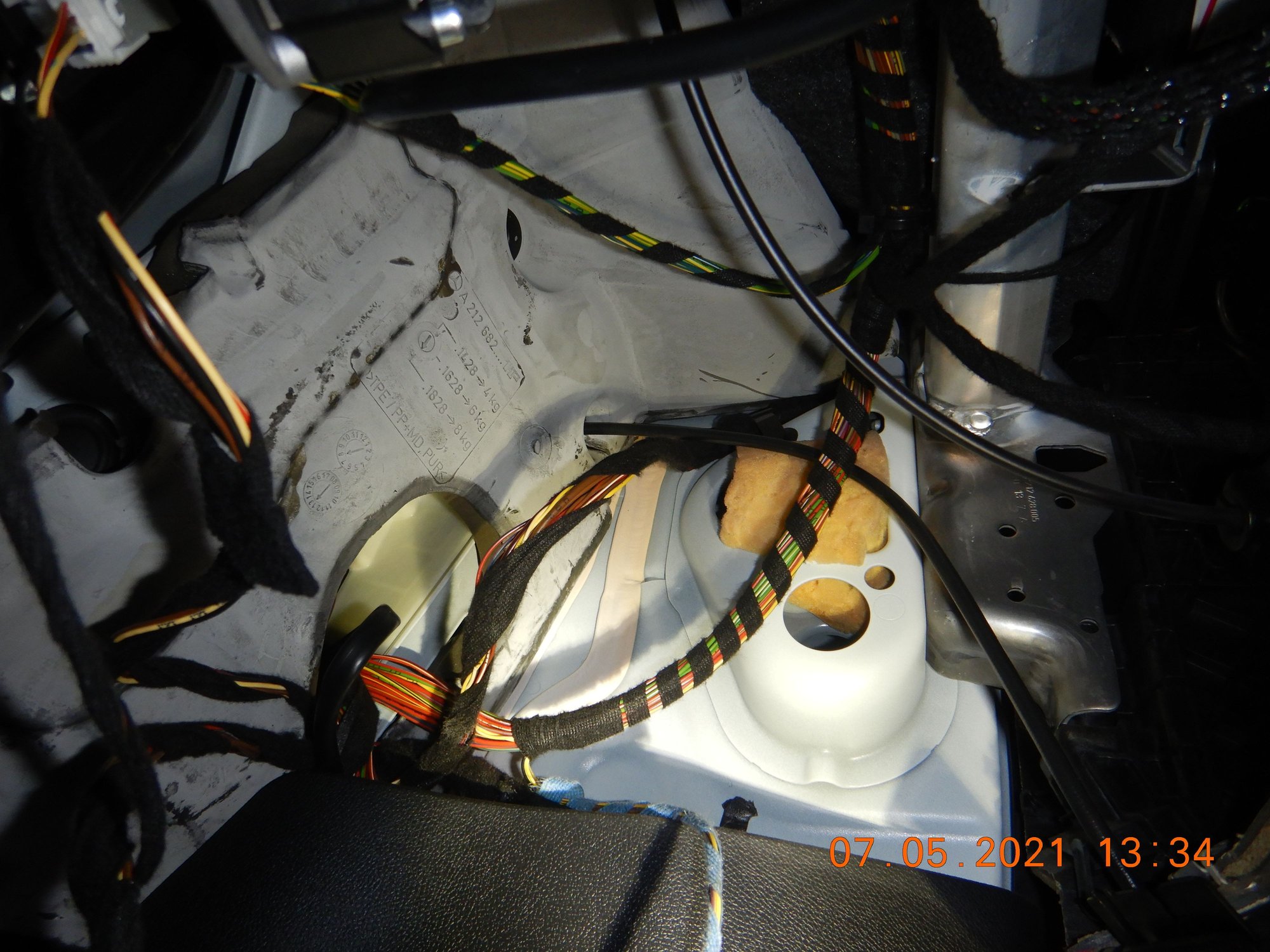

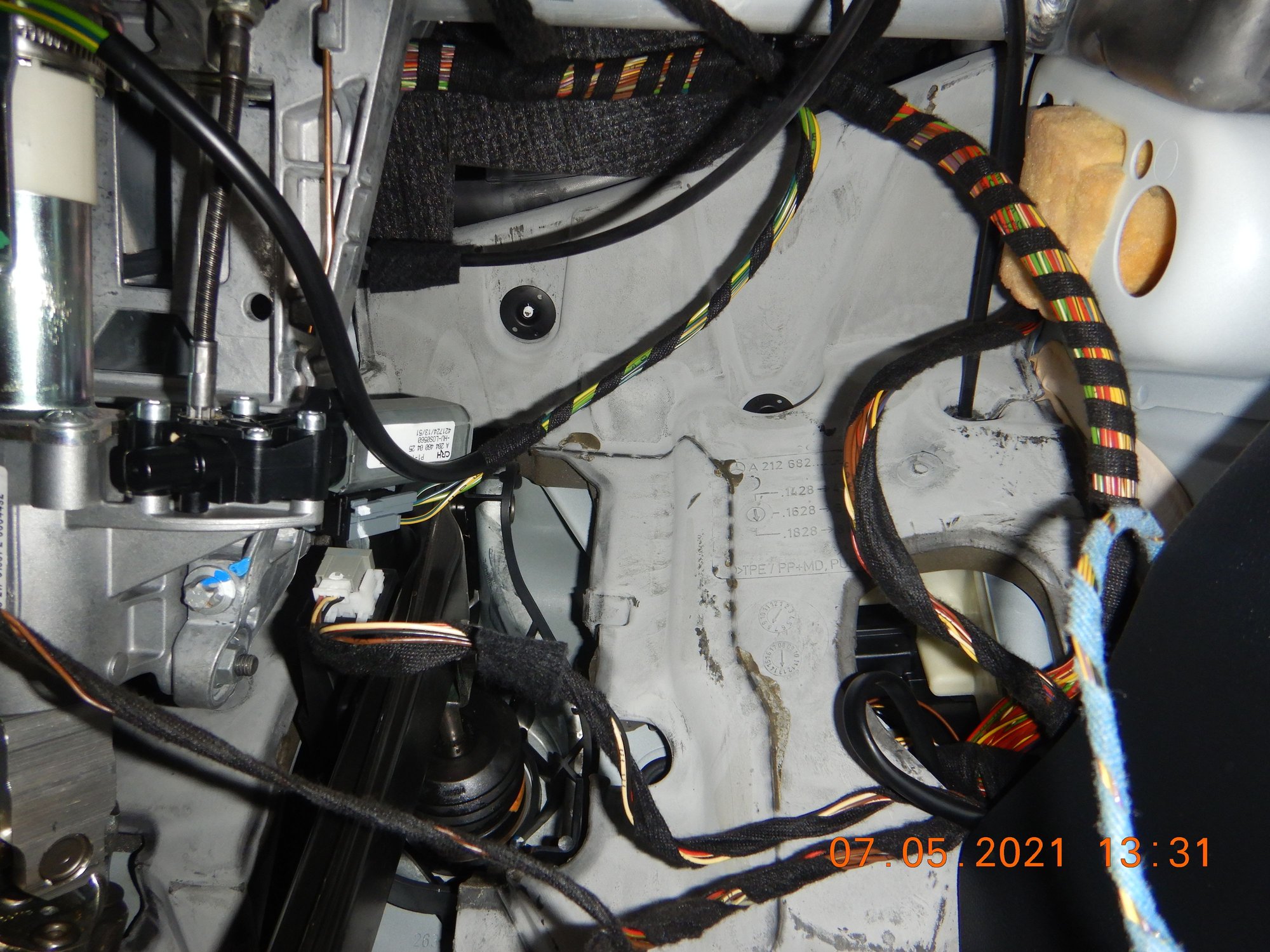

Next suspect are these areas in engine bay.
01. The front SAM uses seal, if the seal leaks that is a big hole and is above the driver footwell.
https://mbworld.org/forums/e-class-w...ak-points.html
02. Brake booster is another device which goes thru firewall between driver footwell to engine bay
03. Steering link
I would focus on front SAM first because it is at driver side The plastic tray which has the wiper, that is a leaky point at the wiper shaft seal.
Do a running water test on front windshield while removing the footwell cover and see water seepage.
I am on a RHD car, so for your LHD car what you see would be different, you can visualize still.
That is the hole of the front SAM. If there is a leak at the seal, it will be hidden under the sound shield which in my car is the grey foam
If your A pillar is wet, it makes sense assuming front SAM is the culprit.
Below is lower side of A pillar to the right of the hole of front SAM, for your car it will be to the left of the from SAM hole

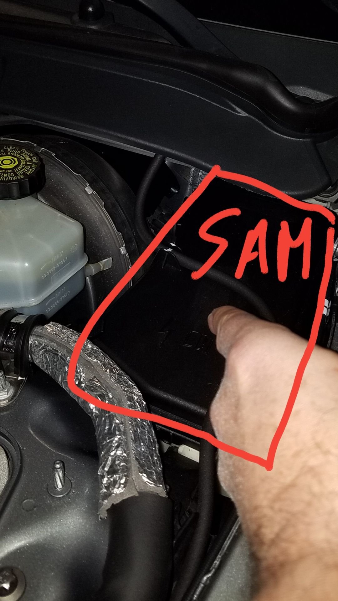

FYI: located at the first row seat, your main power management module (aka SAM) is setup for rain damages. It gets swamped when the rain is channeled down the harness right into SAM's enclosure tub.... long story short be sure you inspect and dry your driver side SAM ASAP, this will save you bundles.
I used RTV silicone last time to fix that defect on all 4 corners of my car roof.
SAM wide open entrance gap (I plugged mine!)

I would hate my SAM enclosure to get filled with rain. I plugged the internal access as a precaution when I had my F-SAM pulled out for inspection.
You can plug that big hole just as easily from the driver footwell area without removing SAM (rain may still be guided by individual harness wires).
Another reason to keep the driver side F-SAM within unconditioned air space is to prevent any condensation crusties from building over cooled metal.
Okay, I'll look at that also... as soon as the temps get out of the teens. So the SAM entrance is in the footwell up above the pedals then? Just pull back the carpet?

Emergency rescue for F-SAM:
-> check for any evidence of wetness...
-> don't let it soak while powered!
-> if wet then *EXTRACT SAM ASAP* for drying before oxidation start bridging the consumer grade PCB with infamous crusties!
Front-SAM does NOT feature a removable PCB like Rear SAM. It is directly soldered to the fuse board!
This module is really the marriage of a dual micro-controllers circuit board with fuse and relays.
(To attempt any worthy repair, an army of pins need to be desoldered from a double sided board... that's still cheaper than $2.5k!)
SAM access cover:
You don't have to get under the dash to gain access to this module. From under the hood you can pop the fuse cover in/out much more easily.
SAM's lid

Well now we've got the drain tubes out of question, we can focus on your cracked roof seams - That's what this thread is about.
roof seam plastic trim cover
Leaking roof seam:
- Pop that trim and use your favorite sealer to cover the cracked seam.
- or let a body shop take care of this with automotive body joint compound.
VIP Electronics rescue:
- Furthermore read thread about your main SAM tub getting swamped straight from the roof harness.
- Disconnect batteries, keep cover open to dry ASAP.
- Keep an eye on swampy SAM with scanner. It may need replacement.
Thanks for your response really appreciate it
It's probably gonna sound stupid but....do I remove this plastic trim from the roof and seal it from outside or remove pillar A and a bit of headliner and seal from inside?
can that job tackled by Independed Merc specialist or with basic mechanical knowledge can be done at the carpark ?
The silicone you used...where can I get it from ?
At the moment water only appears on Pillar , not bigger than 2cm diameter , fool carpets are still dry so Im guessing SAM under the carpet is still ok. If weather allows I will try to strip it down on Thursday.
Once again thanks for your help

Originally Posted by jajcek
Thank you for your message. Yesterday after work as a temporary measure I applied some tape from pillar B to pillar A over the plastic roof rails, also stuck a bit of paper towel at the junction of liner and pillar A under air bag just to see if it will get weat, it did rain all night and today when I got my car it all looked dry....so I guess it leaks somewhere between pillar A and B. I was thinking if it possible that it leaks at the place where roof rails can be fitted?
No question the removable roof rail covers do leak because the seal is done at lower level. The plastic trim is used to nicely conceal the body welds.
The W212 windshield seal is known to leak... that's why you may want to spray test suspect areas from the bottom up. No guessing needed✌️
10mn 5¢ fix:
Having taped up the roof trim is another quick way to see if leak will stop.
The key is to minimize swamping F-SAM in his tub through direct delivery by A-pilar harness pictured above.
