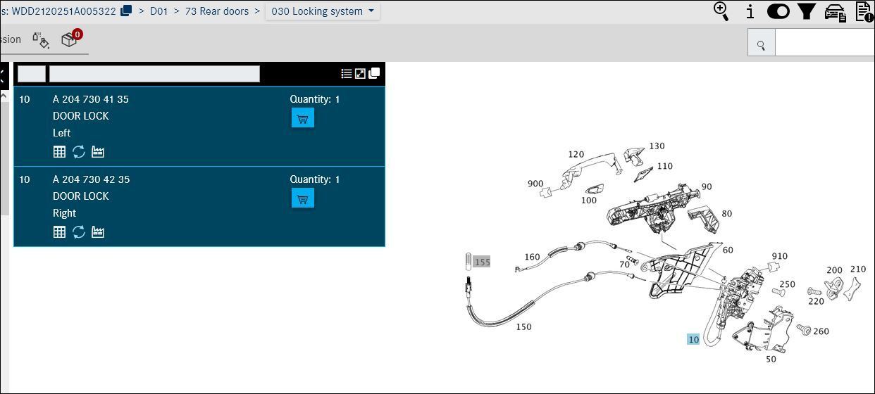

Old Feb 18, 2022 | 11:29 AM
konigstiger's Avatar
Posts: 15,901
Likes: 4,625
From: North Scottsdale, AZ
'71 Pinto
File Type: pdf
Old Feb 18, 2022 | 11:33 AM
Enrikas01's Avatar
Joined: Feb 2022
Posts: 4
From: Lithuania
W212
So only the locks with these codes will work?
Old Feb 18, 2022 | 12:00 PM
Posts: 15,901
Likes: 4,625
'71 Pinto
Yes.
