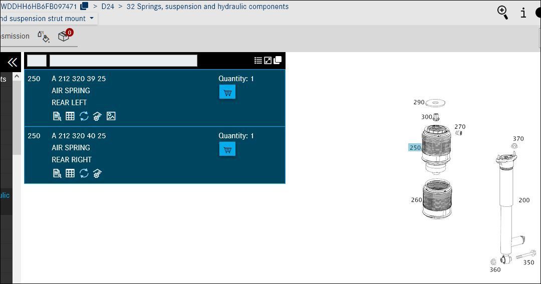

To answer your question wagons can be equipped with optional Airmatic front & rear or standard rear air suspension only. Your vehicle is rear air only. Not common for both air springs to fail simultaneously to start check compressor harness, for leaks (soapy water) @ valve unit and each air spring. If no problems I agree have someone pull fault codes.
