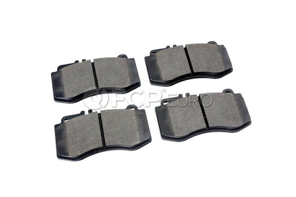

Guys! I have searched a few sites for the Akebono pads for the front axle. All sites show a pad that doesn't resemble the pads on my car now. I find them in Brembo,Centric,powerstop etc. But not Akebono.

Is this the shape/style you're expecting? It looks like Akebono only makes pads for the rear, which is disappointing.
Looks like Brembo makes a front ceramic pad though. I'd be inclined to go that way

How does Brembo pads and rotors all around sound to you??

Yeah, that sounds like a good combo. I'd do it. Let us know how they work for you, I'm sure there are plenty of others in your shoes!
