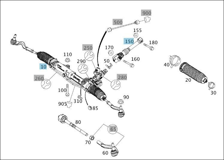

Your vehicle should be equipped with direct steering (code 211) check steering coupling if fine could be steering gear, also don’t rule out electric power steering (ES) software upgrade. May be best to have someone with Xentry (MB diagnostics) check it.
thanks for the info Kon, i have noticed that this issue is more visible after i drive for a long distance say +150KM in one go. I will start at least with the Xentry update like you suggested, i will keep updating this post until the issue is fixed and gone.
