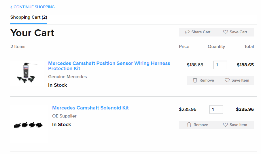

I'm looking into replacing my sensors as preventative maintenance. I drive a 2012 e550 coupe with the M278 and will be paying a shop to do it.
So I want to make sure, all I need are these from fcpeuro and the wires from ebay?
https://www.ebay.com/itm/17091548172...Bk9SR_zat9q3YQ
Or should I be getting the FCP euro kit with the harnesses.
Thanks!
