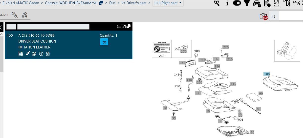

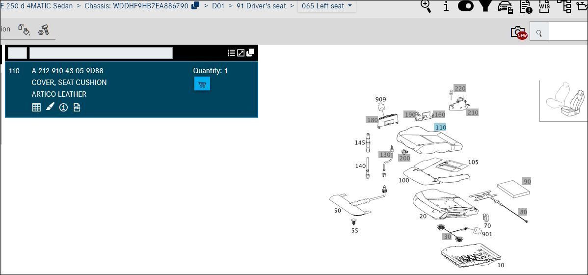

Konigstiger, can you show me the part # for my vin please? 2014 E250 Bluetec 4matic VIN WDDHF9HB7EA886790
Old Aug 17, 2022 | 01:58 PM
  #54
konigstiger's Avatar
Posts: 15,901
Likes: 4,630
From: North Scottsdale, AZ
'71 Pinto
File Type: pdf
