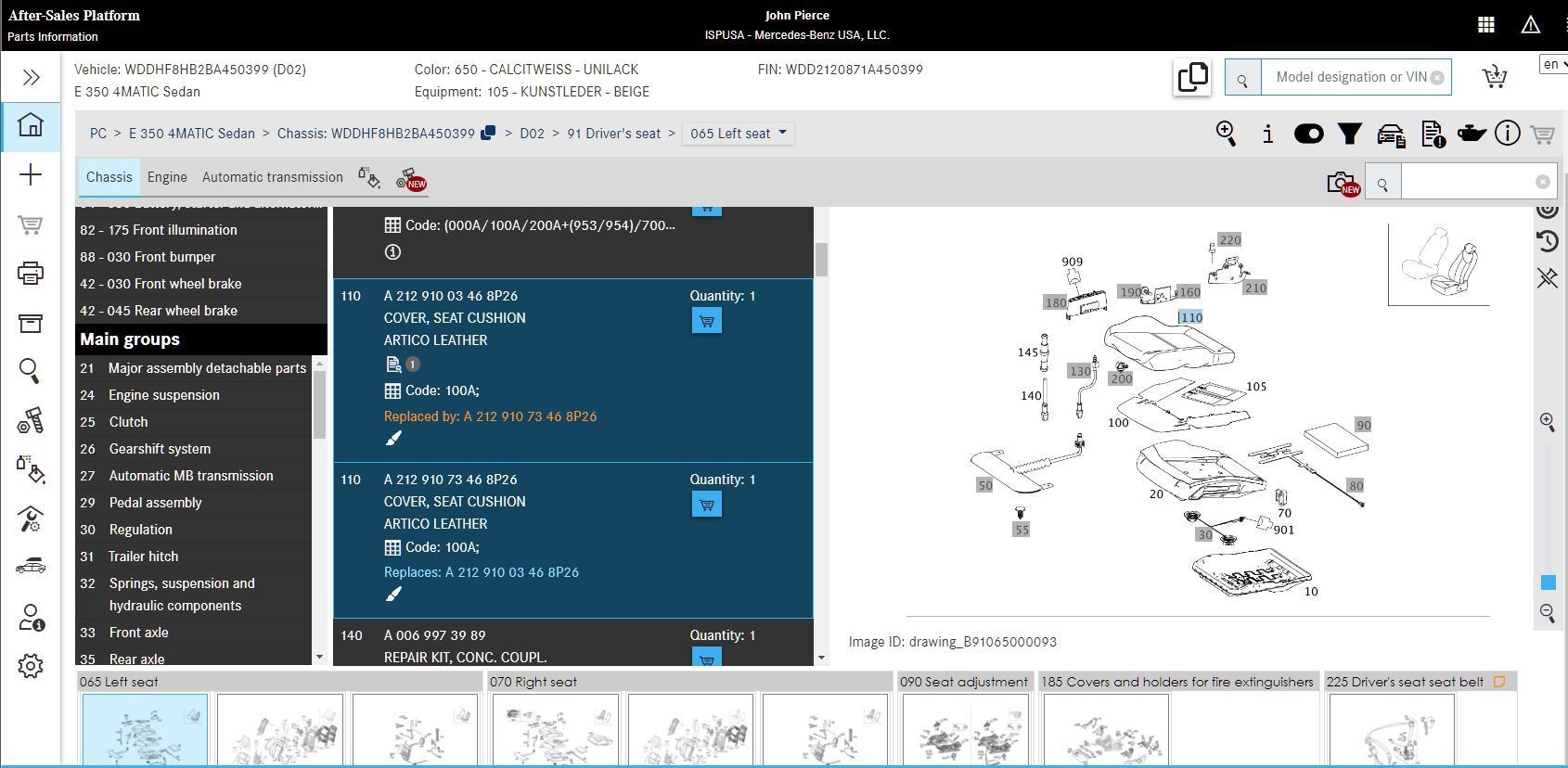

Old Jul 17, 2022 | 02:25 PM
E Guy's Avatar
Joined: Jul 2022
Posts: 11
E350
Provide VIN I'll pull MB part # to shop used/new as you surmise new may be cost prohibitive but with correct color code local upholster should be able to provide cost effective repair/replacement.
WDDHF8HB2BA450399
I want to replace the driver seat bottom cover only, MB-Tex. It’s beige but don’t know the actual color name. 2011 E350 4M sedan. If you can find a part number, I can google it for a discount OEM supplier. Unless, you know a reputable OEM for this part? Thank you for your assistance.
Old Jul 17, 2022 | 03:14 PM
Left Coast Geek's Avatar
Joined: Dec 2020
Posts: 2,412
Likes: 1,482
From: 122W, 37N
2016 E350 4Matic wagon, 2019 Ford Expedition, 2019 Chevy Bolt EV
Drivers (LEFT) lower seat cover, coDE 100A, A21291073468P26 (replaces old number A21291003468P26)
https://www.fcpeuro.com/products/mer...129107346-8p26

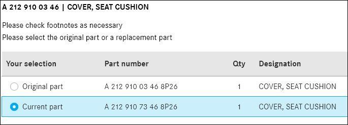

WDDHF8HB2BA450399 I want to replace the driver seat bottom cover only, MB-Tex. It’s beige but don’t know the actual color name.
Used shop 21291003468P26, new/used 21291073468P26. Fellow member compared online dealer sources for new parts: https://mbworld.org/forums/s-class-w...ts-online.html

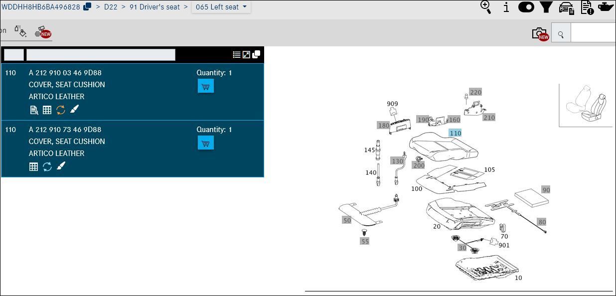

Old Jul 18, 2022 | 11:14 AM
thatPNWguy's Avatar
Joined: Dec 2021
Posts: 12
From: Washington State
2011 Mercedes E350 4matic Wagon
Konigstiger, can you show me the same for my vin please? WDDHH8HB6BA496828
Old Jul 18, 2022 | 11:28 AM
konigstiger's Avatar
Posts: 15,901
Likes: 4,630
From: North Scottsdale, AZ
'71 Pinto
File Type: pdf

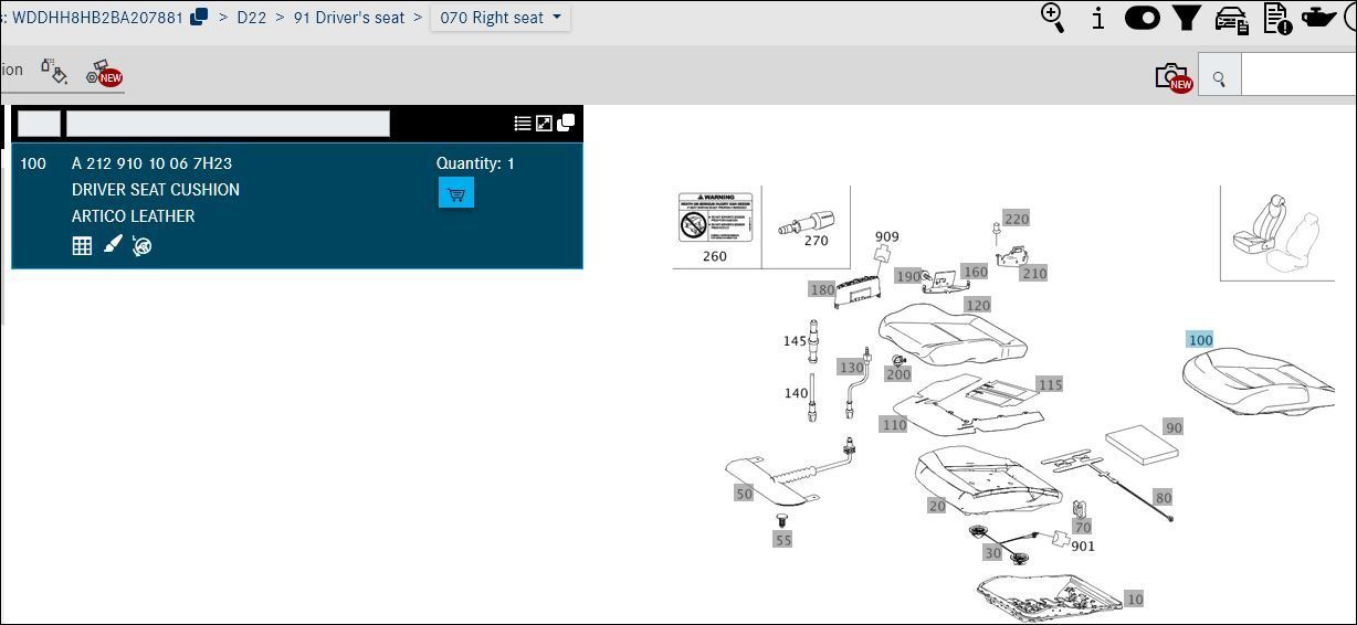

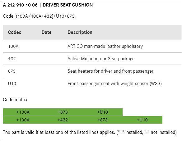

May I have some assistance for the front passengers seat on an 2011 S212- VIN# WDDHH8HB2BA207881.
Color Gray MB Text
I believe the passenger seat has the heating elements integrated into the cover.
Thank you for the assistance.
Old Jul 20, 2022 | 03:00 PM
Joined: Dec 2020
Posts: 2,412
Likes: 1,482
From: 122W, 37N
Color Gray MB Text
seat heating is a separate layer under the skin.
your LEFT seat cover is A21291077467H23 but your right seat is NLA.
You *can* get a complete passenger(right) side seat CUSHION with the heater and skin and foam and everything, thats PN A21291010067H23
OH, those are the PN's for the 'cushion' which is the /bottom/ of the seat. there's different numbers for the seat backs (you didn't specify which you are looking for)... Right seat BACK skin/cover is A21291014477H23

Old Jul 20, 2022 | 03:06 PM
Posts: 15,901
Likes: 4,630
'71 Pinto
File Type: pdf
Old Jul 20, 2022 | 03:08 PM
Joined: Dec 2020
Posts: 2,412
Likes: 1,482
From: 122W, 37N
yes, 120 the 'skin' / cover, is NLA, 100 is the whole cushion assembly.
