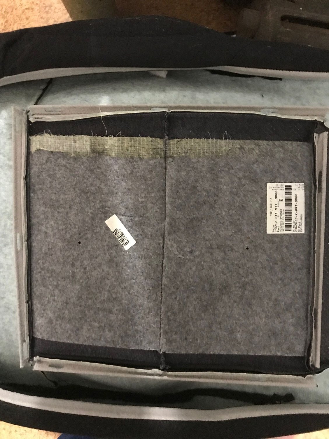

Here are the two felt pockets the seat heating elements slide into, handle them carefully

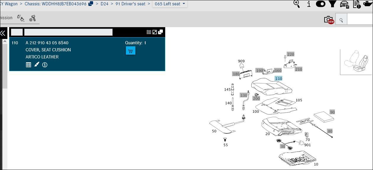

2014 E350 Wagon
Another VIN lookup please
VIN lookup for the driver’s seat bottom for me as well please. 2014 wagon, beige tex:WDDHH8JB7EB043696
thanks,
Ed
File Type: pdf

that one has the multiwhazza seats, and yeah, konig has the PN for the left front cushion (lower) cover/skin.
