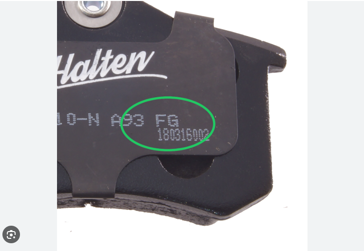

I installed Zimmerman rotors, Ferodo semi-metallic front pads and ATE semi-metallic rear pads on my w204 4matic and after around 33k miles the pads appear around half worn. I am very happy with how long they are lasting. The brakes work perfectly in my opinion. Only complaint is the dust and im always cleaning the rims.
The rotors already have a noticable lip on them so I cant imagine not replacing them along with the pads when its time. The typical MB rotor wear limit is around 2mm anyways so i dont think they are really designed to be resurfaced.
When I looked for replacement pads up they have the same or higher friction codes than the original pads on the car.
Theres a bulletin on applying a zinc dust paint on rotors of cars parked for extended periods.
