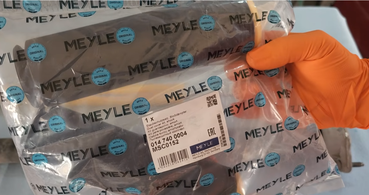

I ordered this one from Ebay shipped from Latvia. It comes in a kit with a set of two. Found it from watching this youtube clip
