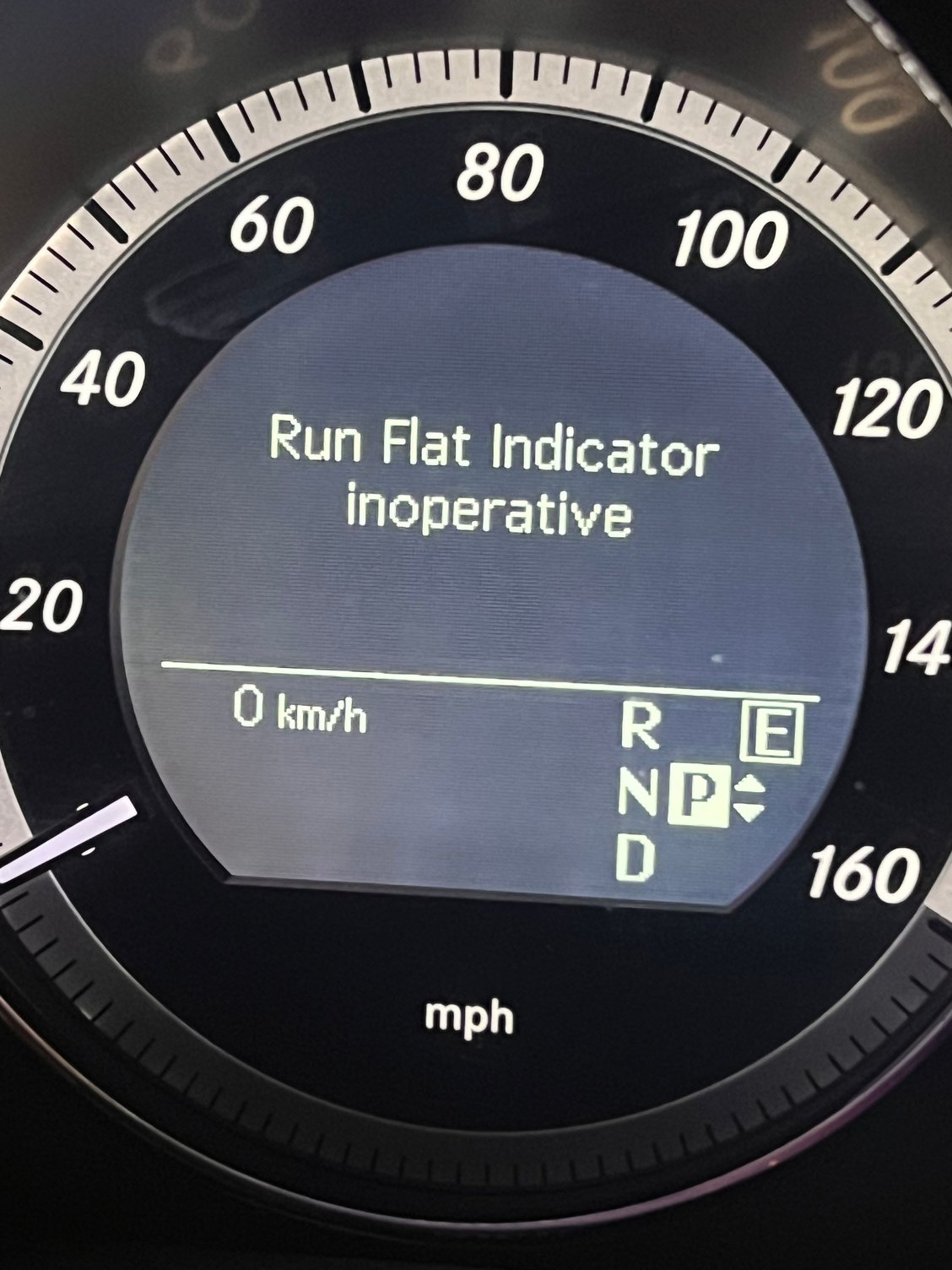

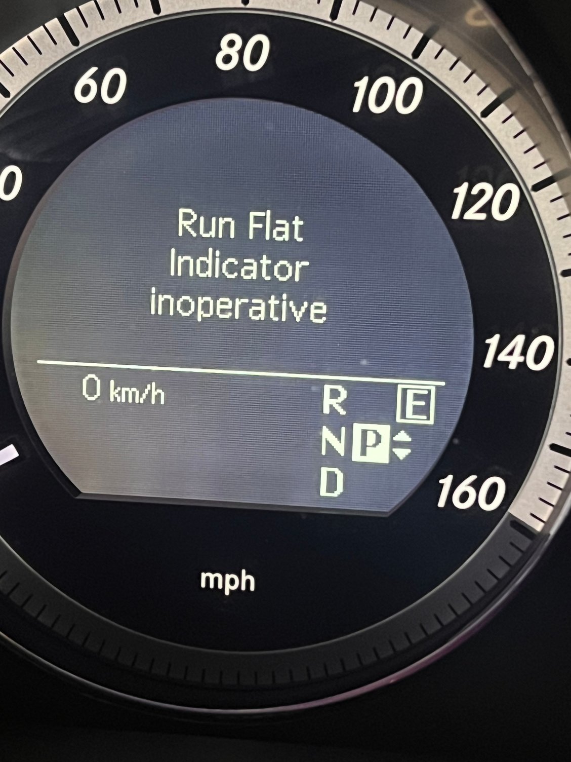

So I bought a 2010 E350 just over a couple of weeks ago and it's been sat on my drive until today (so first drive today) while i've had to sort out driving license stuff
As soon as I started off this morning I got warning lights saying that the ABS and traction control and run flat indicator were not working. Also says the attention assist system is inoperative.
The car still drives which is something I guess!
I have a carsoft v2 scanner tool on the way but just wondered if anyone might have any thoughts on why this has happened. It seemed fine before being left for 2 weeks and I have started it and let it run for about 10 minutes every 5 days or so.
Feeling a bit sad that this is my first experience of benz driving!

I'm thinking that it may be something as simple as a wheel speed sensor. ABS and ESP need the signal.
Not certain about the run flat system, but it too may be comparing wheel rotational speeds

I've run into these error messages on my previous W211 when it sat for extended periods of time, usually for more than a week or so. It didn't happen every time, so I'm sort of wondering if weather conditions play a part in it, if you have moisture (or possibly ice this time of year) in a wheel speed sensor, which dries out after being driven for a while?
The ABS, ESP, and TPMS (run flat indicator) all rely on wheel speed data, so a malfunctioning sensor will disable all three systems. Depending on how the vehicle is optioned the run flat indicator uses the wheel speed sensors as opposed to sensors inside the wheels to determine if a tire is losing air, the low tire will rotate at a different speed than the rest and will eventually trigger the run-flat indicator.
The attention assist system most likely monitors the ABS and ESP systems, so it would also be inop if those systems aren't working.

Well something amazing has happened - I took the car out tonight and after a couple of miles it just fixed itself! the warnings disappeared and all systems working! I am so happy
Many thanks for all the people who offered their advice - was good to feel there were people helping!
