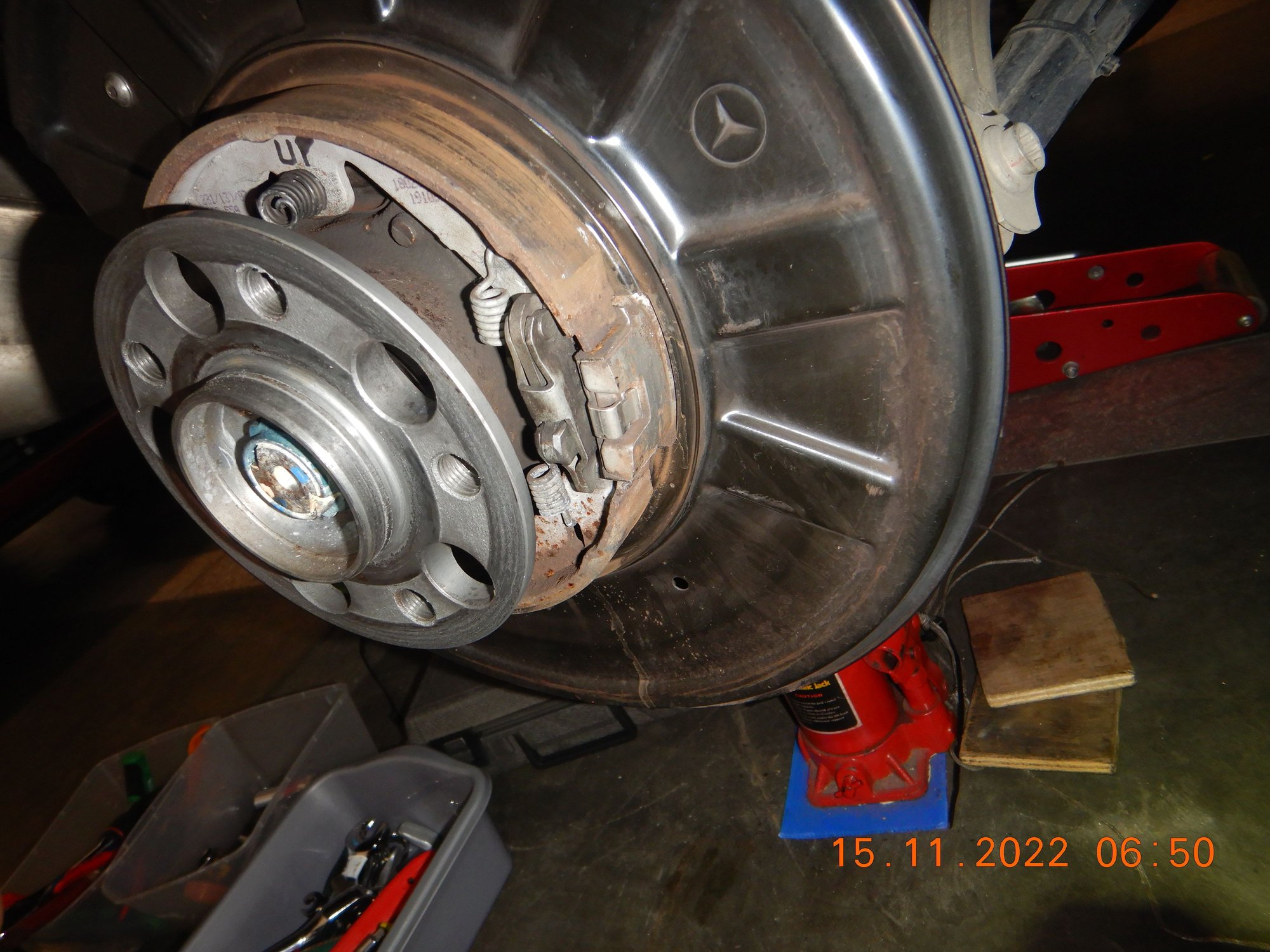

I hate drum brake, I mean my parking brake is drum brake.
They look ugly, poor accuracy of mechanical placement and execution, they can move here and there and they uses springs* ( *a bi-etch to work with ) and even at zero setting, the brake pad still "kiss" the drum.
Is there a way to not have the brake pad drag/kiss the drum ?
WAS
Genuine MB parking brake kit
After lots of swearing, even when using special drum brake spring plier which is useless for the small U part of the hook MB is using............
These two special tool, useless :
1st tool
Amazon Amazon
and
2nd tool https://www.lasertools.co.uk/Product...g-Pliers-300mm
The hook of the tools is so thick, when I use it there is no more "U" space left of the spring to hook up to brake pad hook recess/catch.
Also the hook of the tool (1st tool ) will hit the brake pad before I can get the spring close enough to brake pad hook recess/catch LOL
I hope my description makes sense. I do not know how to describe better in English...sorry.

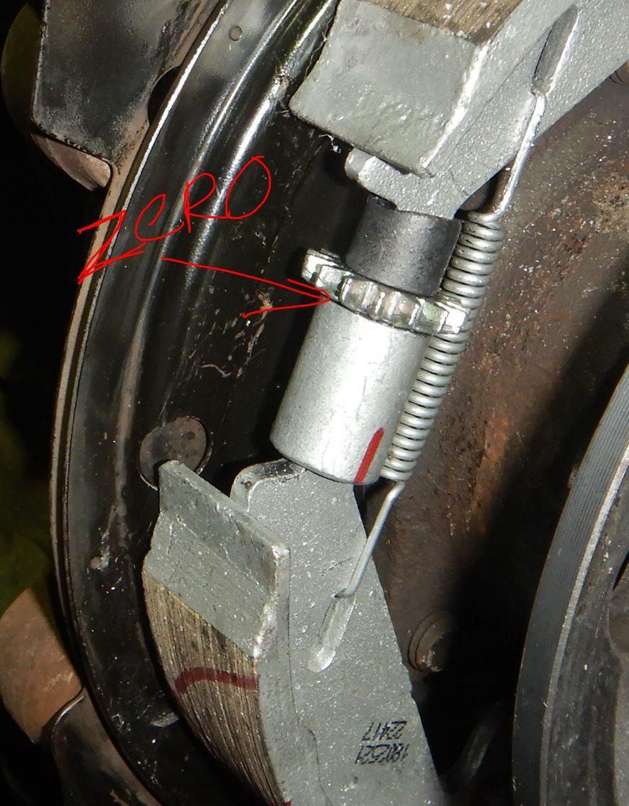

The setting at zero, still rubbing sound exist, so irritating. Image below is RIGHT side. Video is LEFT side
Video. I was running-in ( Bed-In) the parking brake pads. Parking brake is NOT ENGAGED at all.
Any tips for 100% silent no rubbing guys ?
Nothing is wrong with my parking brake, they just look ugly due to rust. So I replaced them.
It is also un-even wear on the parking brake pad. Too bad I did not machine my disc/rotor parking brake side of the rotor inner diameter ( me lazy ), as it is also not smooth due to previous parking brake pad.

The brake shoe adjustment is already at "smallest" or minimum or most retracted as I pointed out.

I'm having this exact same rubbing issue, but only on one side after replacing shoes, disks and pads, did the rubbing settle down after some time ? Also did you notice an increase in temperature on the hub/ disk due to the internal friction when driving ?
Old Apr 18, 2023 | 09:31 AM
S-Prihadi's Avatar
Joined: May 2018
Posts: 6,600
Likes: 6,547
From: Jakarta-Indonesia
No significant increase in temperature. The touching is very very light.
However, I now have to depress to maximum click distance on the parking brake to get good bite.
Perhaps some thousand KM later I will re-visit the adjustment. My car is hardly on the move the past many months
Old Apr 18, 2023 | 09:34 AM
gudgera's Avatar
Joined: Dec 2022
Posts: 21
e250 cdi amg
Yes this seems the same for me, I will maybe back off a little more and just live with it for now, thanks for the rapid response 👍
Old Apr 18, 2023 | 09:37 AM
S-Prihadi's Avatar
Joined: May 2018
Posts: 6,600
Likes: 6,547
At least now I am NOT the only person willing to verify parking brake touching or not after new pad ..... he he he he.
